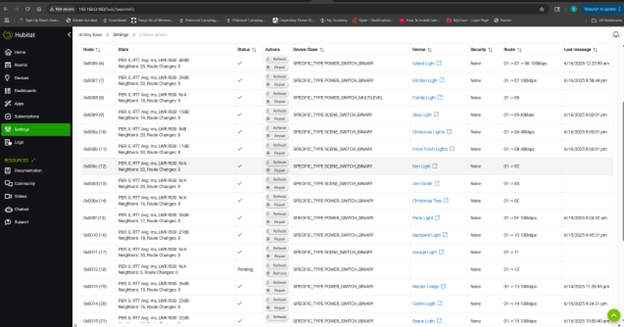

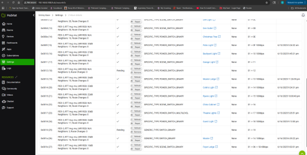

I have never had any issues pairing Leviton switches and dimmers in the past. But this one is giving me trouble. Hubitat C8 Hub. I go through the pairing process but it never pops up the window to have me name it. it hangs on the zwave initializing. I can see the switch in my zwave device details. All the posts i have read say that this means it did not associate the proper driver. I have tried discover, refresh, and repair and no luck. I even purchased a zooz 800 usb stick. I followed the removing ghost document but I can't get the stick to pair with the C8. I even tried to pair some leviton zw6hd dimmer switches and same result as the zw15s. firmware is current on the C8. It's like all of a sudden this hub won't pair to anything. It just keeps making ghosts.

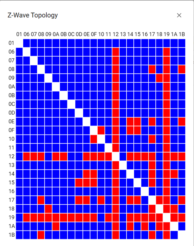

This happens sometimes when you get too many dead/ghost nodes to begin with.
How To Remove Ghosts using hub tools or a UZB Stick << See section 3 there, it was recently updated to include instructions on how to switch your hub to ZWJS gateway temporarily to remove ghost nodes.

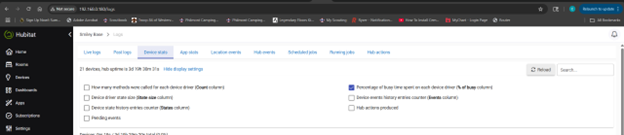

Hub is being powered with the supplied power supply. Network connection to wall jack. Wall jack is connected to 48port switch. Uptime 3d 19h 40m 12s

The z-wave details screenshots are like compressed thumbnails, cannot click on them blow and read them. I do however see what looks like 3 dead/ghost nodes. Its the 3 that say "Pending" next to them, there is no device attached.
