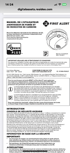

I’m on a mission to figure out whether the 1044817 Wireless Smoke & Carbon Monoxide Alarm (ZCOMBOA) plays nicely with Jeff’s Z-Wave driver. The catch? Nowhere does it clearly state if it’s using Z-Wave Plus, and I’d rather not roll the dice on this one.
I can grab it from a local hardware chain (Lowe’s-owned) or Amazon, but neither they nor First Alert seem keen on sharing this crucial detail. If anyone can confirm whether this model works with Jeff’s driver, please let me know—I’d really appreciate it!
Thanks in advance!
It’s in the product manual
Merci @Ken_Fraleigh!
Any current model detector should work with this driver or the system one. It is a standard notification type that I am picking up.
