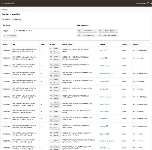

Can you pleas post your z-wave details screen in it's entirety? (use windows snip). Are you using a POE splitter?
Thanks. I am not using PoE; I'm using the USB power supply provided with the hub.

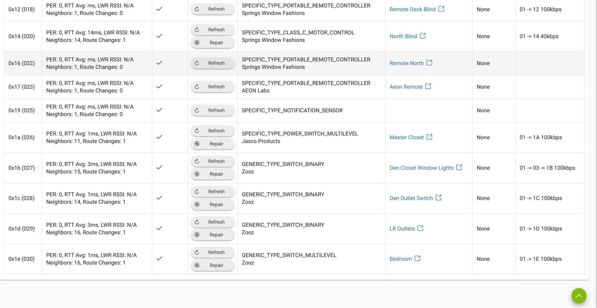

Did you try removing that ghost node after migration? Node 0X19
It should be removable with a Refresh > Remove.
I have not known where one single ghost would break the entire z-wave network though, but who knows.
Thanks. Power is via the USB hub that came with the C8 Pro. I can try a more powerful one if that might be the issue.

You have 3 ghosts.... Those need to go. Likely they're preventing you from adding a new device.
That doesn't work. Refresh on 0x19 gives "[warn]Z-Wave Network responded with Busy message." in the logs, every time, but no on-screen messages. Refresh just comes back, no "Remove" button.
I would believe that device is the issue, but Hubitat can't seem to kill it.

What are the other ghosts? The remote controllers above it are tiny little blinds-controllers; they work on the C5.

I only see one for sure ghost. The others are attached to devices, only have one neighbor and no route, so they sort of look like a ghost but are possibly just offline. If they are offline it might help to power them up. If they are already online, sometimes devices will never pick up neighbors and still work just fine, just might be oddball devices.
If you have a USB Z-wave stick and a windows PC, you could use that to remove it from the C5 first, then do a new migration. How To: Remove Ghosts using hub tools or a UZB Stick
No UZB Stick. Those are coin-cell powered, so they don't really communicate much.
