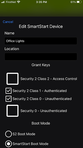

I did, but now I'm wondering if I didn't save the selection....I think this may have been a limitation of my older phone....smaller screen and couldn't scroll down....is there a "save" button at the bottom I couldn't access?
exactly....manually entered it.
I guess going forward, I could do the phone camera method to do the easy QR code scan, adn then on the laptop edit the boot mode that way all before powering up the device.
Or I could use my iPad with a larger screen so I could access the assumed "save" button I coudn't see.

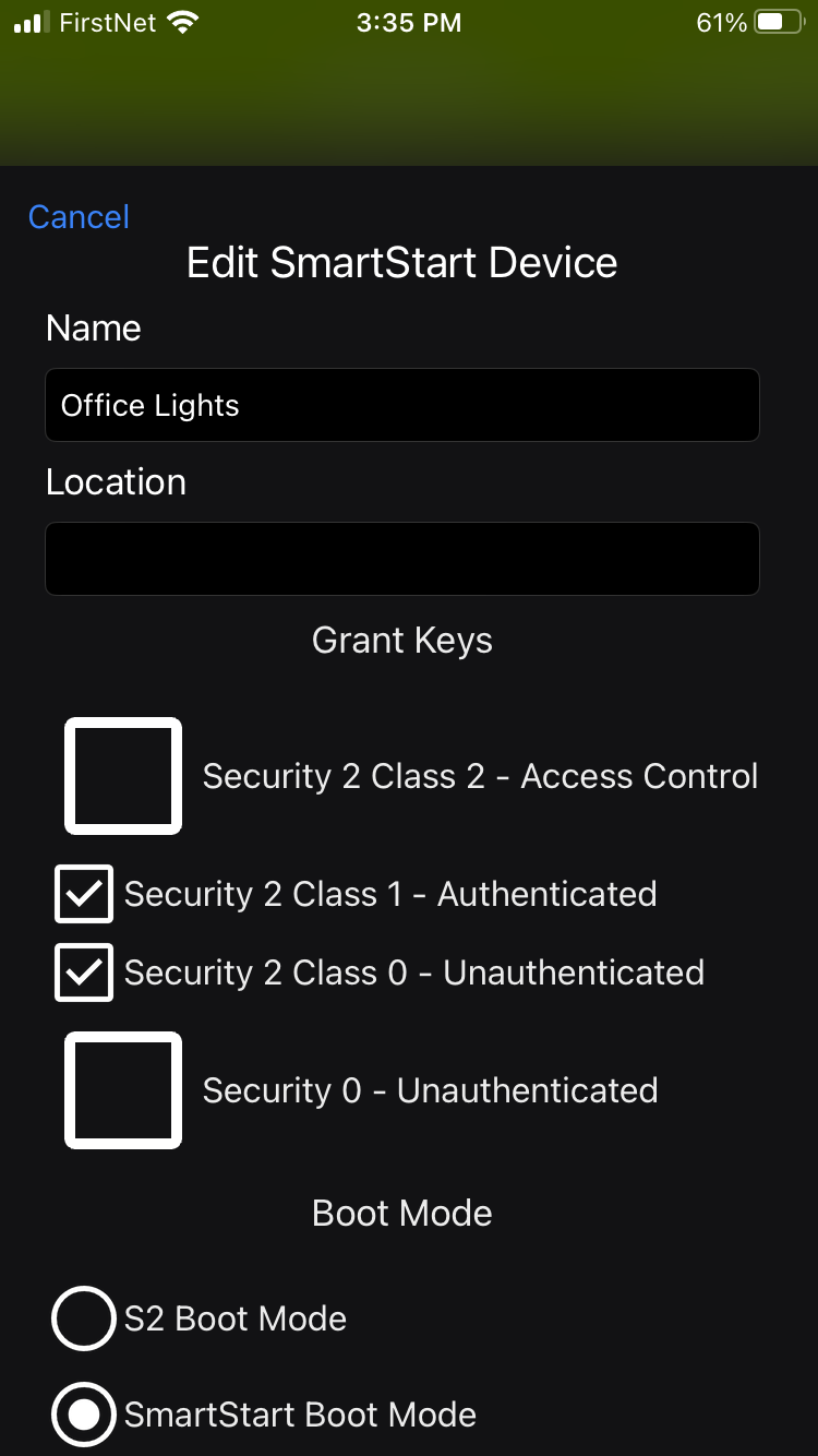

This is as far down the screen I’m able to see. I can’t scroll down either.
Yes there is a save button at the bottom that I guess you cannot see or access.
I would scan the QR code in, and then make edits with this app. The mobile app originally had all sorts of issues making edits, not sure if all that was fixed or not. I trust my app more. I only use the mobile app to scan the QR code.
