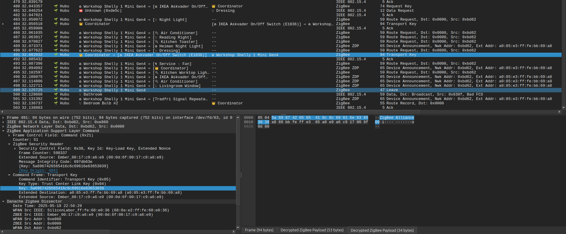

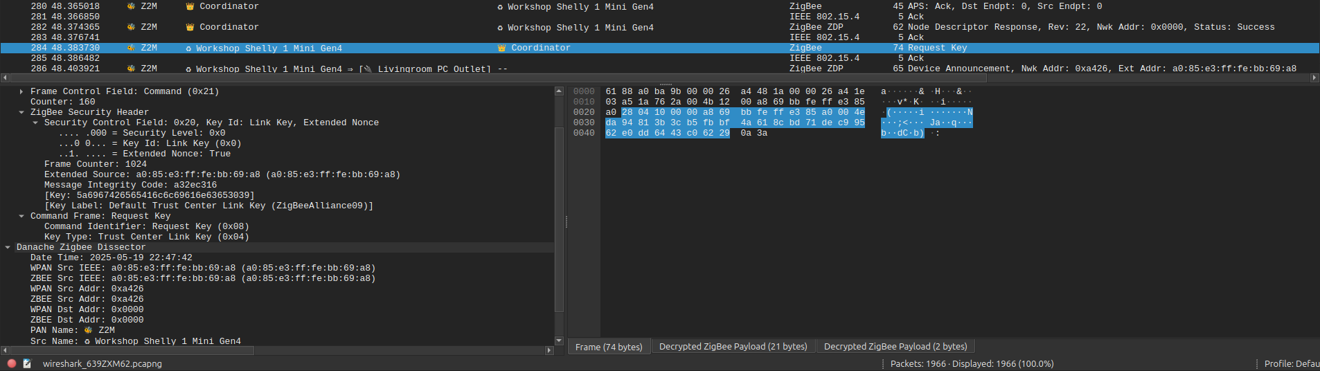

Looks like Shelly is asking ("Request Key") the coordinator for the Trust Center Link Key:
Z2MQTT responds (Transport Key) with a random key (not the Network Key), and Shelly continues with "Verify Key", etc...:

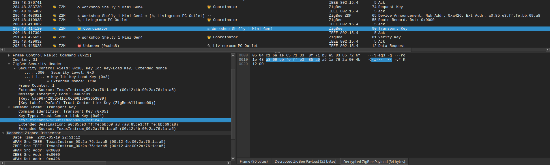

Whereas Hubitat responds with the Default Trust Center Link Key (ZigBeeAlliance09):
And shortly thereafter Shelly leaves the network, probably because it does not like being served the ZigBeeAlliance09 key encrypted using thee same ZigBeeAlliance09 key (see Zigbee Security Header).

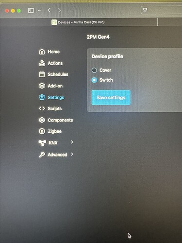

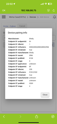

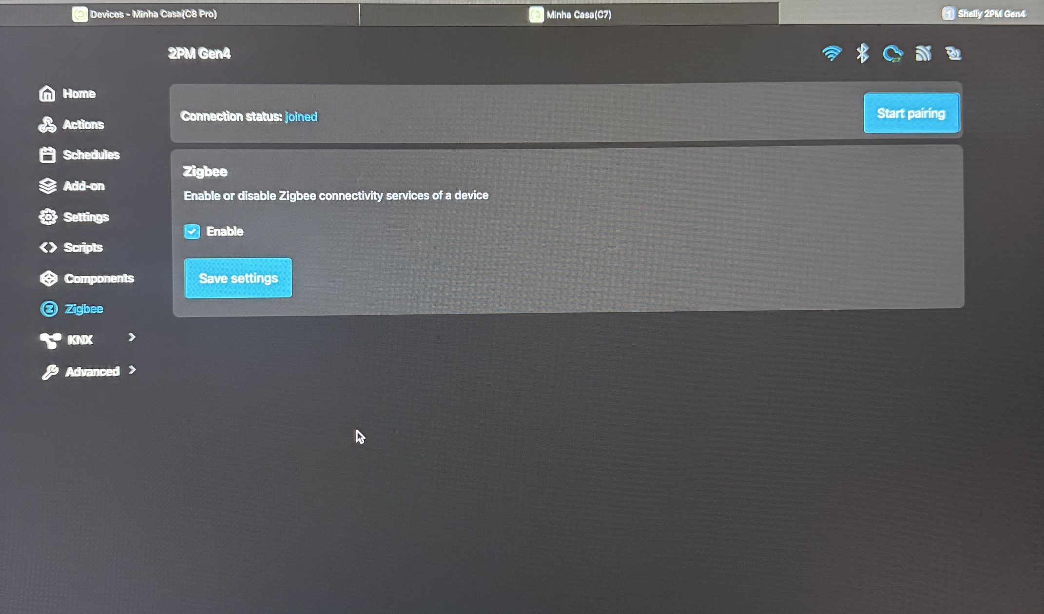

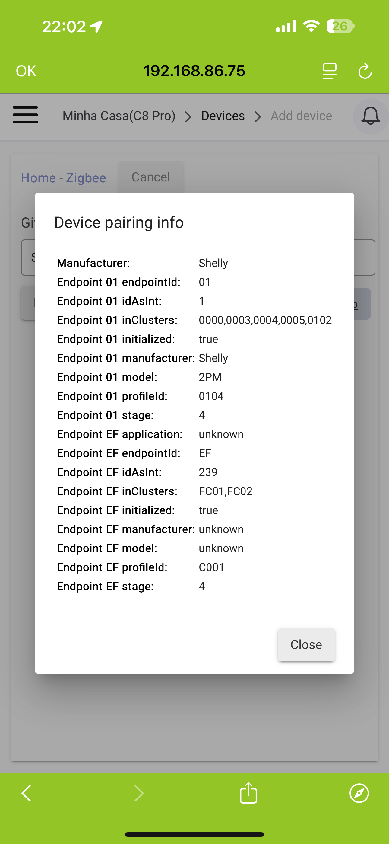

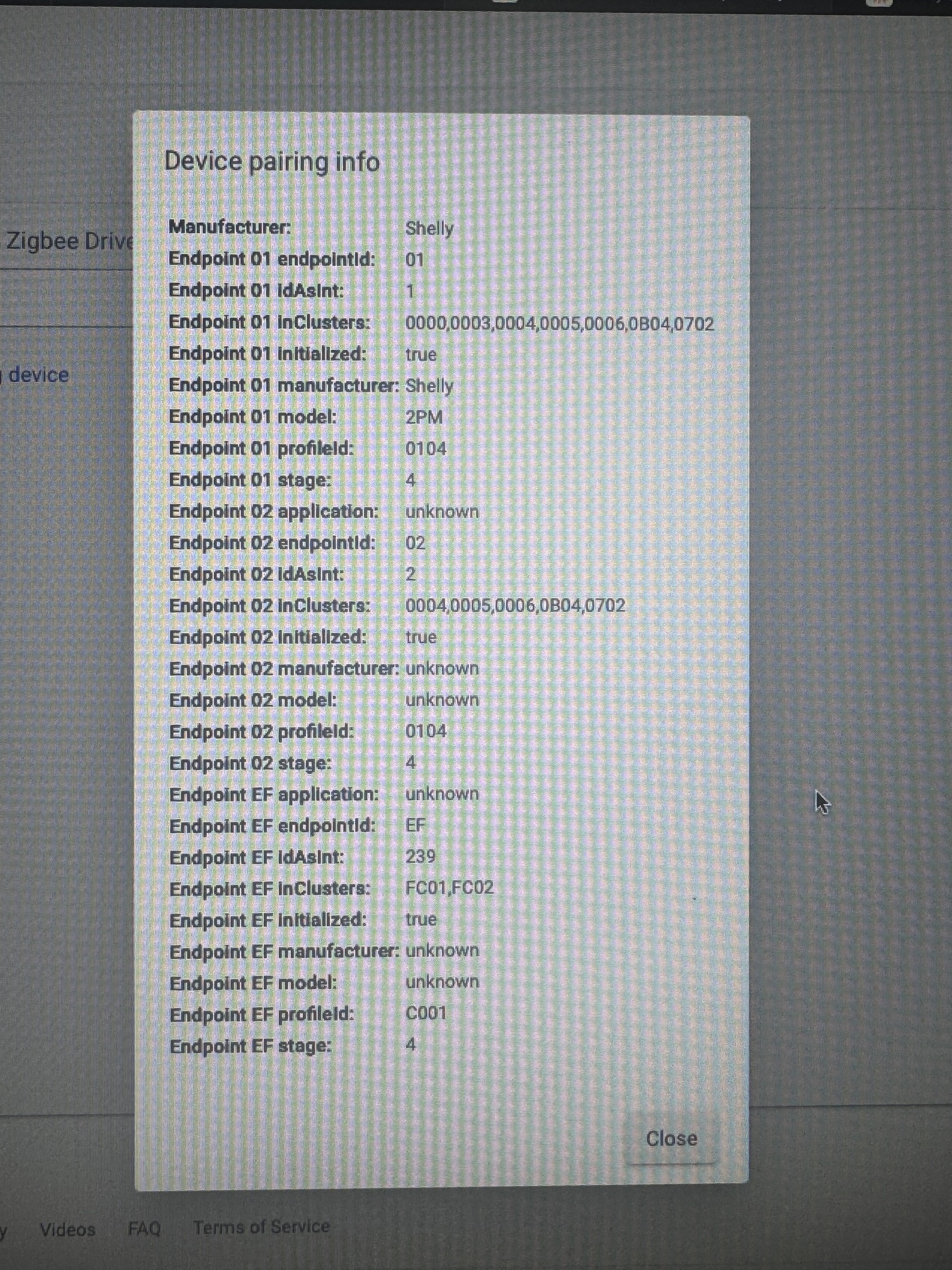

I'm testing a Zigbee driver for Shelly 2PM Gen 4 made with Claude AI. It’s in test (beta). There are some codes for tests that will be removed later. The device has two modes of operation (curtain/cover/motor and switch) and depending on the mode it is paired it has different clusters. The default is curtain, Hubitat recognizes it as a curtain controller and configures it with a native driver. To pair as a switch I needed to change in the web interface from curtain(cover) to switch and put it in pairing mode there, in the zigbee section, because I was not able to activate pairing mode using the button without resetting. But it ended up working.
Curtain mode
Switch mode
These are the steps I followed to get the device working:
1 – Pair the device using “Double Luck Voodoo” (the device will be recognized as curtain)
2 – Pair the device in the Shelly app and check the IP address assigned to it
3 – Change the operating mode of the device from curtain (cover) to switch in the Settings/Device Profile option in the web interface
4 – Repair the device. Enable pairing in the Zigbee option of the web interface. Start pairing by clicking the Start Pairing button of the web interface.

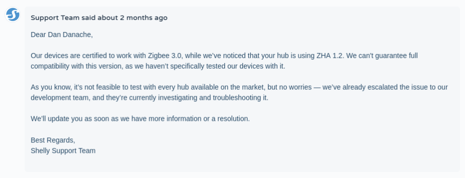

This was the reply I received for my C-7:
Well,
I made a ticket, they asked for teh device log, both with the stable and beta software, and made me try an RPC command, but Shelly.ZigbeeClaer,
all of which got me nowhere.
Shelly support is quite confident that the problem is in the C7 hub. So I mailed them that my C7 works fine with zigbee devices from 5+ different brands, and that I was postponing the issue till later. (hoping either Shelly or the Hubitat community comes up with something)
And got this reply :

  • Hubitat seems to have lost interest in the Zigbee ecosystem: install codes, green power, pairing issue with IKEA battery devices, etc. Also, if you complain a Zigbee 3 device does not work with C-7 (e.g. Shelly Gen4 devices), you'll probably get back a response along the lines of "Zigbee 3 devices should be backwards-compatible with ZHA 1.2, so it's the device fault".
  • Shelly has no reason to invest time and money in supporting a ZHA 1.2 device; I wouldn't if I were them :slight_smile:
