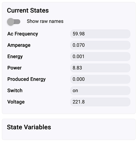

This zigbee driver for the Shelly 1PM Gen 4 Switch was created with the help of AI (Manus AI). Small corrections were needed and some improvements were made by @kkossev (thanks). The device pairing was done in the C8-PRO using the "Double Luck Voodoo”. The driver is being tested.
The driver can be installed from

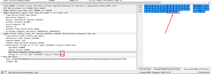

Unfortunately, at the moment, implementing the RPC protocol (encapsulated in Shelly endpointId 0xEF, custom cluster 0xFC01, non-standard Zigbee Profile 0xC001) is not possible on Hubitat.

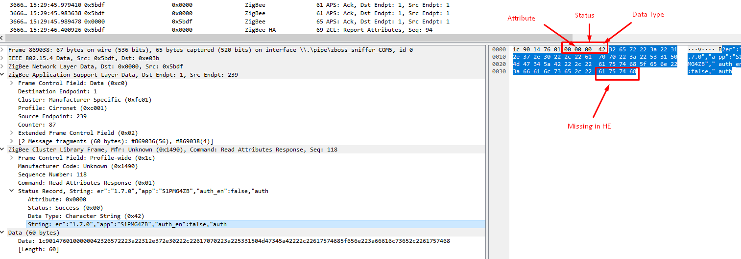

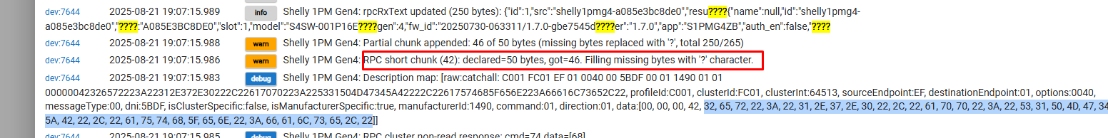

There is a HE platform bug, where Data Type: Character String (0x42) is truncated before being parsed into DescMap - the last 4 bytes are 'eaten' somewhere :
On Hubitat :
Giving up ... :frowning:
Actually, it may be not very difficult to fix in HE platfor: there is a 4 positions displacement :

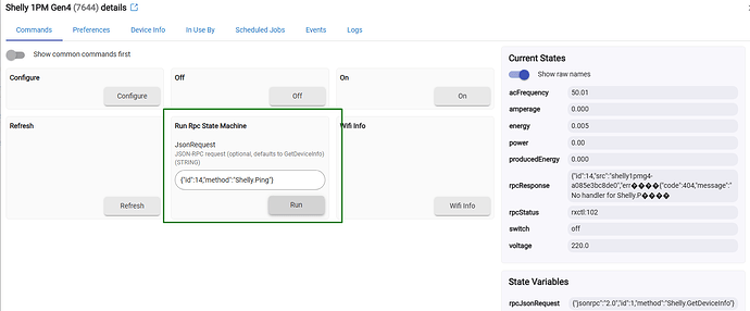

As I have already spent a lot of time working on the Shelly RPC via Zigbee implementation, and as it is partially working (despite of the HE decoding bug), I have published the new version on GitHub - same repository as in the first post :
https://raw.githubusercontent.com/joaomf/hubitat/refs/heads/master/Shelly%201PM%20Gen%204%20Zigbee%20Driver.groovy
  • version 1.2.0 2025-08-21 kkossev - Shelly RPC cluster tests (Hubitat platform have a bug preventing the RPC cluster from working correctly)
  • version 1.2.1 2025-08-22 kkossev - added wifiInfo; added runRpcStateMachine()
The interesting new experimental command is "Run Rpc State Machine" :
It expects a valid JSON object, containing a valid Shelly RPC command.

The bad news are that the most wanted functionality - detached relay mode is not working for now.
