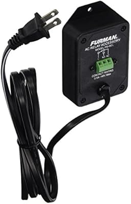

Here is something that would work with the Peanut without hacking it! A little pricey but these things are hard to find.
You probably have an old 12v wall-wart laying around for free that you could use. Also, a little secret, it doesn't have to be 12v. Most automotive relays will trigger at 9-10v. You're not trying to hold it open for hours, just long enough to trip the button. I would NOT pay $45 for a relay. Might as well buy a mimo lite or a z-wave garage door opener for that kind of money.
yeah my whole cart with the other stuff comes out to around $40 and it's everything I need.
