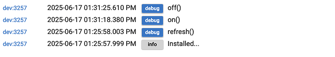

This is how a sensor looked before in the logs:
Note that whenever the contact switch was triggered how the logs looked.
Today, as soon as I changed the parameter to only report (parameter 12 = 0), immediately the child input sensor device was created. As soon as the relay was physically changed the Current State variable "switch" appeared and in the logs:
