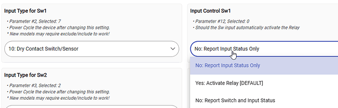

EDIT: I have the switch set to Input Control: No, Report Switch and Input Status. Also, there is another anomaly I've noticed and that is that the main driver status always says "1 Pending Changes" when the input switch is set this way. If I go back to value 2 (default) the pending changes goes away.

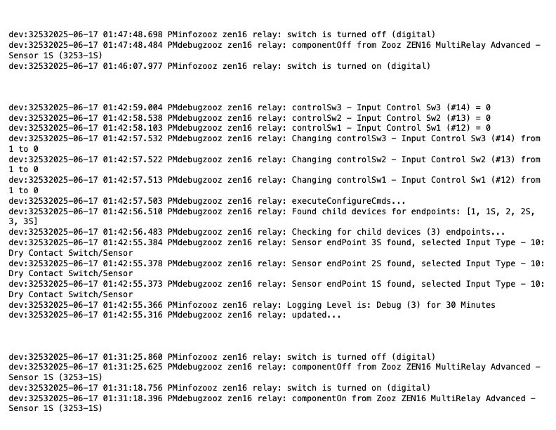

I am getting logs that read when the individual switch changes:
info
zooz zen16 relay: switch is turned off (physical)
zooz zen16 relay: switch is turned on (physical)
Just nothing I can compare to in the rule logic

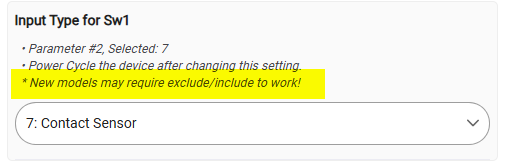

You have one of the newer models, I think it is 800LR. You have to change the input settings to how you want then exclude and include the device. When you exclude it will delete the device from your devices list and break any rules. Sorry nothing I can do about it, this is due to newer Z-wave spec and Zooz following it to the T.
  • I will take a look at the settings not updating (with the pending note), I might have something messed up in my configuration.

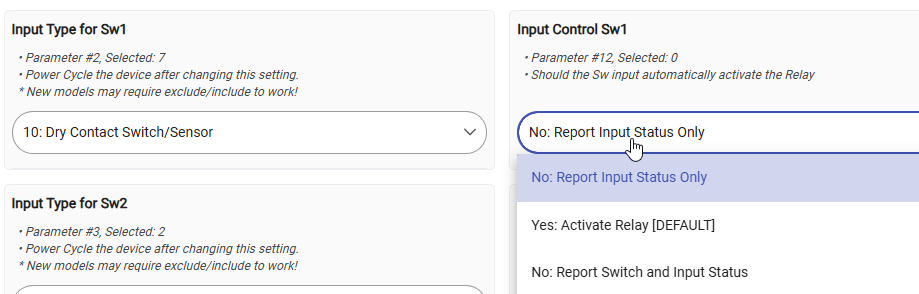

  1. I added the Zwave device. It automatically assigned your driver to the parent device now.
  2. I change S1 and S2 to be Dry Contact
  3. The relay switch indicator blinks while the driver says "Syncing..."
  4. Then it goes to Synced, blue light stays on.

If I go to the child device (type Generic Switch Component) under Current States, there is nothing displayed. Normally for a switch I will see "Switch" and either on or off.
So when I go create a quick rule to test the switch status so I can turn on/off the appropriate relay, there the Switch status is always null (event though I can trigger based on changed), its like the child device doesn't have a property for switch status.
Am I doing something wrong?

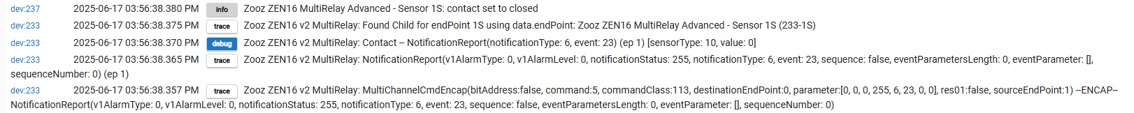

Turn on TRACE logging on the main parent device, then try triggering one of the sensors, you should get some logs. Post a screenshot of the logs.

Logs do show a state change when I move the float switch(es), but as I can see there is no "switch" variable for the child sensor device created or maintained when the physical switch (or when I use the On/Off options on the child device).
I will capture a log after I set things back up to where I think they should be and exclude/include the switch.

Edited the default settings...
#2: 10 Dry Contact Switch/Sensor
#3: 10 Dry Contact Switch/Sensor
#4: 10 Dry Contact Switch/Sensor
Save

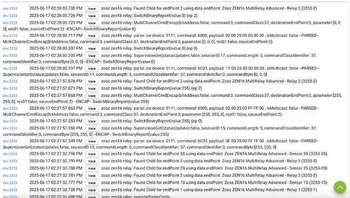

The device is back, with 3 relay and 3 input child devices. Logs from the device creation:

If I try to capture the state of the input sensor, the logs will show changes to the Relay, but not the Switch. The logs will show that the relay is on/off:
Summary
dev:32532025-06-17 01:42:59.004 PMdebugzooz zen16 relay: controlSw3 - Input Control Sw3 (#14) = 0
dev:32532025-06-17 01:42:58.538 PMdebugzooz zen16 relay: controlSw2 - Input Control Sw2 (#13) = 0
dev:32532025-06-17 01:42:58.103 PMdebugzooz zen16 relay: controlSw1 - Input Control Sw1 (#12) = 0
dev:32532025-06-17 01:42:57.532 PMdebugzooz zen16 relay: Changing controlSw3 - Input Control Sw3 (#14) from 1 to 0
dev:32532025-06-17 01:42:57.522 PMdebugzooz zen16 relay: Changing controlSw2 - Input Control Sw2 (#13) from 1 to 0
dev:32532025-06-17 01:42:57.513 PMdebugzooz zen16 relay: Changing controlSw1 - Input Control Sw1 (#12) from 1 to 0
dev:32532025-06-17 01:42:57.503 PMdebugzooz zen16 relay: executeConfigureCmds...
dev:32532025-06-17 01:42:56.510 PMdebugzooz zen16 relay: Found child devices for endpoints: [1, 1S, 2, 2S, 3, 3S]
dev:32532025-06-17 01:42:56.483 PMdebugzooz zen16 relay: Checking for child devices (3) endpoints...
dev:32532025-06-17 01:42:55.384 PMdebugzooz zen16 relay: Sensor endPoint 3S found, selected Input Type - 10: Dry Contact Switch/Sensor
dev:32532025-06-17 01:42:55.378 PMdebugzooz zen16 relay: Sensor endPoint 2S found, selected Input Type - 10: Dry Contact Switch/Sensor
dev:32532025-06-17 01:42:55.373 PMdebugzooz zen16 relay: Sensor endPoint 1S found, selected Input Type - 10: Dry Contact Switch/Sensor
dev:32532025-06-17 01:42:55.366 PMinfozooz zen16 relay: Logging Level is: Debug (3) for 30 Minutes
dev:32532025-06-17 01:42:55.316 PMdebugzooz zen16 relay: updated...
So I edit the parent relay and change parameters #12, 13, and 14 to "No: Report Input Status Only" (I can't use the 3rd option or we get stuck in Pending changes)
The device interface shows "Syncing/Synced".
The logs show that the updates were made...
dev:32532025-06-17 01:47:48.698 PMinfozooz zen16 relay: switch is turned off (digital)
dev:32532025-06-17 01:47:48.484 PMdebugzooz zen16 relay: componentOff from Zooz ZEN16 MultiRelay Advanced - Sensor 1S (3253-1S)
dev:32532025-06-17 01:46:07.977 PMinfozooz zen16 relay: switch is turned on (digital)
To me, the child input sensor device doesn't have a property for switch status, or if it does, its not being set after the child device is created, which is why I thought I am doing something wrong. My logic is that I don't want the input condition to change the relay, I want a rule to do that because I have two sensors that will determine what action to take with the relays.

Also, BTW, you will want your settings like this:
The bottom option for the input control was removed on the 800LR model but I missed hiding that in the driver so if you select that it doesn't save and will be stuck pending.
All I need is for you do exactly as I said above. This is the only logs I need to see, and I don't see any trace logging yet.

Sorry, I didn't know there was a specific Trace level debug, I have attached the log here.
Yes I had power cycled the Zen16 after excluding, then again after including.
Here I enabled trace and then went to the S1 switch itself to turn it on and back off.
I have it set up as you note, No/Report input status only.

I only have a v2 device to test with, and mine is set to option 7 contact sensor.
What we want to see is a NotificationReport message like this:
There was a bug in the ZEN17 where for ONLY the option 10 (the one you are using) it did not send the correct messages over. I did account for it in my driver but it looks like maybe the ZEN16 is not sending ANY messages over. Anyway.... try switching it to option 7: Contact Sensor. Then of course you have to exclude and include again.

I think you are doing it correctly, let me know if switching to contact sensor gets the status updates correctly.

I am pretty sure if you just switch the setting to contact sensor and pair again it will work as intended. Or are you saying you already tried that? Your reply above was not very clear?

No, it didn't work, I got the device added back in with the option as a contact switch. The child devices were created and with a state of "Closed" but changes to the input switch weren't reflected in the device.
I would open a case with Zooz or post on their community. I don't have a v3 device to confirm how it works exactly. I thought it should be the same as the V2 I have here. They use my drivers for testing often, so they can hook a V3 up to Hubitat with my driver and see if they can figure it out.
The behavior you are getting is what the ZEN17 800LR does if its NOT excluded and paired again, but since you are doing that, not sure what's going on.
