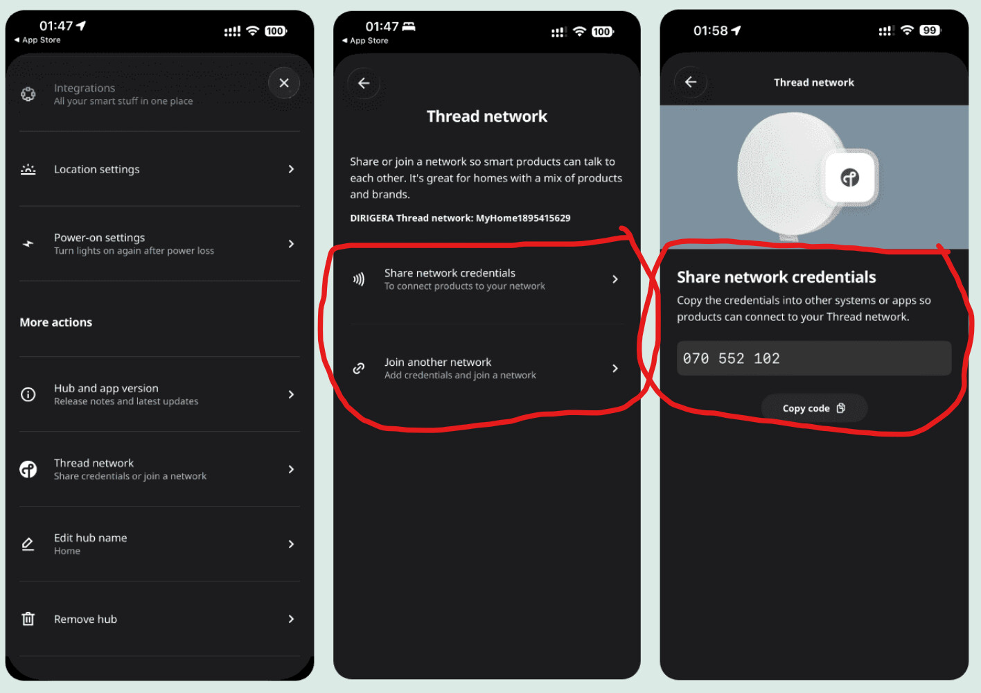

Yeah, looks like one device that I'm pretty sure actually did update the 1.4 is the [IKEA Dirigera hub.](Ikea wants to unify your home Thread network | Matter Alpha Ikea wants to unify your home Thread network | Matter Alpha)
Ahhh!!! So it looks like maybe in v1.4 we actually can have user involvement in sharing credentials between systems!
Good stuff, and nice job bringing this topic back on the subject of IKEA devices! :wink:
