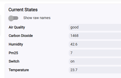

Next driver by ChatGPT : "IKEA ALPSTUGA Matter" :
 * IKEA ALPSTUGA Matter Air Quality Monitor
 * https://community.hubitat.com/t/what-do-i-need-at-ikea/158182/72?u=kkossev
 * Last edited: 2026/05/16 11:40 PM
