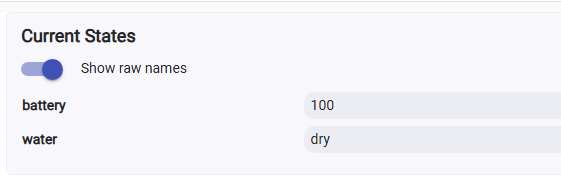

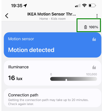

Thanks for the feedback. I pair all my Matter devices via Google Home, and the battery level of the Myggspray motion sensor is also displayed there. The batteries are supposed to last 15 months; by then, Hubitat will surely have a driver that shows the battery status... :wink:
Hmm… it’s still a bit of a mystery how Google Home is showing the battery level in this case. Is it displayed as an exact percentage, or just a simple high/low (or OK/low) indicator?
It currently shows 100%.
Same 100% battery level reporting in SmartThings ... :thinking:

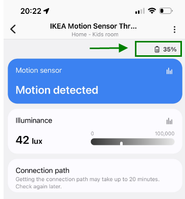

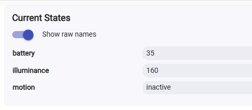

Update: I found a pair of nearly depleted batteries, and yes, ST shows the correct battery percentage.
:thinking: :thinking: :thinking:
Update2: I've found it! :slight_smile:
dev:78412025-12-23 20:36:43.902debugUnhandled Matter report: [endpoint:00, cluster:002F, attrId:000C, value:46, clusterInt:47, attrInt:12]
dev:78412025-12-23 20:36:43.901debugparse: read attr - endpoint: 00, cluster: 002F, attrId: 000C, value: 0446
The driver code is updated, now it reports the battery level too!
Congratulations on finding two batteries with 35% charge! It's almost like Christmas...:smile: Maybe someone from Hubitat will read this and update the seemingly incomplete Generic Matter Motion Sensor drivers. I really like your SmartThings interface; how did you pair your Hubitat with SmartThings so they're displayed like that?

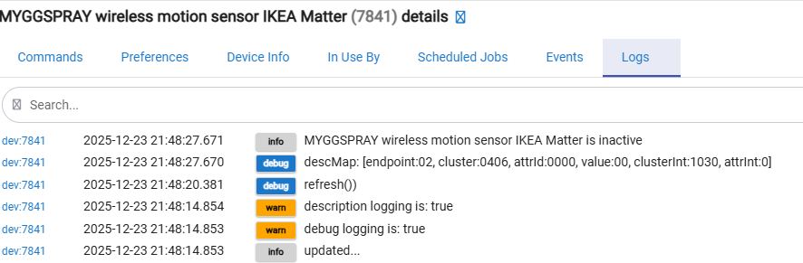

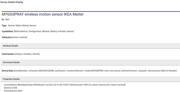

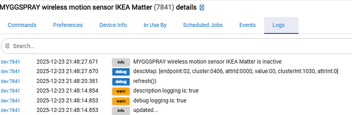

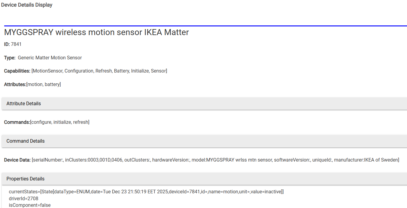

The Generic Matter Motion Sensor driver subscribes to battery percent on cluster 0x002F, attribute 0x000C. From the above log entry, it looks like that's what this device reports. If you aren't seeing anything and a report should have come in (it should on pairing, or a "Refresh" should fetch it ... assuming Thread devices are normally awake to listen for it), if you could enable debug logging and share that output here, that would be great!
Yes, the Generic Matter Motion Sensor has Battery capability, but for some reason it is not shown on Refresh ...
Device Details Display
The device responds to commands with up to 7 seconds delay.
Interesting...the refresh() command has, in part, this:
attributePaths.add(matter.attributePath(device.endpointId, 0x002F, 0x0C))
It looks like the endpoint might be 00 for battery instead of 02 or whatever endpointId is set to for you. I've seen this in a lot of Matter drivers. Probably need to re-think how this is handled "generically"... :thinking:
