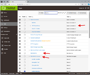

The Button controllers app seems to be updated.
I tried creating a new rule/controller and it's listed as ver. 5.1.
All my other controllers are ver. 3.1 - is that a problem?
The same goes for Rule Machine - it's also updated to 5.1.
I now have both a "Rule Machine Legacy" app (where all my rules are listed as Rule-4.0) and a new "Rule Machine" app.
Is there any way of updating the old controllers and rules to ver. 5.1 (besides deleting and re-creating them), so i end up with only having one instance of each app installed?
No, but:
Also no.
