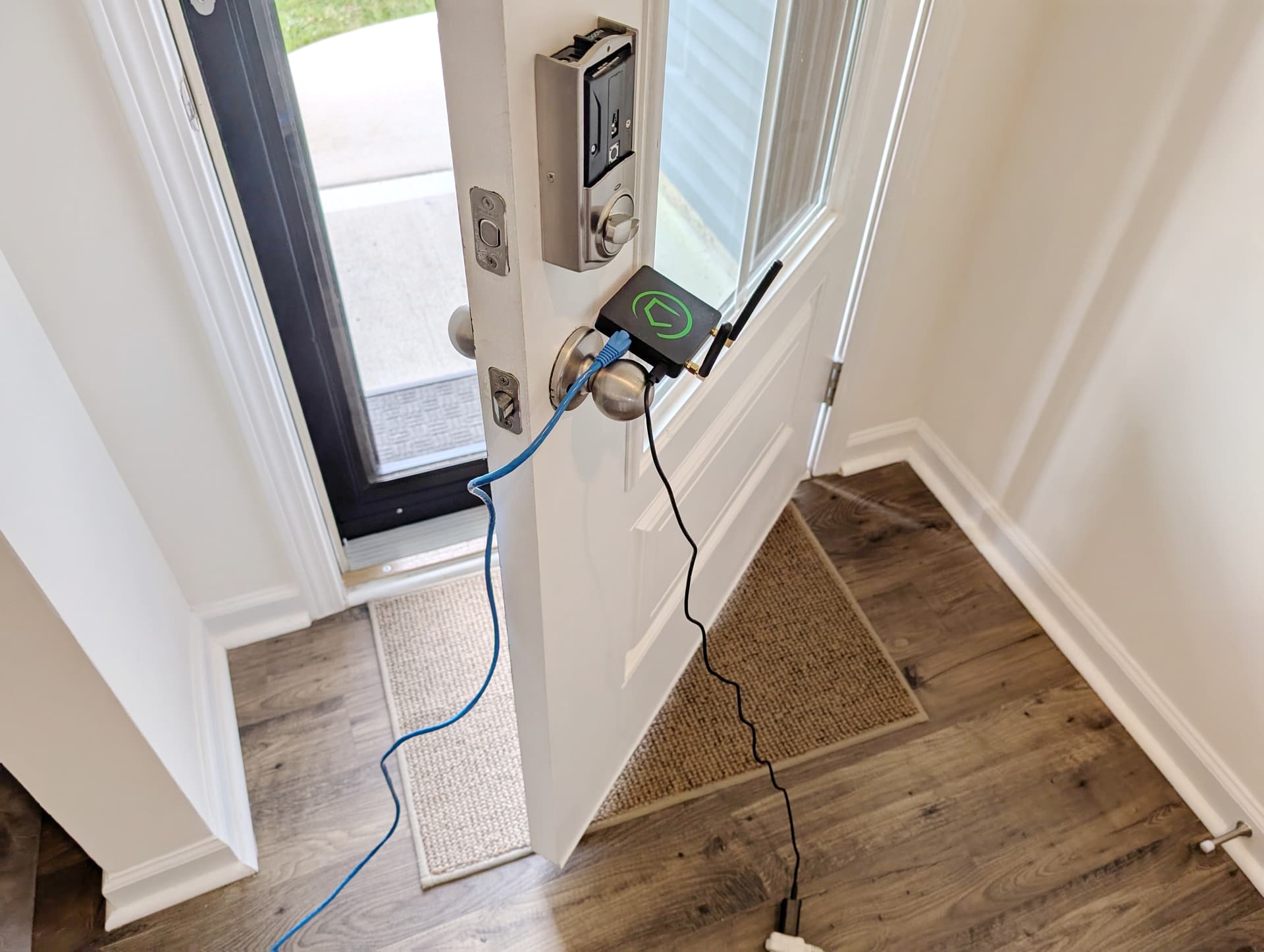

To I've tried including the lock by clicking the Add Device button, then "Z-Wave", then Start Z-Wave Inclusion. I also tried searching by brand and using a similar Kwickset lock. Then after starting the inclusion process I press the "A" button on the lock one time. All it does is beep once followed by a 10 second or so pause, then 3 beeps.
I have the hub right next to the lock as you can see in the photo. Not sure what I'm doing wrong. Any suggestions would be appreciated.
Make sure you can successfully exclude the lock using Hubitat before attempting to include it. It is possible that a factory reset doesn't cause this particular lock to leave it's current controller, in which case, inclusion would not work.

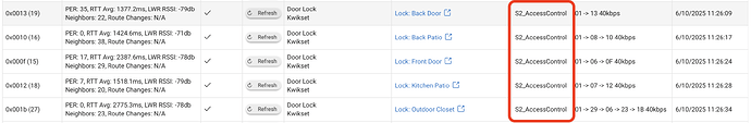

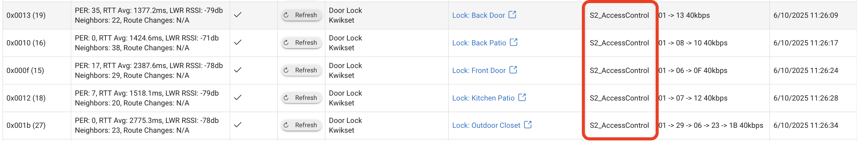

FWIW, I have five Kwikset z-wave locks that I'm using with Hubitat. These are newer locks, so they are paired with S2 security; however, Hubitat also supports pairing using the older S0 security.

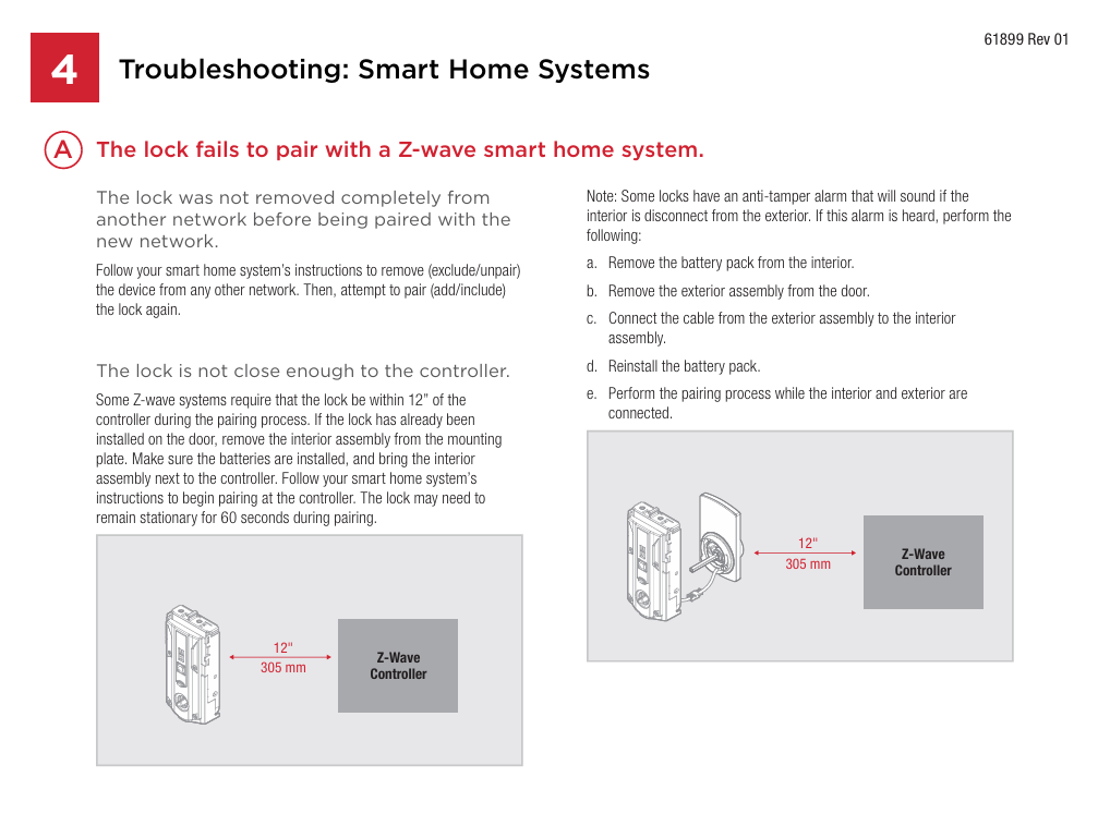

I do have two T6 thermostats paired, along with a smart light switch. I was looking at the Kwikset 888 trooubleshooting docs (attached). I am reasonably certain that the lock has been excluded from the former Safe Haven network. The reset went as described. I checked the Safe Haven log and there has been no activity for the lock in two days.
That should not be interpreted to mean that the lock is ready to pair with a new controller.

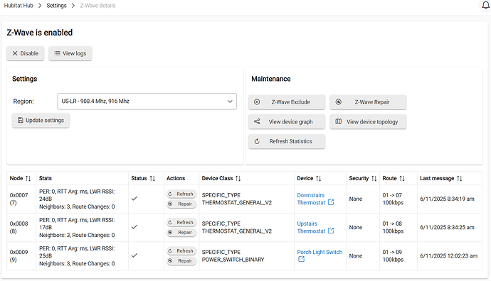

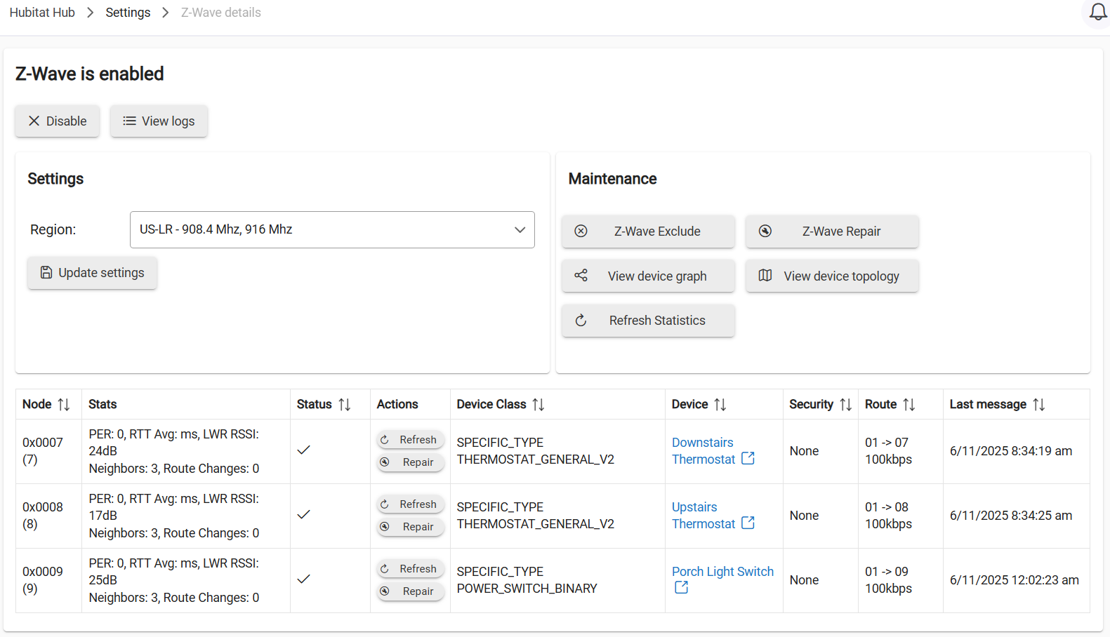

Here is my Z-Wave details page. The Hubitat uptime is > 16 hours.
-Thanks
Looks good.

Did you click refresh stats, wait then refresh the page first? The RTT are all blank.
Probably wont matter though, you only have 3 devices and no dead/ghost nodes so there should not be anything blocking you from pairing a new device.
I would focus on getting the lock to EXCLUDE from HE first. You should be able to run the exclude process and get "unknown device excluded" on the hub side when it works. If that wont work then there is close to 0 chance of getting an include to work.
