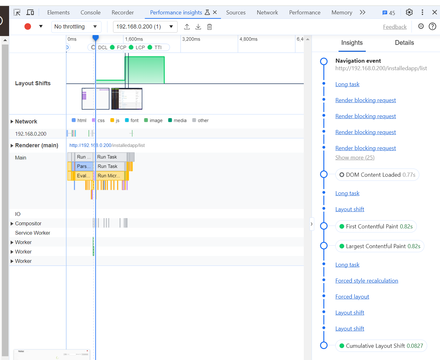

My rule list is pretty small by comparison and probably not helpful. If you are using Chrome you could look at the performance insights. That will tell you where the time is being spent.
