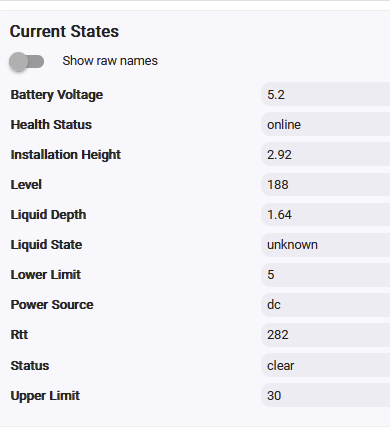

I transferred my 2 MoreyAlec (Tuya TS0601 based, _TZE284_kyyu8rbj is the source) ultrasonic sensors to a new hub (C8-Pro) located in my garage. Since then, both units have been reporting a Level of 188 -- which is an impossible value.
The logs just corroborate the Current States value of Level:
2025-07-17 04:10:30.333 PMinfo
Distance Sensor - Ultrasonic - Garage North level is 188 %
The installation Height is correct (ceiling to floor of my garage), and the Liquid Depth in this clip is correct (distance from ceiling to my car). Driver is "Tuya Zigbee Tank Level Monitor".
Any thoughts on how to resolve this anomaly?

Have you tried pairing the liquid level sensor again to your C-8 hub (without removing it)?
Is the Ping() command returning numeric round-trip-time values? Make sure the driver is the latest version, it was updated in April this year.
The Level percentage value is calculated and reported from the sensor itself, so the only reason for reporting a value over 100 that I can think of is if some of the configuration parameters were not accepted correctly.
After I posted, I re-paired my south unit 3 times in a row, and it now seems to be behaving -- RTT of 156, Level = 53% (which is correct for the distance from the ceiling to the south parked car).
I didn't re-pair the north unit, which was reporting RTT, but I did change the driver to Device and cleared everything, then changed back to the Tuya Zigbee Level Monitor. When I checked a couple of hours later, RTT was 256 and Level as 56% (which is correct for the distance from the ceiling to the north parked car).
The driver is ver. 3.4.0 from 2025-04-25.
So it seems (for now) to be resolved, and was likely an internal config problem as you noted.
Thank you for your comments and suggestions!
