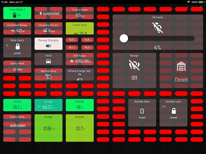

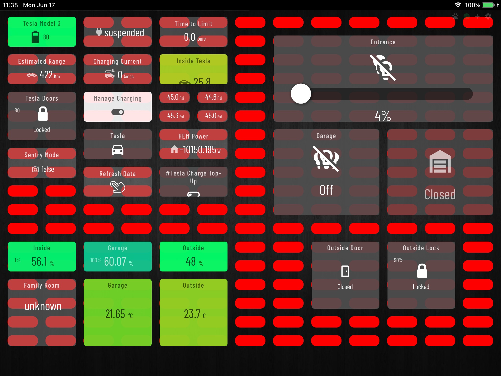

I had a weather dashboard that's been running fine the past few months with a black background and tiles with a 0.7 alpha, but about 2 days ago these red tiles which mark the single tiles started to show up behind my Dashboard tiles. Not sure if something changed on the Hubitat software side to do this, but it doesn't show up on other Dashboards. Anyone have a solution or idea if some kind of CSS is being ignored? Thanks!
I’ve got the same thing on one of mine. My wife was just asking me what’s going on with the dashboard… I didn’t even realized she ever looked at it or used it! lol
Are you using Smartly?
@gopher.ny, any chance this might be related to the latest dashboard update with .150?
Nope, no Smartly here, but this particular dashboard is being used on an old Fire tablet using Fully Kiosk Browser to display it via a local Dashboard link. I don't see the red tiles when I view it on my laptop's web browser or my Android phone though. Did we unlock a special KITT mode?
images
Lol. Maybe!
It looks like it's possibly related to the update using a new CSS (See post 5) 2.3.9.150 update caused issues with dashboard/s on iPad Air - #5 by user1025
I guess I'll see if I can get this old tablet to update so it is compatible. If that doesn't work, maybe I need to make one big dummy tile that is all black that the other tiles overlap.
lol
Yea, that seems to be the case. I just tried on a newer iPad and don’t have that issue with it.
Will try the big tile in the background - Hopefully, that will fix the issue.
RIP using cheap old tablets off Ebay as dashboard displays. :rofl:
I got it to work. It's truly the most kludgy way, but reminds me of the old days of "we can't get this error window to go away, let's just put a background color window over it so you don't see it anymore."
I uploaded a 1x1 black (or whatever bg color you want) pixel image file to the Hubitat through the file manager. Then I found the lowest numbered tile on that Dashboard and changed it to an Image tile using the 1x1 pixel as the Image. I moved that tile to position top left and then changed its size to match the whole dashboard.
Last thing was to make a new replacement tile duplicating the old function of the tile that was used to create the background. I attached a photo with the image tile 1 column smaller than the dashboard to show it successfully covering up all the other red blocks.
Latest update has fixed this issue, so now I can delete the big bg file that was covering up the red tiles. Thanks!
