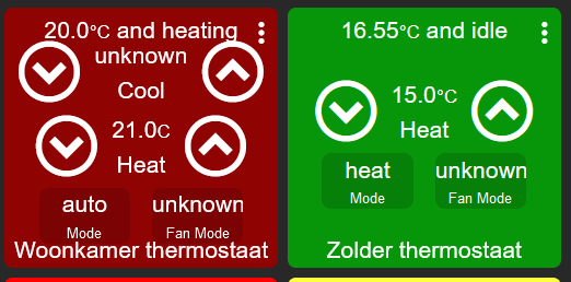

I am trying to do multiple lines of custom CSS on my dashboard specifically on the Thermostat template tiles. I need to hide multiple parts of it hidden and after a ton of weird stuff, I finally got it working (not sure how, bit it is working) .
Now I still have alignment issue (see picture)
afbeelding

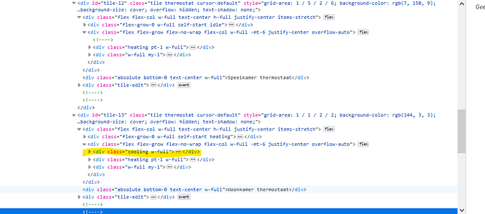

I have currently 6 tiles using the thermostat template and they all look like the red one... I want them all to look like the green one. After some digging in the CSS I found that the green tile has 1 more attribute.
Since they are both using the same template, how the heck did this happen and more importantly how do I fix this?

Yes, that is correct. The problem is not the color, but the alignment of the elements on the tile which is caused by the absence of an css attribute (see pic. 2 of my post).

Again for clarification, I have currently 6 thermostat tiles on this dashboard. They all look like the red one (please ignore the colour that is dependant on the state it is in Heating or Idle...) and have the temp heatpoint setting raised up from the centre. Only the green one does not have this and shows up how I want it.

Which is again showing 1 extra attribute on TileID 13. I checked the CSS of the other Thermostat tiles, and they all have the same structure are TileID 12.
I think I may have found something... The underlying thermostat devices diver... I have 4 running against a Eurotronic TRV, I have 1 running against a virtual advanced thermostat (just using temo readings from two Aeontec TriSensor') and I have one running from a Heat IT Z-Temp thermostat. This last one is associated with Tile 13. When looking at the driver code, I noticed that the driver DOES mention a cooling operating state, even though this is not visible on the device details screen. The drivers for the TRV's and the virtual Adv. thermostat, are the other way around. There are cooling settings visible on the tile of the device pages, but not in the list of the operating modes. This (to me) seems to indicate that the driver does not support cooling for those devices, the device type template automatically does office the tiles for cooling setpoints by default for all devices using the Thermostat type, and since the driver of my Heat IT Thermostat actually does offer that functionality, this is what triggers the confusion on the dashboard tiles. The CSS for those tile,might just be generated based on the technical capabilities according to the underlying device drivers.
Could this be the reason that my dashboard looks misaligned and there is an CSS attribute missing?
