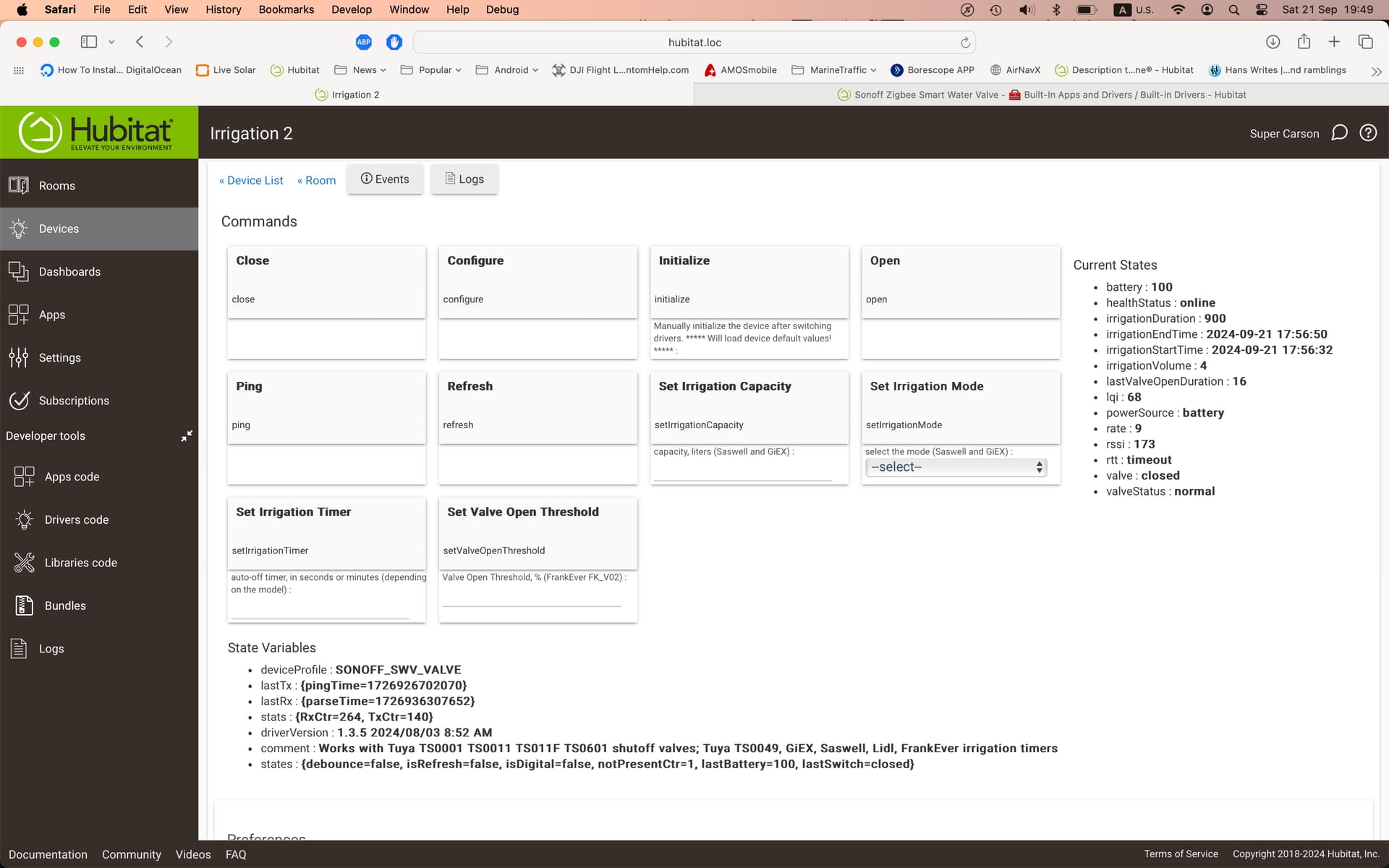

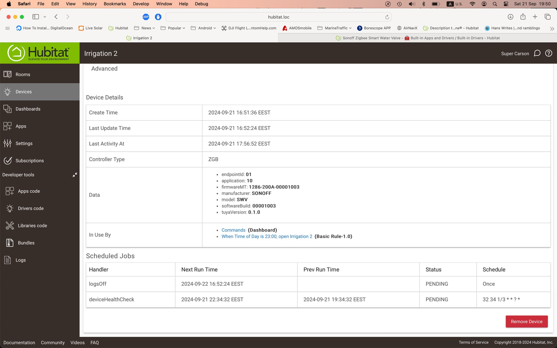

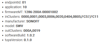

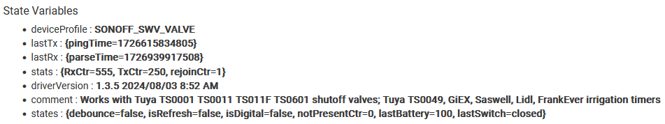

Can you post a screenshot of the State Variables and a screenshot of the Device Details - Data section?
Something is different, I can’t replicate the same problem in HE with my valve.
Just set up two Sonoff valves and am observing the situation in which the "valve" state remains closed. I just tried Refresh and it does update the valve to the open state.
Otherwise, this works a treat and I appreciate the effort. I can survive with this behavior but would certainly be interested in any easy fix.
State Variables:
Data:

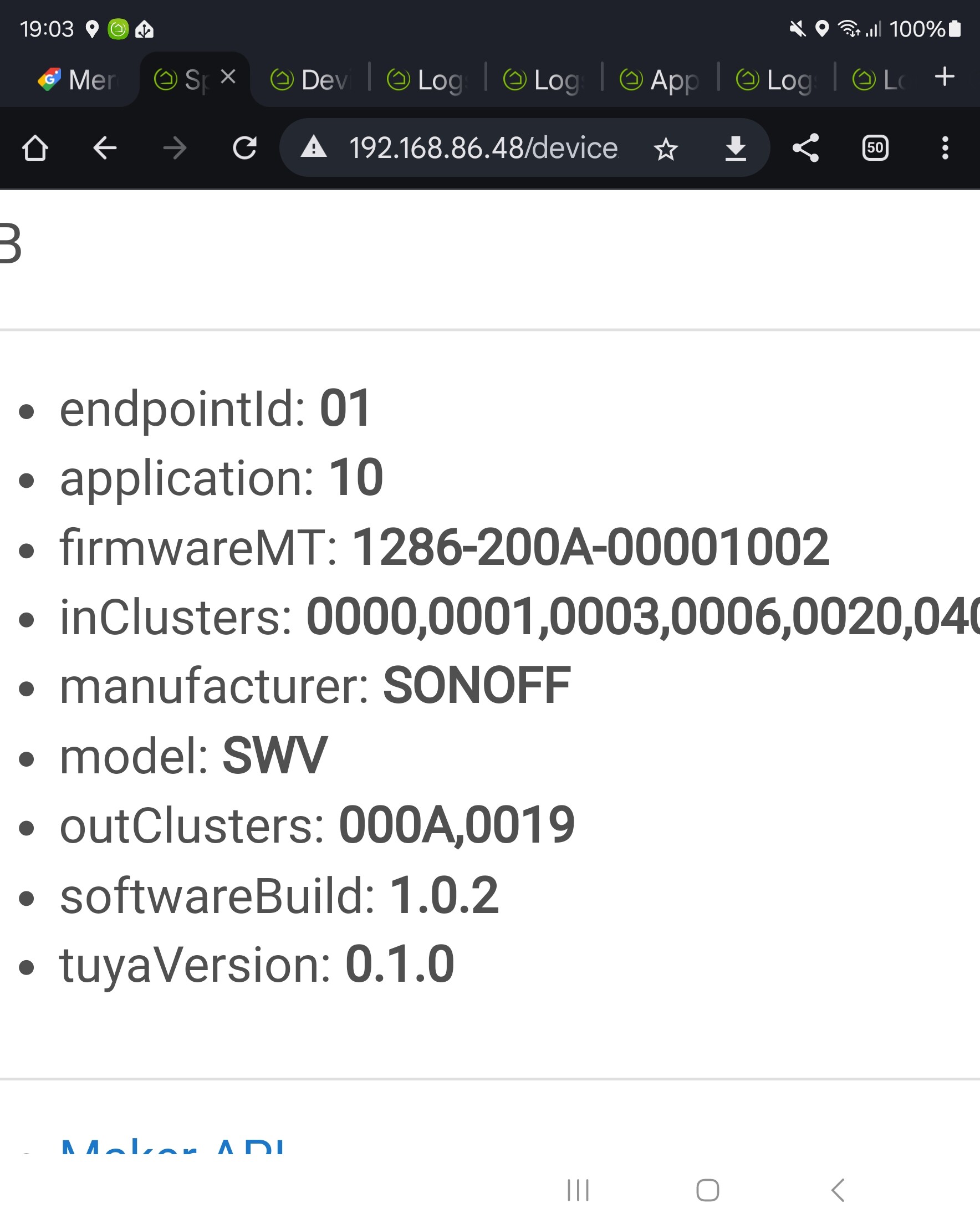

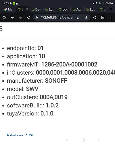

Yes it seems I have firmware 1.0.3
I'm in Europe, maybe that has something to do with it.
@hdebruin @Hatallica can you update the driver again, same version 1.3.5 timestamp is '2024/09/22 1:42 PM' ?
I can't replicate the problem with the valve attribute not being updated immediately to 'open', but I have made a small change that I hope will work.
If the change does not have any effect for your setup, next will be to schedule an automatic refresh - one second after the open() command is issued.
