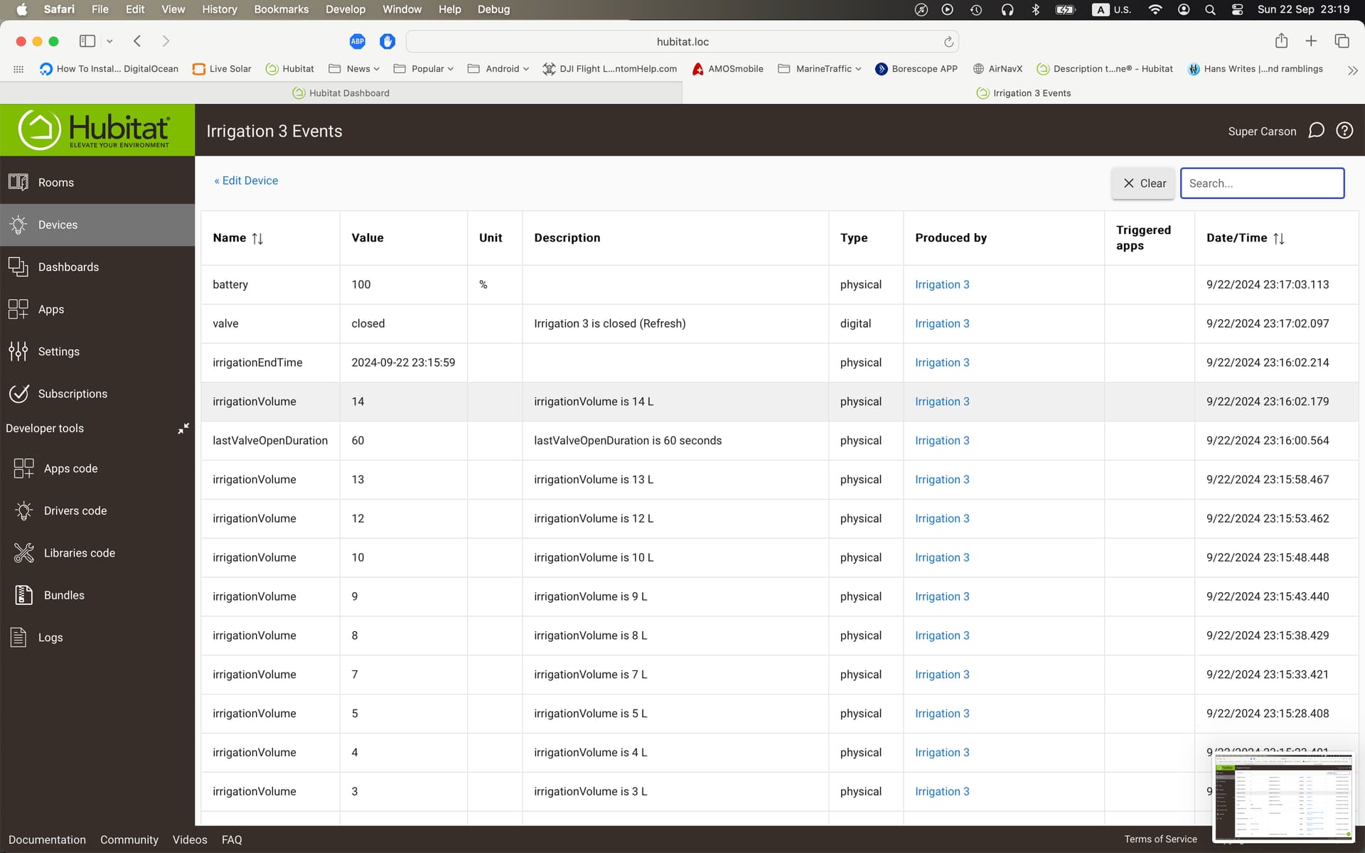

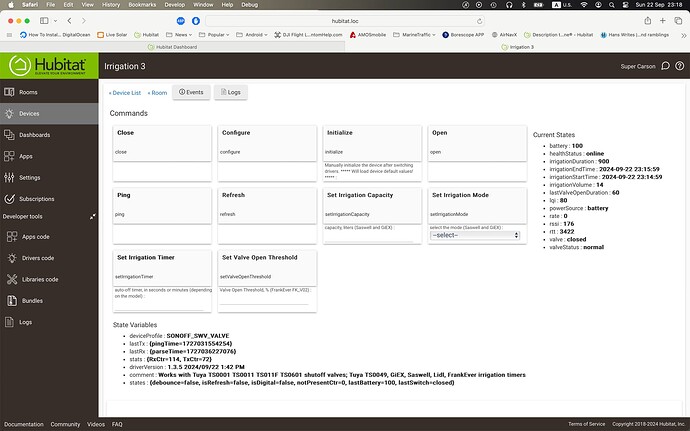

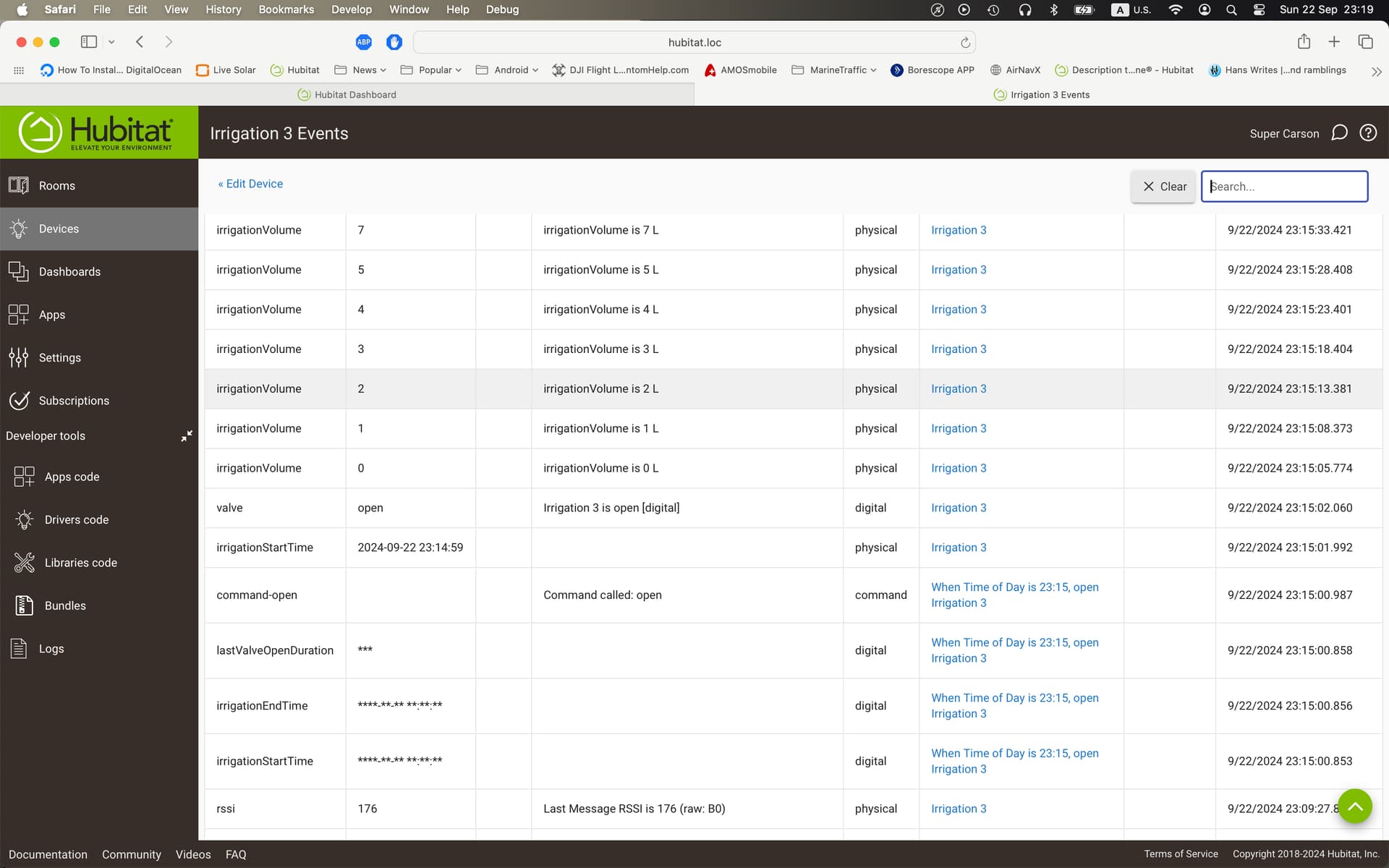

Hmmm. This is probably me doing something wrong. But I set up basic rule to open valve 15 minutes, then shut it down. I had set Irrigation Timer value to 900, which should cover the 15 minutes. I had done this for two valves that I installed. Both started properly at the assigned time, but closed after exactly one minute. Some screenshots attached from devices and events list. What is going wrong ?

This is the default value of the irrigation duration, if the 'autoOffTimer' (from the Preferences section) is not set...
Now I realize that the auto off function is always active, even if the timer is set to a big number like 9999.. I am going to add some logic to be able to disable the auto-off, so that the Sonoff valve can stay open until an explicit 'close' command is sent.

I reset autoofftimer in the code to 60. Updated the preferences to a higher number. For my info, what do I click to make it use the changed driver ? I click configure initialise refresh three times and that seems to do it. Wondering what the proper way is....
Testing now...
You don't need to click on Initialize of Configure buttons, the changes in the Preferences are accepted when you click on the 'Save Preferences' button.

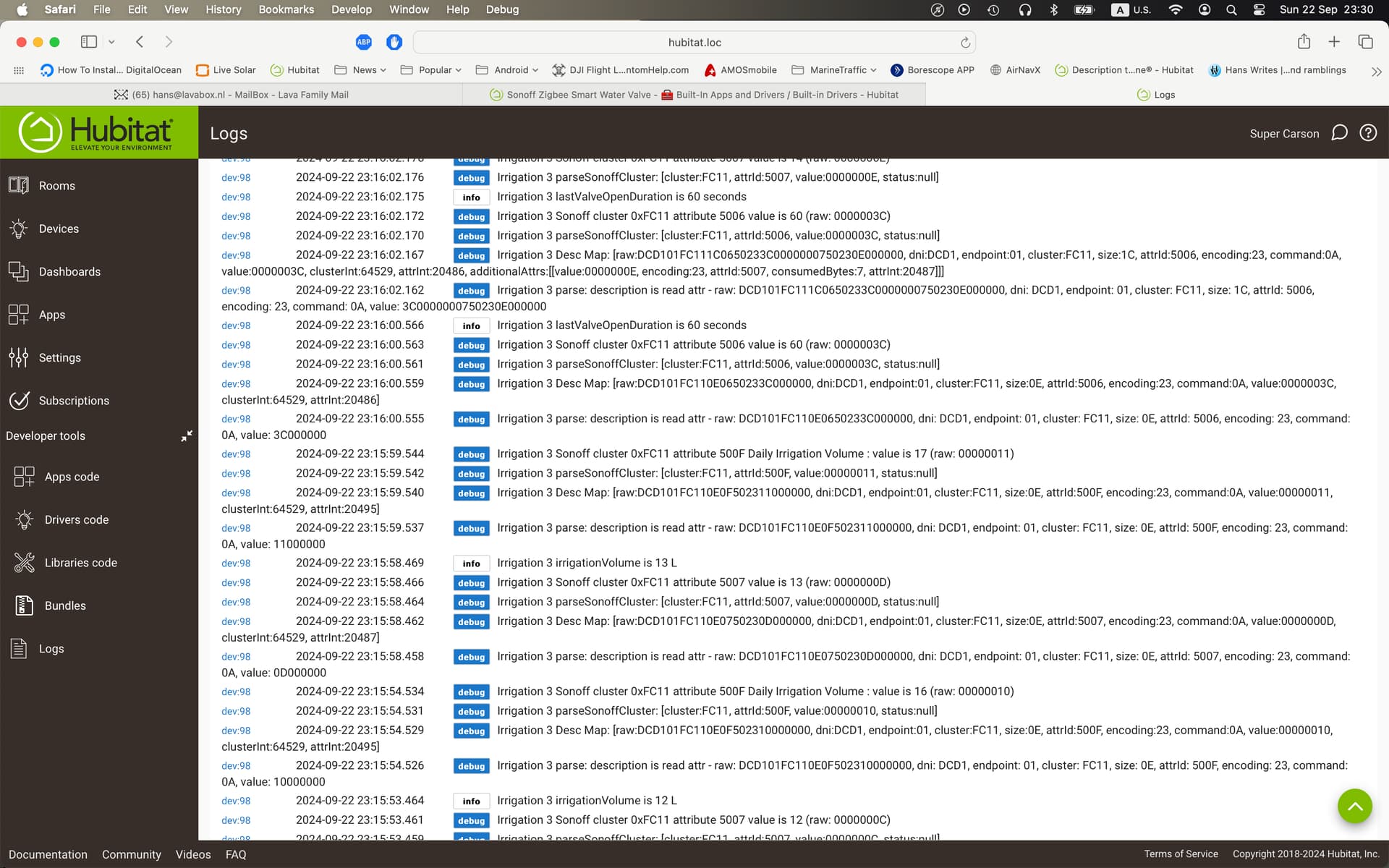

My tests so far. When I had the autoofftimer variable at a high number, everything worked as expected. Open valve, irrigationStartTime gets updated, volume rises etc etc.
Clicking on close the valve, irrigationEndTime gets updated, and lastValveOpenDuration gets updated. All normal.
When I changed the variable back to the default 60 seconds, everything works, but what threw me off was that after 60 seconds open, the lastvalveopenduration gets updated to 60.
First I thought the valve had closed, but in fact it hadn't. The duration gets updated every 60 seconds, to 120, 180, 240 etc. That was the only thing.
