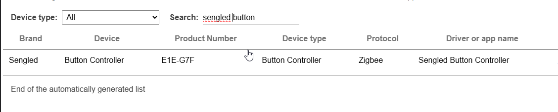

I would try this driver.
Sengled Button Controller

Tried embedding a jpg but was, denied. I'll try in a separate post

For Images:
