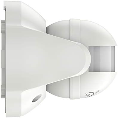

I have 2 ZooZ Zwave detectors that watch my driveway and vehicle area. They do a good job with only a very few false detections. They have a good quick detect rate. They aren't particularly attractive and are a little conspicuous but they work well.
