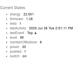

I am getting "Please wake up your sleepy device" message for an Inovelli Black On/Off switch (LZW30). I am trying to flash the beta firmware found below
