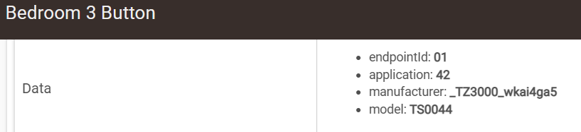

Hi All,
One of my Tuya Scene/Dimmer Switch TS004F button controllers is eating through batteries.
I purchased new Duracell CR/DL2430 coin batteries, used one on 1st March 23 and just after only 9 days, the new battery which measured 3.2volts is now dead (measuring around 2.89volts!).
The button controller basically flashes all buttons simultaneously when it deems the battery to be low. Anyone has any advice or experienced a similar issue?

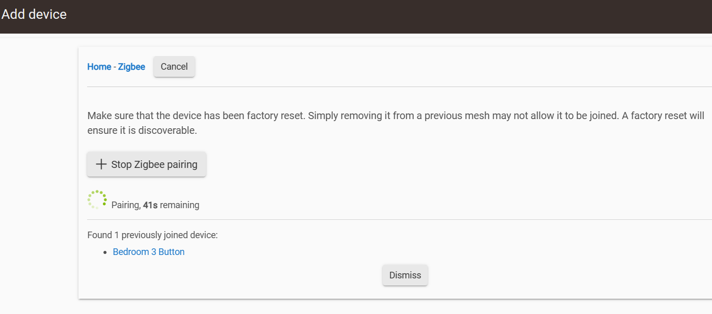

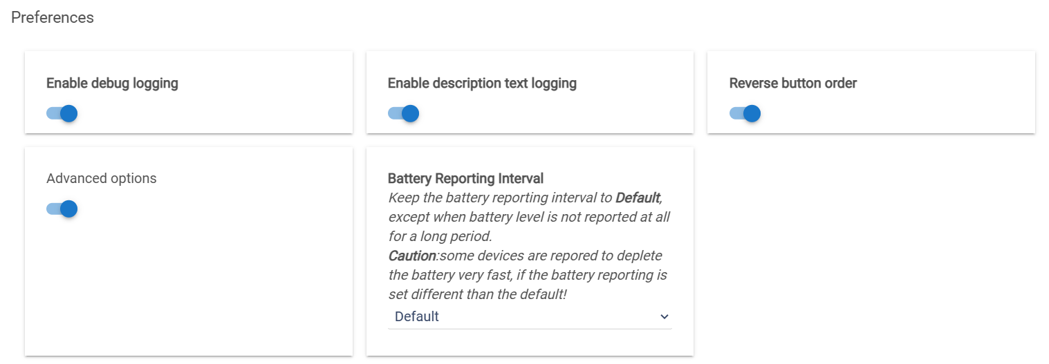

@iEnam please update the driver (Import button from the HE driver editor) to version 2.6.3, 2023/03/11 8:17 PM.

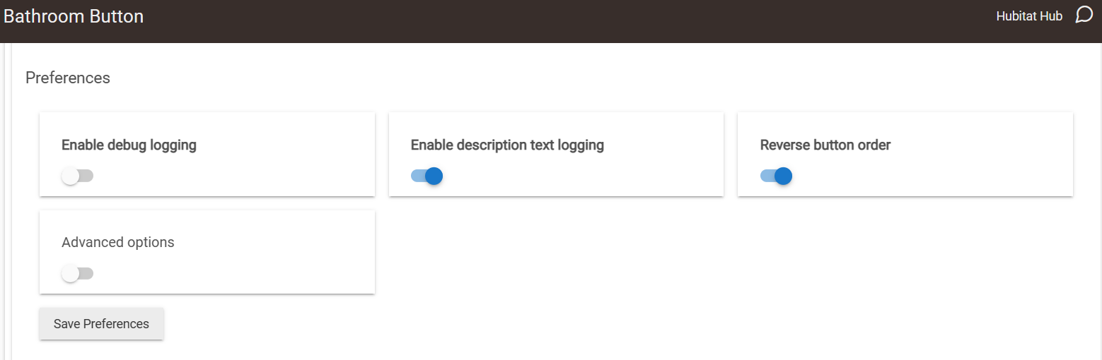

I have added now 'Advanced Options' and a new preference 'Battery Reporting Interval'

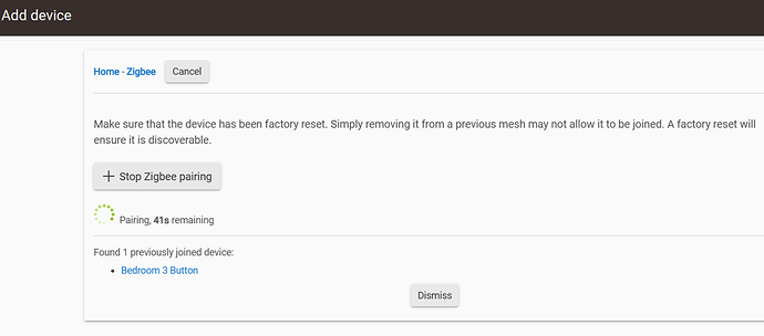

Please make sure it is set to Default, and then repair the problematic scene switches again to HE. Don't delete the existing devices from HE, just pair them again. It may be a good idea to remove the battery for 1-2 minutes before the new pairing.

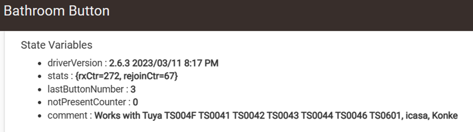

In the States Variables section (press F5 to refresh) there is a new reJoinCtr in the stats variable. This counter is increased every time the device falls off and rejoins again the HE zigbee network. In normal operations, this counter should stay as it is.

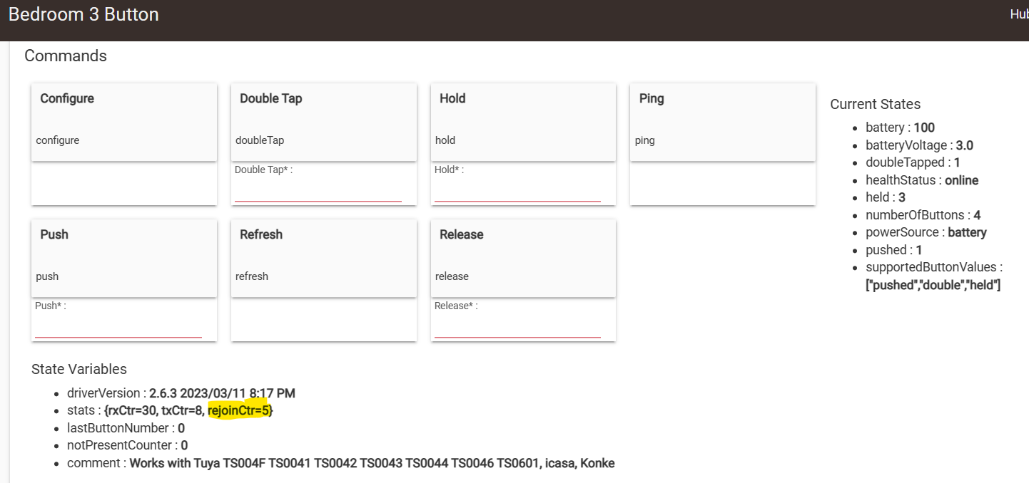

I have updated as per your instructions (re-paired twice, re-installed a new CR2032 battery earlier today @3.295v, currently measures @2.950v).
re-pairing
Current rejoin counter
bedroom 3 button details

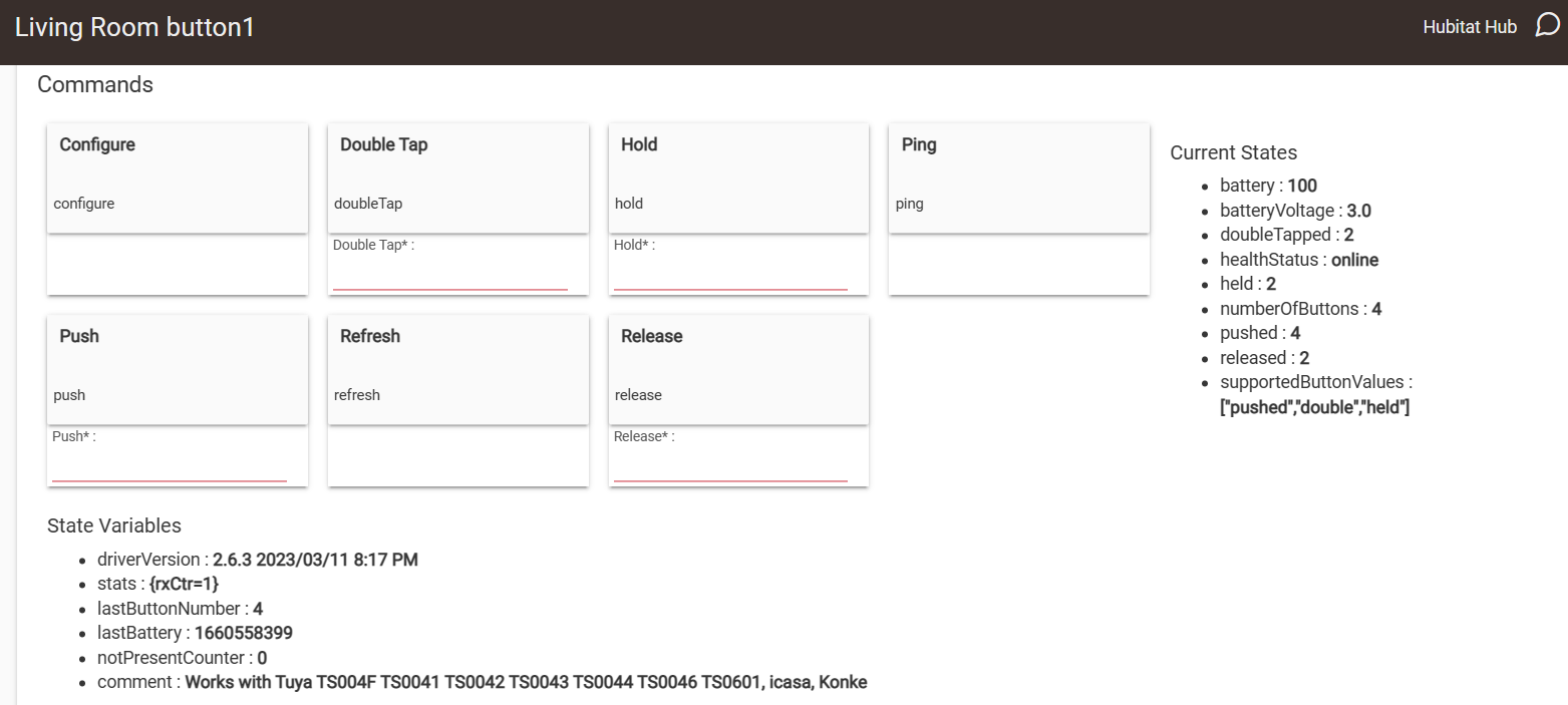

Also, please see below the current states for the two other devices.
(NB: I have not made any changes to these devices).
Bathroom button
Living room button - note: not sure why some stats are missing and this button had no issues

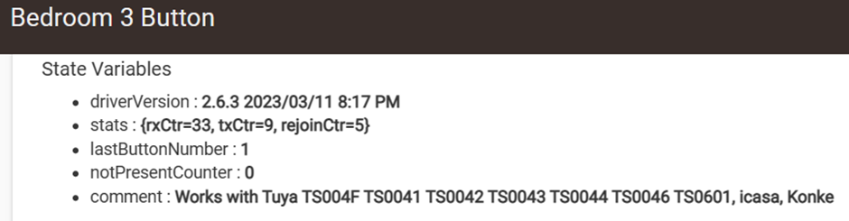

Just checked the stats; no change for bedroom 3 and Living room, but interesting results for bathroom...
No change in stats
Bathroom - rejoined network 65 times!
So the bathroom device obviously has problems..

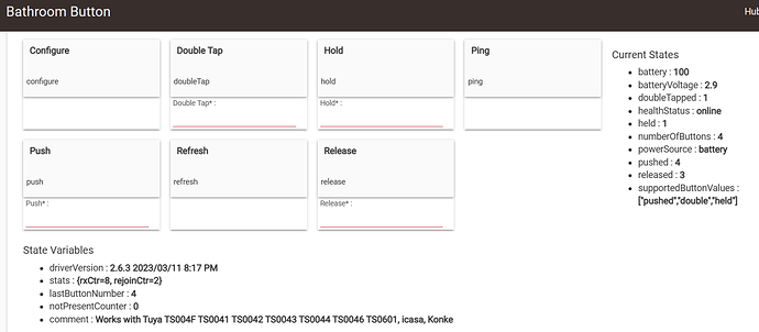

Please pair it again to HE hub (without deleting it).
We will monitor it, the rejoinCtr should stop increasing.
Thanks for your help.
I re-paired the bathroom device 8 hours ago and the rejoinCtr counter has stopped increasing :smile:
Could you please confirm what the default battery report interval is?
Bathroom device

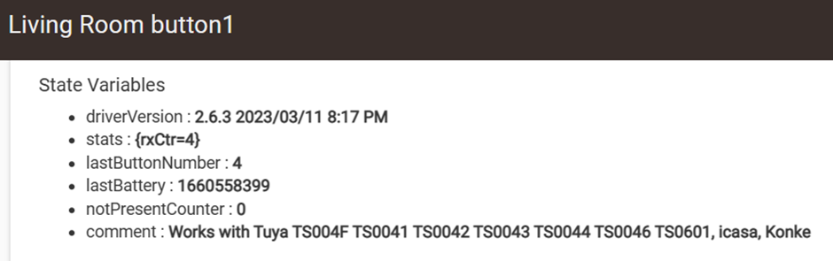

Also, I re-paired the living room device and rejoinCtr counter increased by 1 :smile::
Living room device

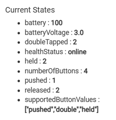

Hi, I just updated the driver to the latest version and my attributes look like this.
Is that the expected display? powerSource : battery seems like an unexpected value for a handheld remote. I was rather expecting a battery percentage.
For reference I have the Moes TS0044F
But the driver itself is working great so not a big deal. Just looking for the cherry on top.
