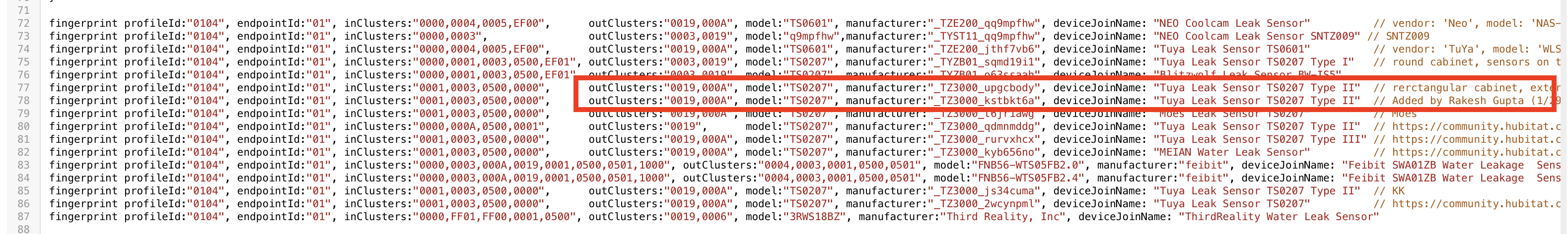

@kuzenkohome - Thanks for your help. I found the cluster info and added it to the driver code.

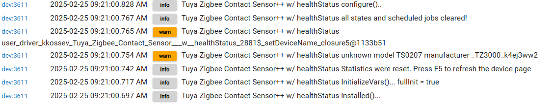

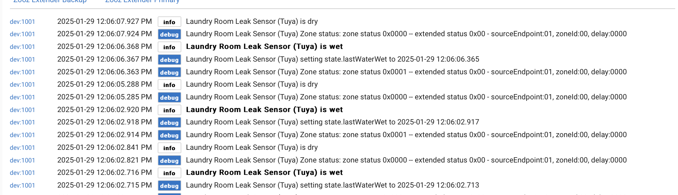

This water leak detector initially paired with type Tuya Zigbee Contact Sensor++ w/ healthStatus. It did not report wet/dry. I changed it to this driver (Tuya NEO Coolcam Zigbee Water Leak) and it works fine.
https://www.amazon.com/dp/B0DNMJQW4S

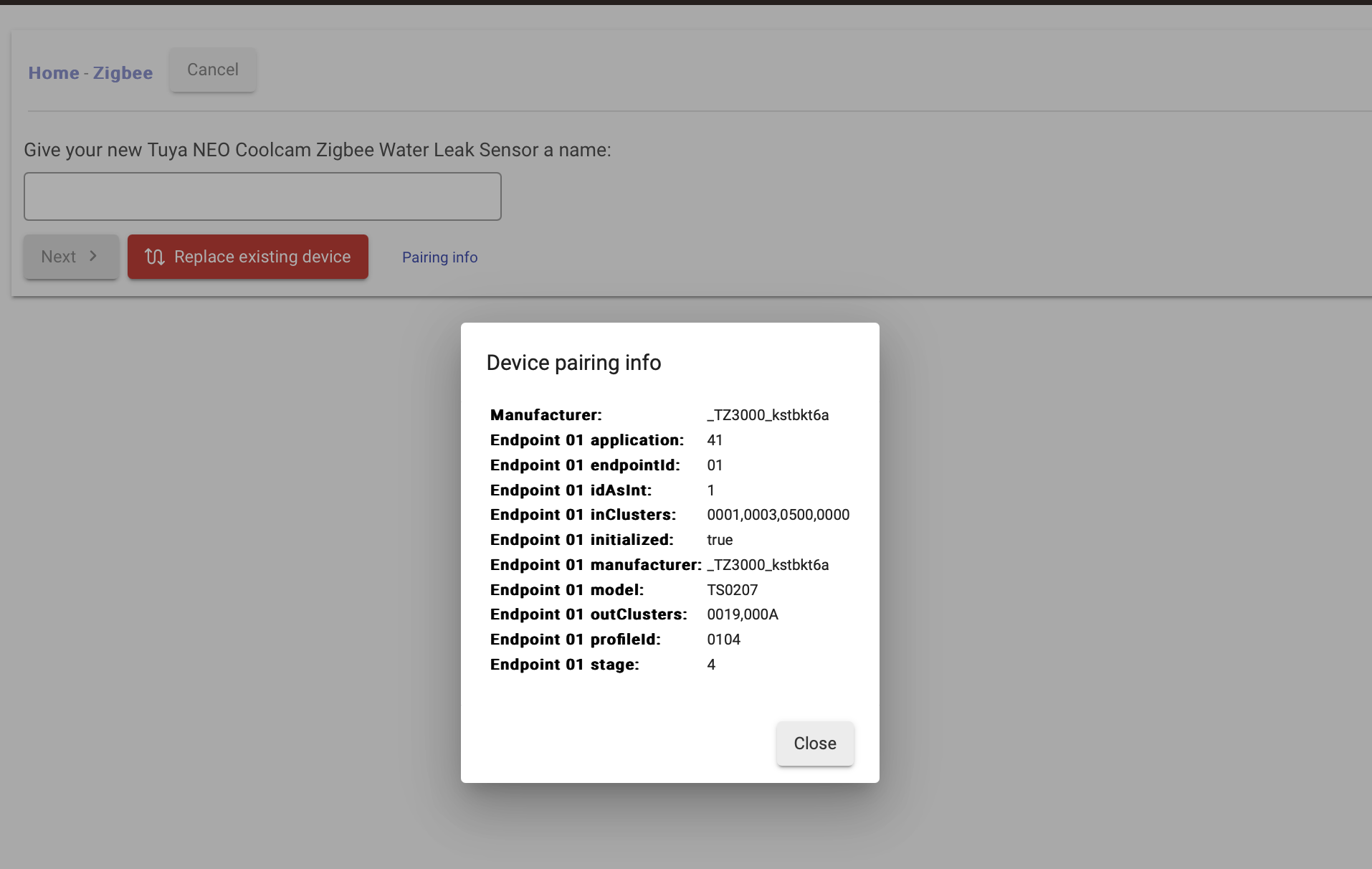

Initial pairing:
