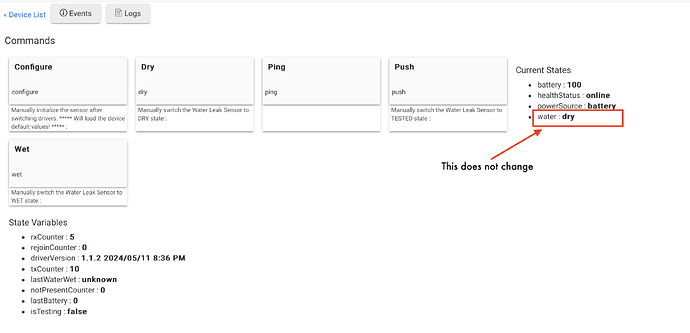

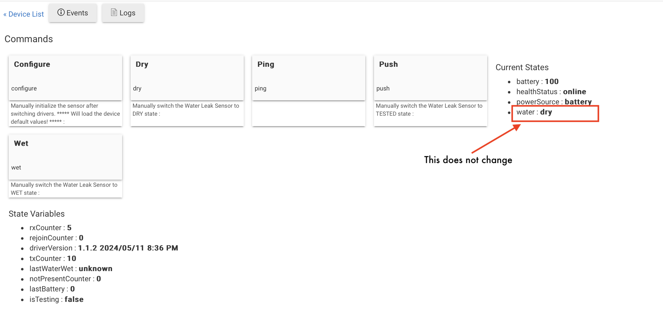

Hi @kkossev - I purchased the Tuya Leak Detector (Zigbee Water Leak Sensor, Require Zigbee Hub, Tuya Water Leak Detector for Alarm System and Smart Home Automation for Kitchen Bathroom Work with Alexa Google Home (1) - Amazon.com) and tried the Generic Moisture Sensor (as well as the "no temp" version) and it did not work. When using your driver, all the attributes show up, but the water wet/dry stays on "dry" even when I am dipping the contacts in water (just enough to wet the sensor tips).

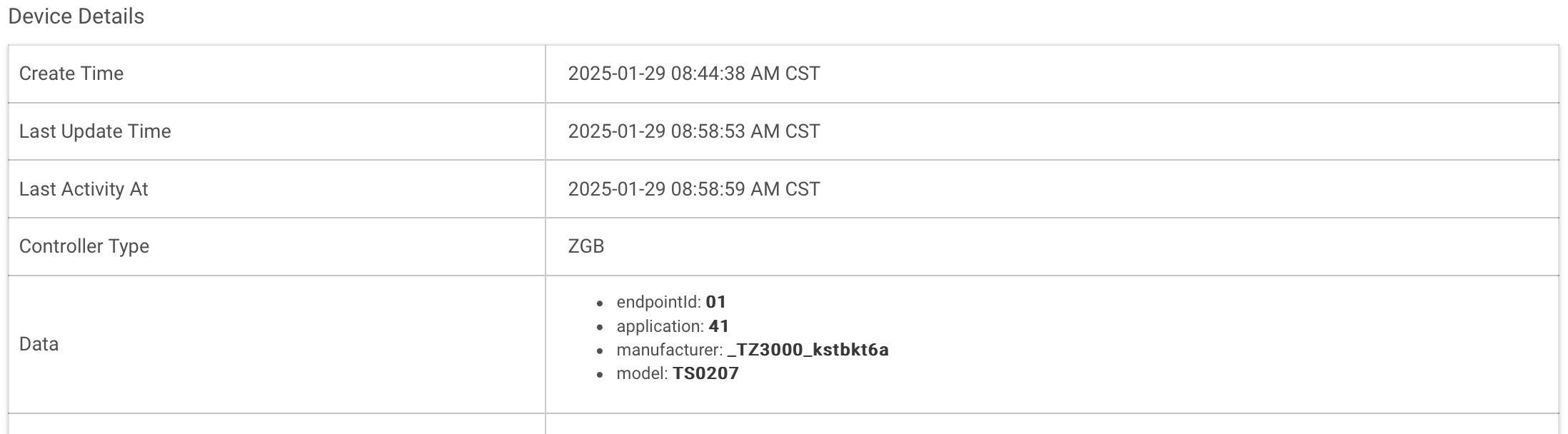

Here are the device details:
Is there anything that I am missing? I have "re-paired" the device multiple times. Thanks for your help
EDIT: I saw that others had copied the fingerprint from one of the existing ones and matched the "manufacturer" to what as in their Device Details section, but I wasn't sure which one I should copy (they appear to have different in/out clusters)
I don't see this fingerprint in the driver code. Did you make the change just to your version?
Yes I only changed my driver, I posted (and tagged kkossev) so he could update his public driver.
I used one of the existing fingerprints that matched the cluster order of the sensor I had and changed the manufacturer id, then added that as another fingerprint. Made no other changes to the driver.
Paired 10 sensors after that and all paired first attempt.
How did you find the cluster order? My sensor is pairing but will not report wet/dry (always dry)
