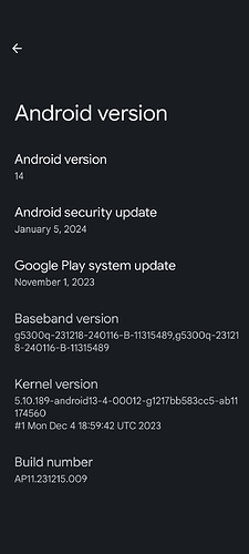

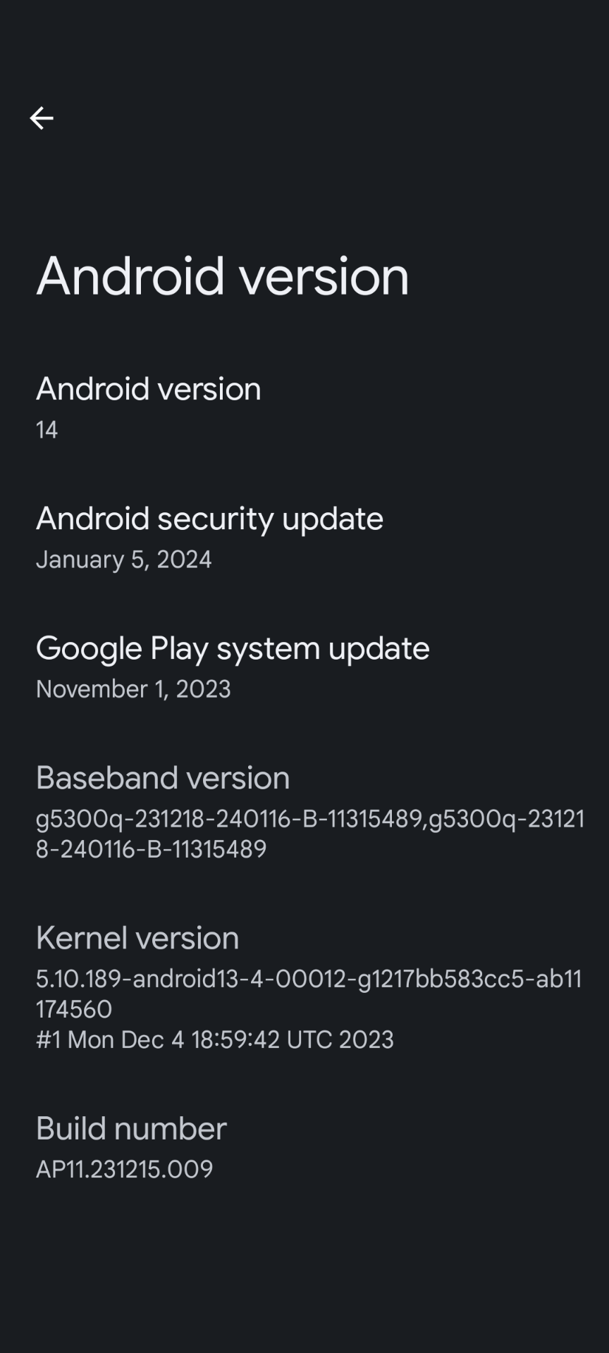

Here are my screenshots of Pixel 7 beta 14. I have always been on the beta program so whatever Samsung put out as 14 I don't know. Usually they are 6 months toa year behind - in the old days :slight_smile:

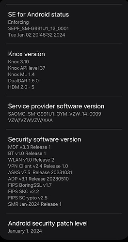

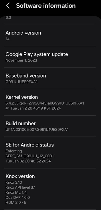

Here's more details...Samsung has been pushing things out quickly for years now...get the unlocked phones directly from them and no delay from my carrier Verizon.

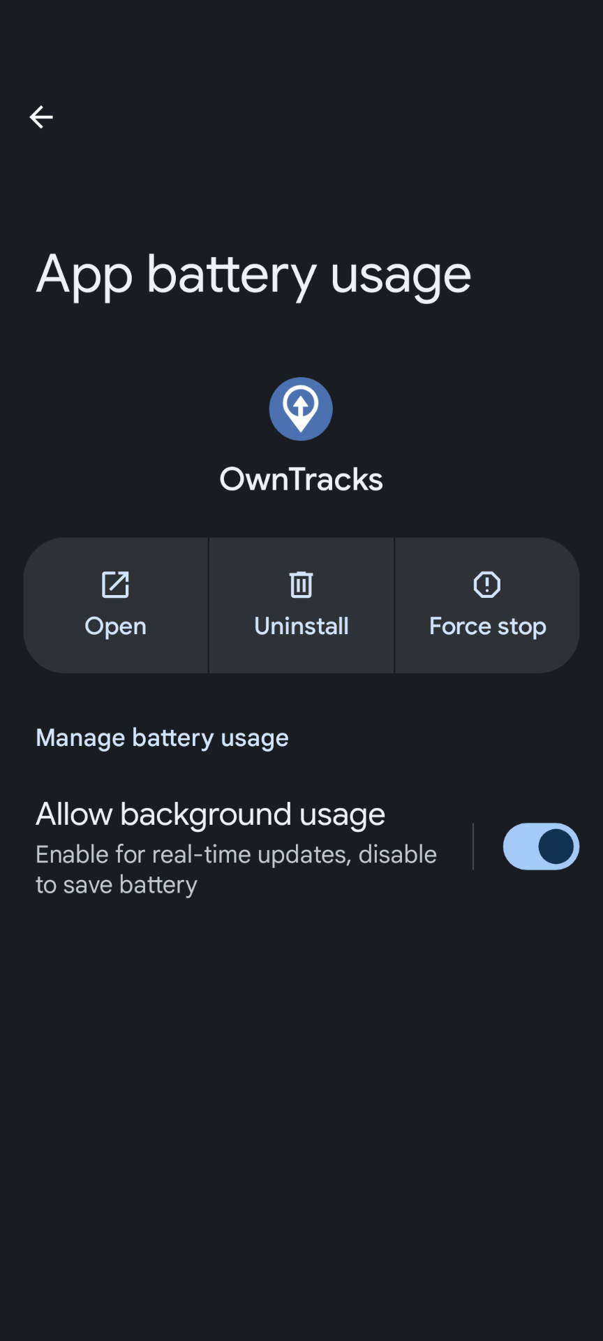

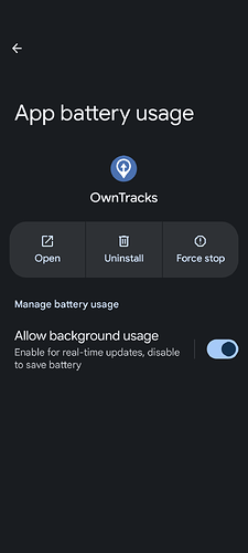

Let me see if I can det the SDK for t Android Studio to check what that change does for the battery notification.
