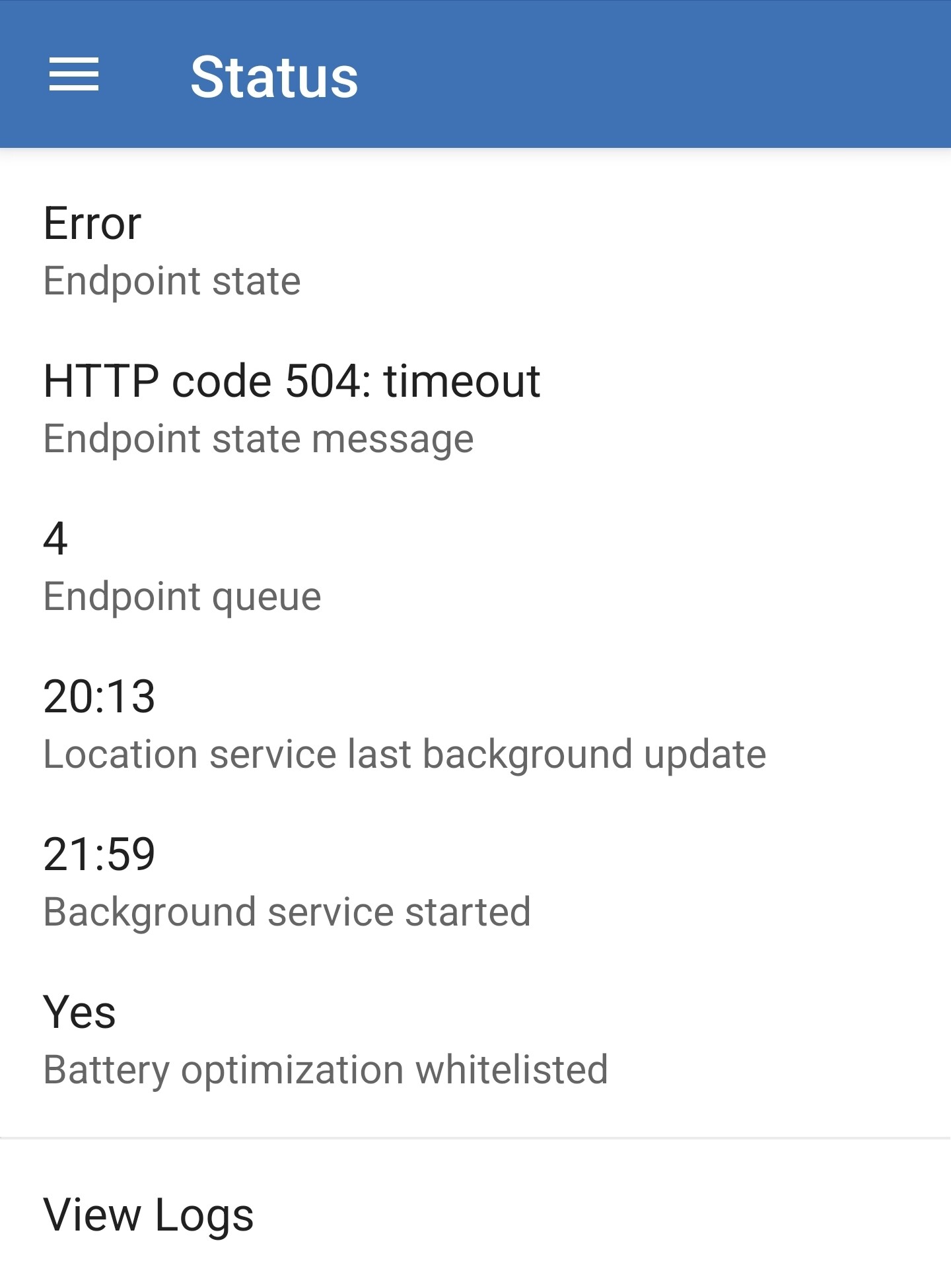

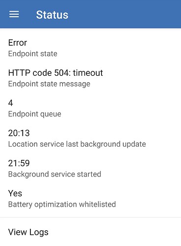

@lpakula,
Great app, just recently started using it.
Could you please advise on the error below"
App v2.4.17
Logs
2024-01-29 21:56:00.139 E MessageProcessor/onMessageDeliveryFailed/364: Message delivery failed. queueLength: 5, messageId: 1706559127232-86843d 2024-01-29 21:56:00.143 W MessageProcessor/sendAvailableMessages/270: Error sending message. Re-queueing 2024-01-29 21:56:00.163 I MessageProcessor/sendAvailableMessages/299: Waiting for 120 s before retrying 2024-01-29 21:58:10.282 E MessageProcessorEndpointHttp/sendMessage/271: HTTP Delivery failed java.net.SocketTimeoutException: timeout at okio.SocketAsyncTimeout.newTimeoutException(JvmOkio.kt:147) at okio.AsyncTimeout.access$newTimeoutException(AsyncTimeout.kt:158) at okio.AsyncTimeout$source$1.read(AsyncTimeout.kt:337) at okio.RealBufferedSource.indexOf(RealBufferedSource.kt:427) at okio.RealBufferedSource.readUtf8LineStrict(RealBufferedSource.kt:320) at okhttp3.internal.http1.HeadersReader.readLine(HeadersReader.kt:29) at okhttp3.internal.http1.Http1ExchangeCodec.readResponseHeaders(Http1ExchangeCodec.kt:178) at okhttp3.internal.connection.Exchange.readResponseHeaders(Exchange.kt:106) at okhttp3.internal.http.CallServerInterceptor.intercept(CallServerInterceptor.kt:79) at okhttp3.internal.http.RealInterceptorChain.proceed(RealInterceptorChain.kt:109) at okhttp3.internal.connection.ConnectInterceptor.intercept(ConnectInterceptor.kt:34) at okhttp3.internal.http.RealInterceptorChain.proceed(RealInterceptorChain.kt:109) at okhttp3.internal.cache.CacheInterceptor.intercept(CacheInterceptor.kt:95) at okhttp3.internal.http.RealInterceptorChain.proceed(RealInterceptorChain.kt:109) at okhttp3.internal.http.BridgeInterceptor.intercept(BridgeInterceptor.kt:83) at okhttp3.internal.http.RealInterceptorChain.proceed(RealInterceptorChain.kt:109) at okhttp3.internal.http.RetryAndFollowUpInterceptor.intercept(RetryAndFollowUpInterceptor.kt:76) at okhttp3.internal.http.RealInterceptorChain.proceed(RealInterceptorChain.kt:109) at okhttp3.internal.connection.RealCall.getResponseWithInterceptorChain$okhttp(RealCall.kt:201) at okhttp3.internal.connection.RealCall.execute(RealCall.kt:154) at org.owntracks.android.services.MessageProcessorEndpointHttp.sendMessage(MessageProcessorEndpointHttp.java:238) at org.owntracks.android.services.MessageProcessor.lambda$sendAvailableMessages$0$org-owntracks-android-services-MessageProcessor(MessageProcessor.java:252) at org.owntracks.android.services.MessageProcessor$$ExternalSyntheticLambda2.call(Unknown Source:4) at java.util.concurrent.FutureTask.run(FutureTask.java:264) at android.os.Handler.handleCallback(Handler.java:958) at android.os.Handler.dispatchMessage(Handler.java:99) at android.os.Looper.loopOnce(Looper.java:230) at android.os.Looper.loop(Looper.java:319) at android.os.HandlerThread.run(HandlerThread.java:67) Caused by: java.net.SocketException: Socket closed at java.net.SocketInputStream.read(SocketInputStream.java:188) at java.net.SocketInputStream.read(SocketInputStream.java:143) at org.conscrypt.ConscryptEngineSocket$SSLInputStream.readFromSocket(ConscryptEngineSocket.java:920) at org.conscrypt.ConscryptEngineSocket$SSLInputStream.processDataFromSocket(ConscryptEngineSocket.java:884) at org.conscrypt.ConscryptEngineSocket$SSLInputStream.readUntilDataAvailable(ConscryptEngineSocket.java:799) at org.conscrypt.ConscryptEngineSocket$SSLInputStream.read(ConscryptEngineSocket.java:772) at okio.InputStreamSource.read(JvmOkio.kt:94) at okio.AsyncTimeout$source$1.read(AsyncTimeout.kt:125) ... 26 more 2024-01-29 21:58:10.290 E MessageProcessor/onMessageDeliveryFailed/364: Message delivery failed. queueLength: 5, messageId: 1706559127232-86843d 2024-01-29 21:58:10.294 W MessageProcessor/sendAvailableMessages/270: Error sending message. Re-queueing 2024-01-29 21:58:10.305 I MessageProcessor/sendAvailableMessages/299: Waiting for 120 s before retrying 2024-01-29 21:59:07.242 I ServiceStarter$Impl/startService/16: starting service

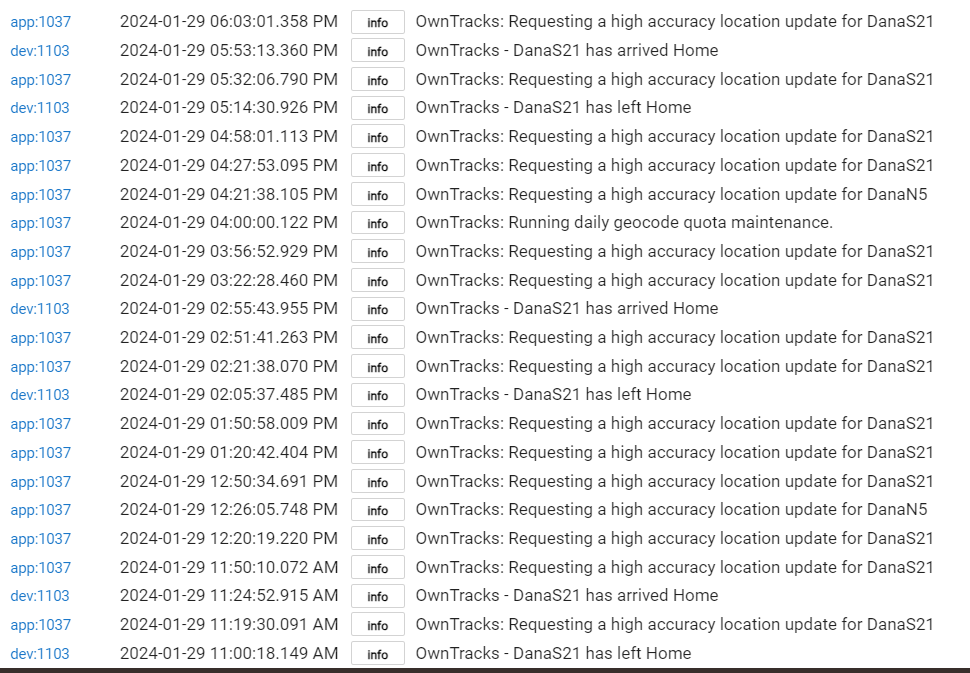

I get them everytime my phone checks in.
dev:21422024-01-29 16:01:12.105debugApp settting: 'App battery usage' is 'Optimized' or 'Restricted'. Please change to 'Unrestricted'
dev:21422024-01-29 16:01:12.057debugUpdating 'Location' presence for OwnTracks - DaveOT -- 0.0 km from Home, Battery: 33%, accuracy: 100 m, Location:
I just got 14 on my S21 and I'm not getting those logs from the device.

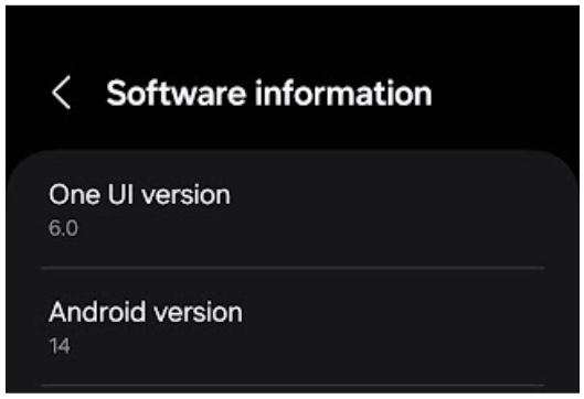

How can you be on the beta with a Sammy?
Not on a beta, never been on a beta w/this phone. Just got the update yesterday.
