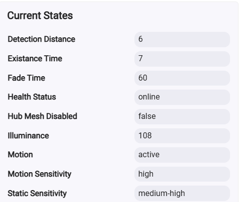

OK, sorry to say, but had one of my Linptech's stop reporting motion. It stopped reporting last night, noticed when lights didn't go off when we were at the other end of the house.
It does report "Online" in spite of getting stuck reporting Active and never changing:
So at least for me this attempt at changing sensitivity settings is not a solution to the Linptechs stopping reporting after a while... :frowning:
I'll go back to power cycling weekly... @kkossev, if you have any other suggestions I'm happy to start another test. :slight_smile:
