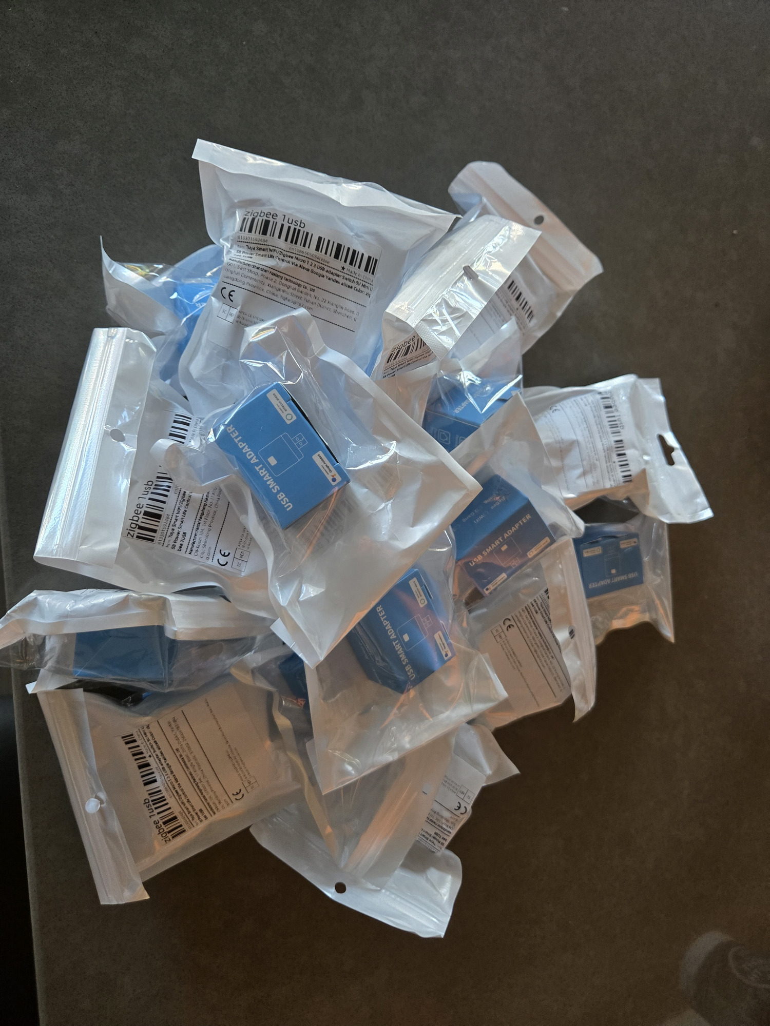

Okay, something weird is going on. While setting up the plugs, I flashed one of the sensors too much, and it got reset. No problem, I thought. I put it in pairing mode and tried to rediscover it, but it won't pair again!

I am thinking maybe all the new plugs connected directly to the hub and exhausted the 32 directly connected devices limit. I'll give them time to get settled on the repeaters, opening up the hub for more devices. Will report tomorrow.

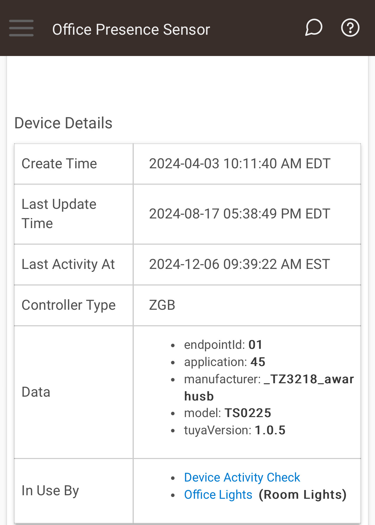

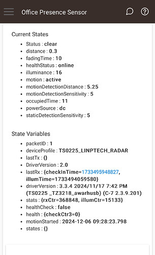

How are you all powering your Linptech sensors? I have two that I’ve never had to turn on or off. They e been hooked up for months now. I power them over POE from a POE switch.
Mine have were initially powered by various USB power blocks/bricks, all 1A or higher. Changing Linptech's power source to plugs directly connected to wall outlets didn't improve reliability. So for me, regardless of power source, one or two of the six I have has eventually gone bye-bye after a month or three.
