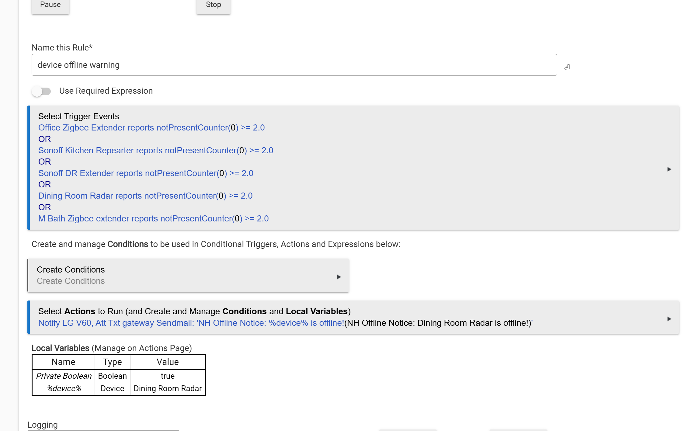

I added mine to usb zigbee switches so i can control them and added a rule to alert me when they stop sending messages for a few cycles (on current setup i think around 1/2 hour
) so i can reboot them.. Usually only goes offline once every month or two.
Thats why i use @kkossev drivers that have the attributes i need to montor to alert me.
ie

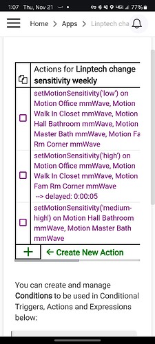

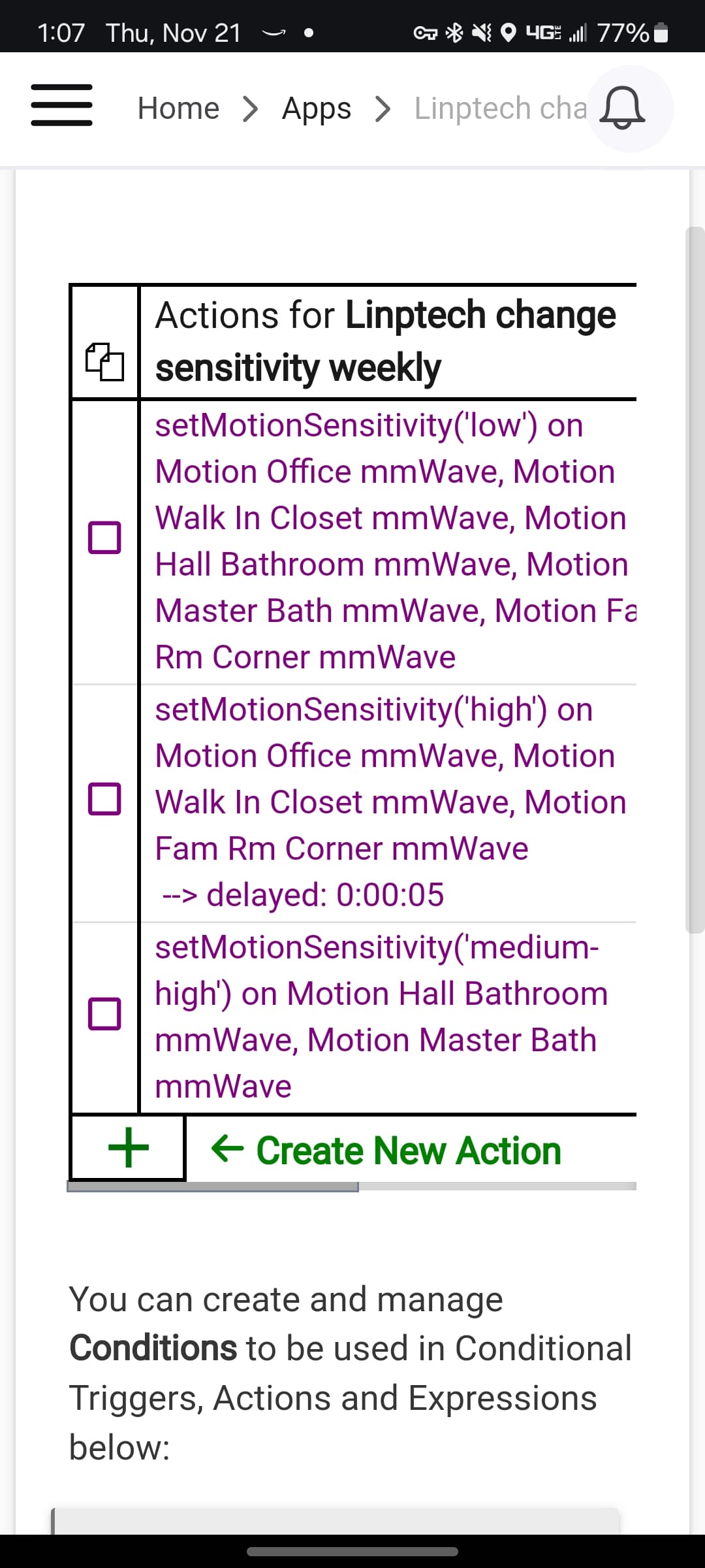

A quick pre-holiday update on the "long term" test of changing sensitivity settings to keep the sensors from lock-ups where they stop reporting motion/presence...
~3 1/2 weeks since I started the test and still zero lock-ups w/the five sensors, all have been solid, reacting/reporting w/out issue.
Still too short a period to declare victory, but hopefully things will continue this way. That would be a nice holiday gift. :slight_smile:

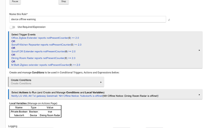

Would you mind sharing a screenshot of your rule? I would like to get this setup as well. Thanks!
Pretty simple, I use a 5am trigger.

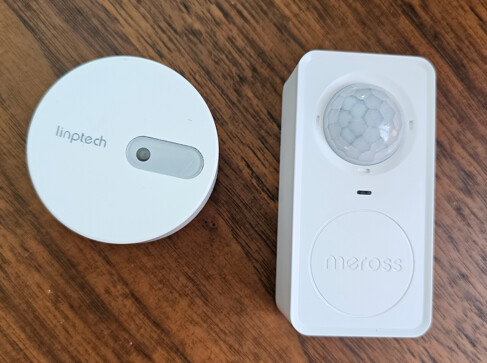

I just replaced 4 of Linptech sensors with Meross MS600 mmWave/PIR matter sensors.
These are BIG but hopefully will work better.
It is bigger in some dimensions but not as huge as I first thought...biggest issue in my house would be shape and build, the giant "eye" on it would likely get a "No" from my wife based on some past attempts w/similar looking devices.
Just for fun can you post a pic of the two next to each other?
Here it is:
I am happy, my wife is not that picky about my toys and sometime exposed wires. Actually she likes all my hands/commands free automations. WAF is very high. But she becomes very upset when something fails. This included Linptech lockups.
