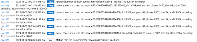

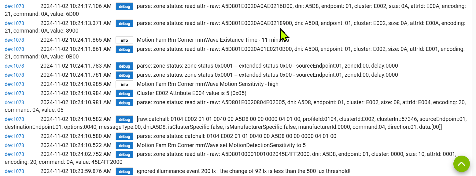

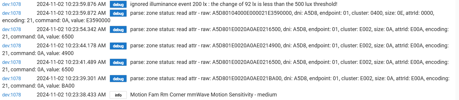

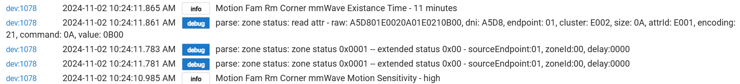

So I gave it a try, and this is what I get in logs, changing from High to Medium and back to High again:
Is it doing what you hoped? I don't see it going to inactive, and the active minutes timer is at 11m after the change back to High, I'd assume from what you said that if the setting change worked to force re-calibrate that the active timer would restart. Should this setting change work w/both Gassgs driver (which I'm using), and your mmWave driver as well?
Yes, both custom drivers can dynamically change the Linptech parameters (the Preferences); only the commands are different.
I don't see the presence being reset from these logs...

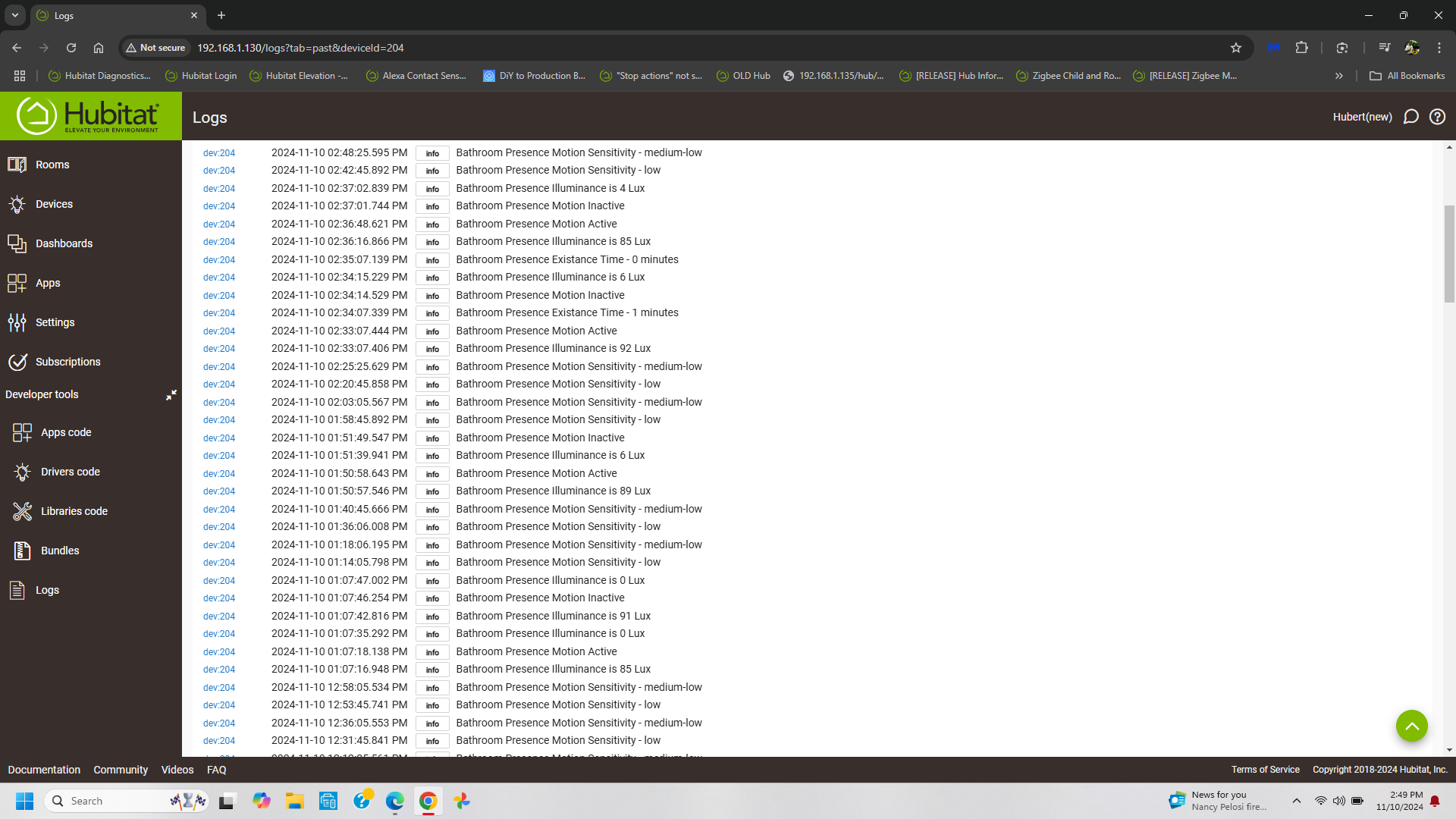

In case this answers any questions here is one of mine that changes sensitivity when my AC runs. Presence does not change
