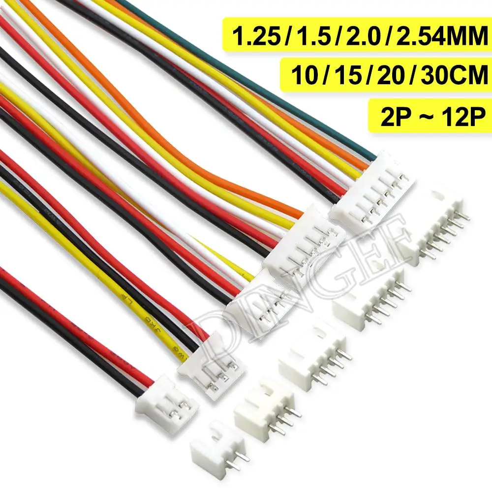

for reference, to attach flashing wires to the USB-wifi relay sticks I order this. JST 1.25mm pitch 6 pin kit. stick the 6 pin male connector onto the end of the female cable. Cut off the other end of the cable to allow attaching to a TTY Serial programmer. Dont forget to tie GPIO0 (labeled as IO0 on the silk screen of the PCB) to GND to cause the device to enter reflash mode upon power on reset. Make quick work out of refreshing a bunch of these USB sticks without the need to solder or create a special jig as some others have done.
