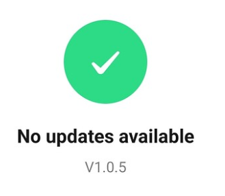

The C8 can't update the Linptech sensors FW (not yet, anyway), and the current Linptech FW version is 1.0.5, so so not sure exactly what that message means.
