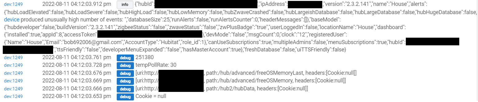

Right, but not here:
And what is generating that? It looks like it’s a modified version of the driver.
This driver, unmodified, installed via HPM. Even did an update today because I was a few versions behind. I just had debug logging enabled. With debug logging turned off, the driver doesn't generate any logs.
I obviously haven’t run it in full debug mode for quite a while. Didn’t remember having many of those debug lines in there, but their purpose is to help diagnose logic issues or broken connections. Would actually be a simple 2 line modification to produce a log entry when an attribute changed (one to capture a prefence switch and one to log).
