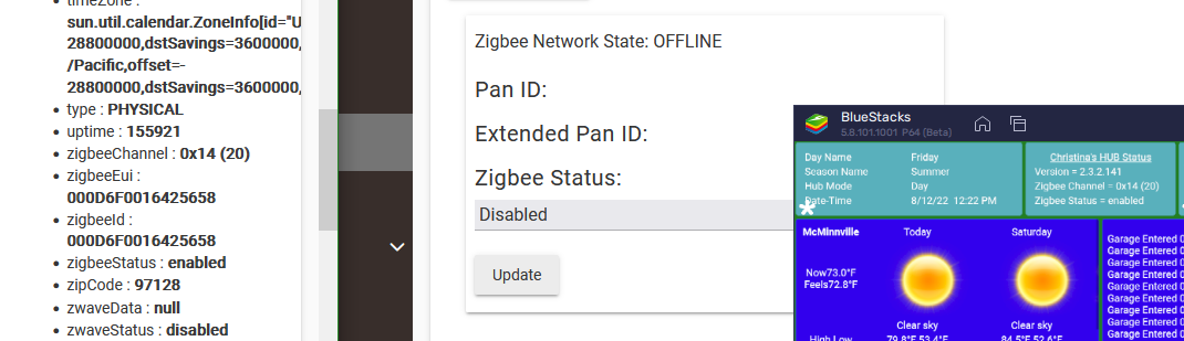

If I disable Zigbee - the HubInfo driver doesn't show zigbee offline or disabled. I waited more than 10 minutes in case it was a delay thing.
I noticed it one day when Alexa told my my Zigbee was down but my dashboard gave no indication. Switching to the native dashboard shows the same - so I don't thing it's refresh rate on my Android emulator.
You’re still showing an active channel which is what it is keying on (I have another option but it doesn’t respond as quickly). Are you on a C7 or ???
yes. a c7. i'm that wierd guy who only uses zigbee - and am currently loosing my zigbee network about once a week during a device check where about 25 devices are toggled... Since there is no way to turn the 'overloaded' zigbee back on without a reboot I'd love to see my monitor tile show it's gone down in case I don't heard the verbal notifier I get through my Alexa - come to think of it, I wonder how I've got Alexa triggering...
I have an XTCU, maybe I can code it to watch for the C device going offline and force a power cycle.. hmm. nah. to much work.
Yea. so alexa's pulling from an internal variable -
To bad I can't find a way to zigbeeOn in a Rule!
I’ll take a look at implementing the second method when I get back home Monday.
@jshimota v2.6.37 adds an additional zigbee status (zigbeeStatus2) - zigbeeStatus and zigbeeStatus2 should always agree (will generate a warning in the logs if they don't), but are drawn from different sources.
