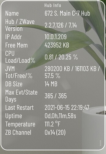

The HTML tile on the dashboard shows as:

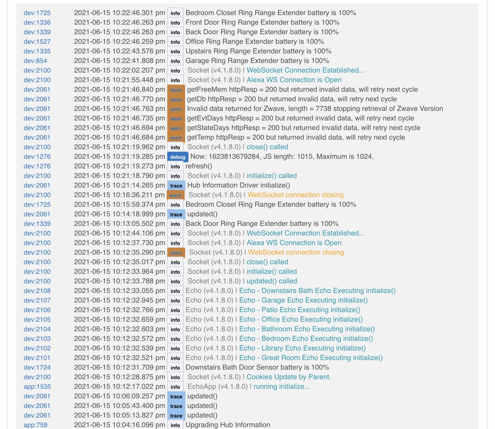

Well, here are the logs on the reboot after reload. That’s a really large ZWave result length that caused termination. But the device page now loads.
Think I’m getting in before the hub is completely ready. May have to delay the first run, or just let it cycle with the size check in place. Going to play a little but should have 2.4.2 out early in the morning.
Ok. After the first update cycle, no errors, everything working well.
