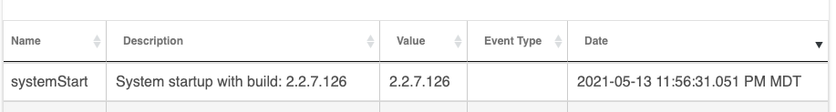

Hey @thebearmay, for some reason the last hub restart value in the driver doesn't match my system log. I'm pretty sure the hub hasn't been restarted since the 13th. It looks like the uptime value is correct so I'm not sure what's up with the restart value.
Any thoughts?
It can also get reset if you hit the Initialize button. (It uses the initialize action at startup to set the date/time, but that also creates the opportunity to do a manual initialize.) Looking at your uptime, it looks like your last actual restart was ~14 May 2021.
Thanks for the response. I wasn't aware a manual initialize would cause this. I'll just reboot the hub and then should be good to go.
Been meaning to put in a check to reset it back to the actual, might look at that today if I don't get interrupted by my real job too much.
Edit: 2.2.5 eliminates the issue with a manual initialize (should also eliminate the on creation discrepancy).

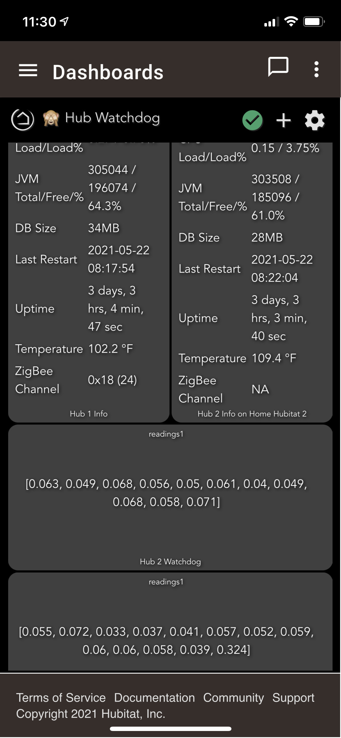

Is there any way to have the app report the Zigbee radio if it missed it at reboot. I’ve noticed that once it says Zigbee channel NA, it never displays the value. Yes, the Zigbee radio is on btw.

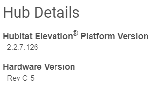

It's already asking the hub for the information each time it polls, so it sounds like in some special instance that isn't being reported back to the hub object. I'll look to see if there is another source I can pull from, but in case I need to engage support, what hub model and HE release are you experiencing this on?
It happens on both of my hubs, both are the same model and firmware. Sometimes one doesn't report after a reboot, sometimes it's the other.
I've noticed that if I do a full shutdown, and restart that I get a message that my Zigbee isn't available, but it disappears in under a minute and the driver is displaying all the data....
