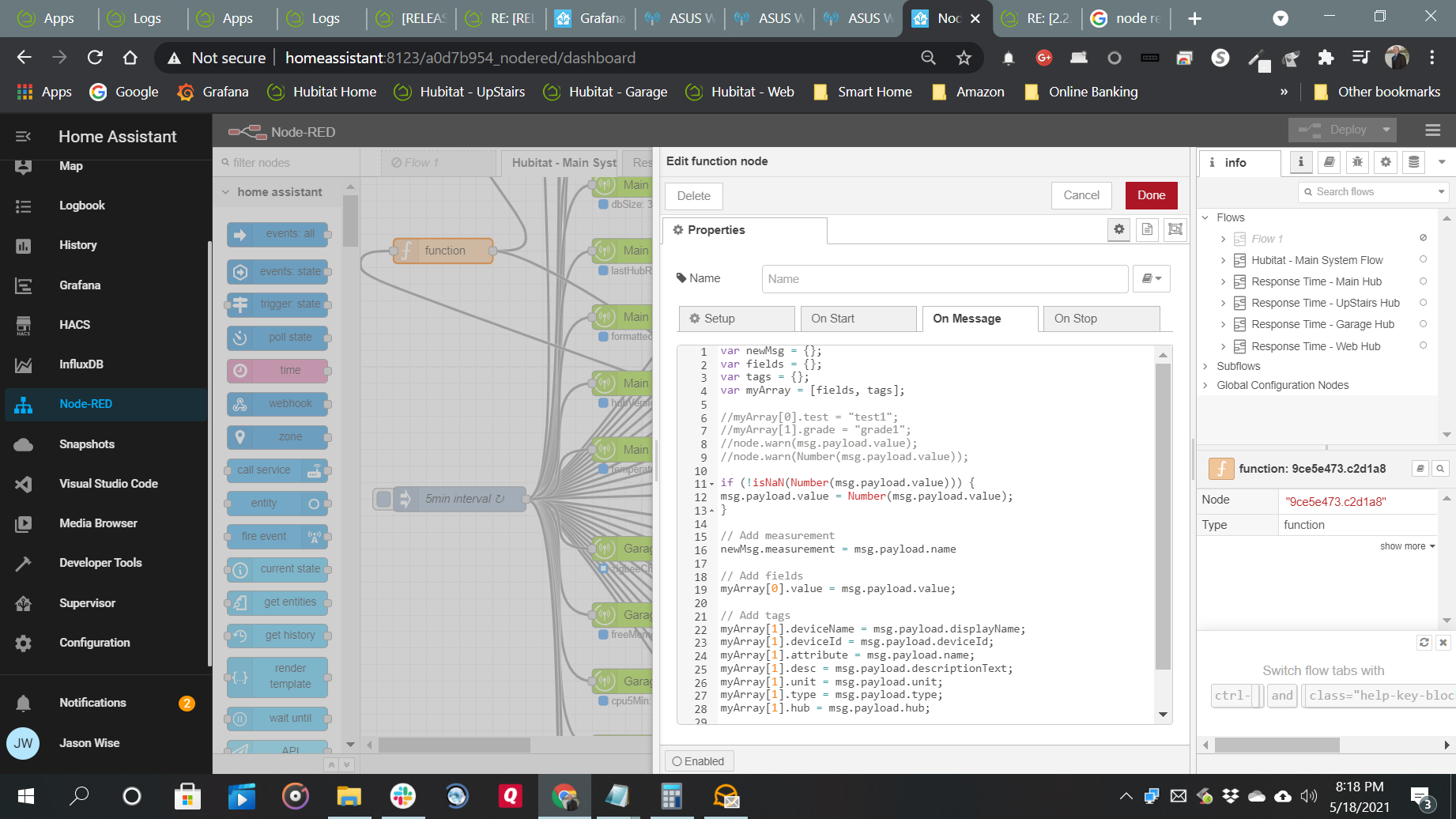

I am getting the parse error in node red.
Which is this node here
"id": "6926f499.78b3cc",
"type": "function",
"z": "a54023f9.b4d1c",
"name": "",
"func": "var newMsg = {};\nvar fields = {};\nvar tags = {};\nvar myArray = [fields, tags];\n\n//myArray[0].test = "test1";\n//myArray[1].grade = "grade1";\n//node.warn(msg.payload.value);\n//node.warn(Number(msg.payload.value));\n\nif (!isNaN(Number(msg.payload.value))) {\n msg.payload.value = Number(msg.payload.value);\n}\n\n// Add measurement\nnewMsg.measurement = msg.payload.name \n\n// Add fields\nmyArray[0].value = msg.payload.value;\n\n// Add tags\nmyArray[1].deviceName = msg.payload.displayName;\nmyArray[1].deviceId = msg.payload.deviceId;\nmyArray[1].attribute = msg.payload.name;\nmyArray[1].desc = msg.payload.descriptionText;\nmyArray[1].unit = msg.payload.unit;\nmyArray[1].type = msg.payload.type;\nmyArray[1].hub = msg.payload.hub;\n\n// Attach payload\nnewMsg.payload = myArray;\n\nreturn newMsg;",
"outputs": 1,
"noerr": 0,
"initialize": "",
"finalize": "",
"x": 560,
"y": 440,
"wires": [
"fc2c1e37.e2642"

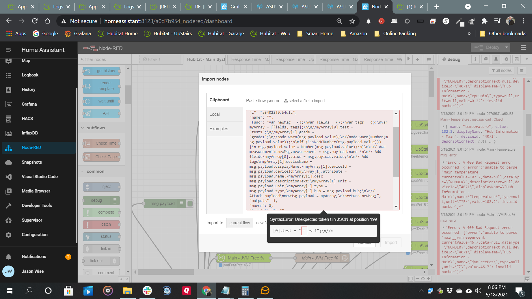

Not sure why this always happens. Can you show me the function please?
Ya I never can seem to get that right on the forum posts.
function1
Do I just put that in the function? Can you copy and paste it for me, so I don't have to retype it?

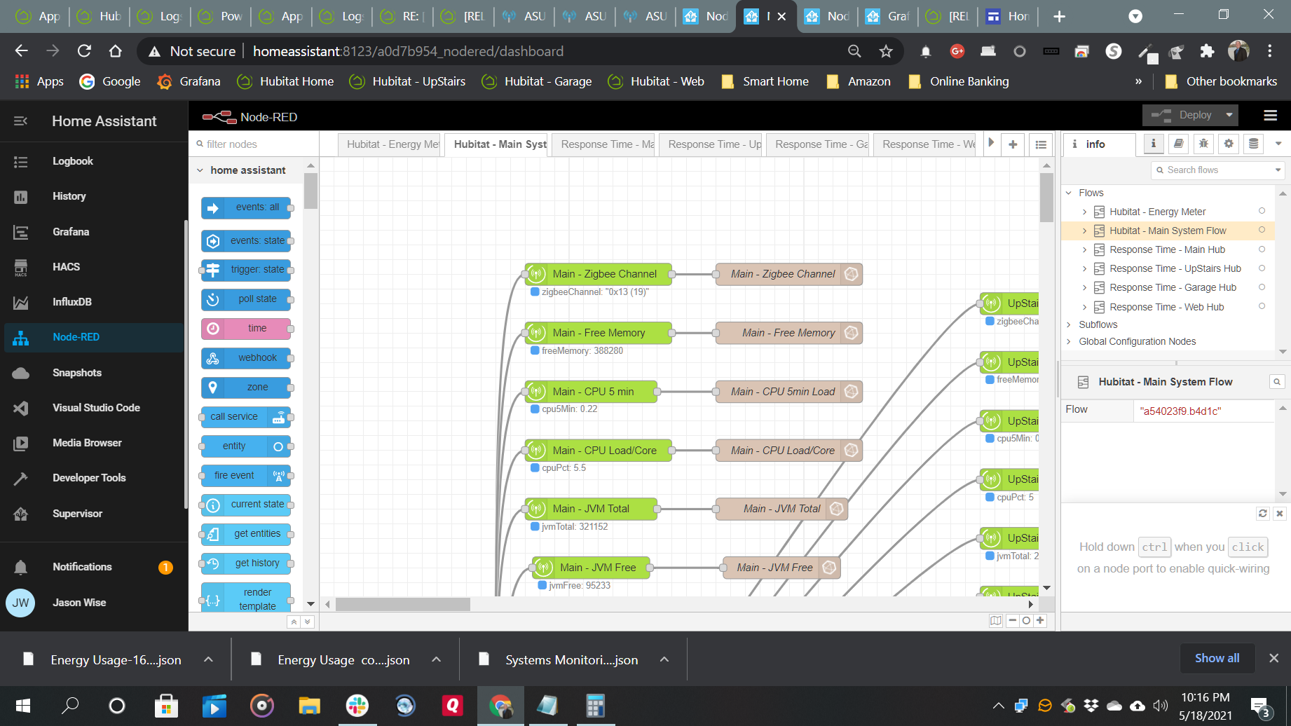

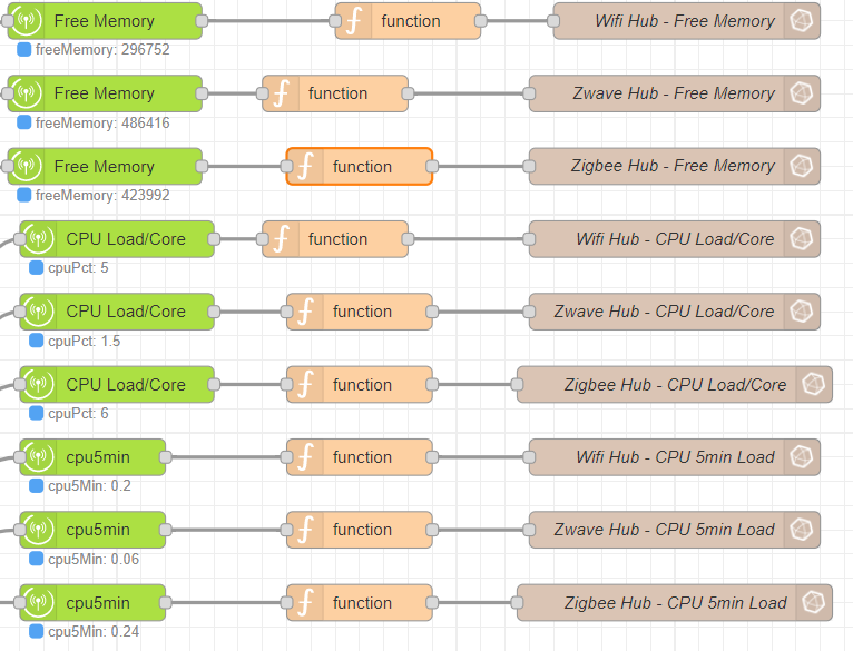

Any body having this issue? I am getting these errors from all 4 hubs. and it is mostly all the nodes, no just this one.
Error: A 400 Bad Request error occurred: {"error":"unable to parse 'main_cpu5minload currentValue=0.3,data=null,dataType="NUMBER",descriptionText=null,deviceId="4071",displayName="Hub Information - Main",name="cpu5Min",type=null,unit=null,value=0.3': invalid number"}
What processing are you doing on the node? A normal payload would look similar to:
{"name":"cpu5Min","currentValue":0.19,"dataType":"NUMBER","value":0.19,"deviceId":"863"}
but you have
...name="cpu5Min",type=null,unit=null,value=0.3': invalid number
None, this is my flow, was working fine, don't understand what changed.
I just don't understand, I put a debug on it and the payload looks good to me?
{ name: "temperature", currentValue: 104, dataType: "NUMBER", value: 104, deviceId: "4071" }
