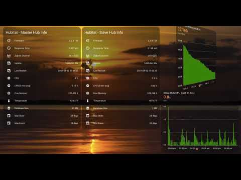

@thebearmay In another thread using this driver someone posted with gauges on their dash. How was that done?
There are a couple of ways to do graphs and gauges:
  1. Hubigraphs: Hubigraphs 4.8 (The Final Chapter)
  2. Node-Red Dashboards
  3. InfluxDB with Grafanna
  4. webCoRE graphs
You can also do some awesome graphs using Home Assistant.
