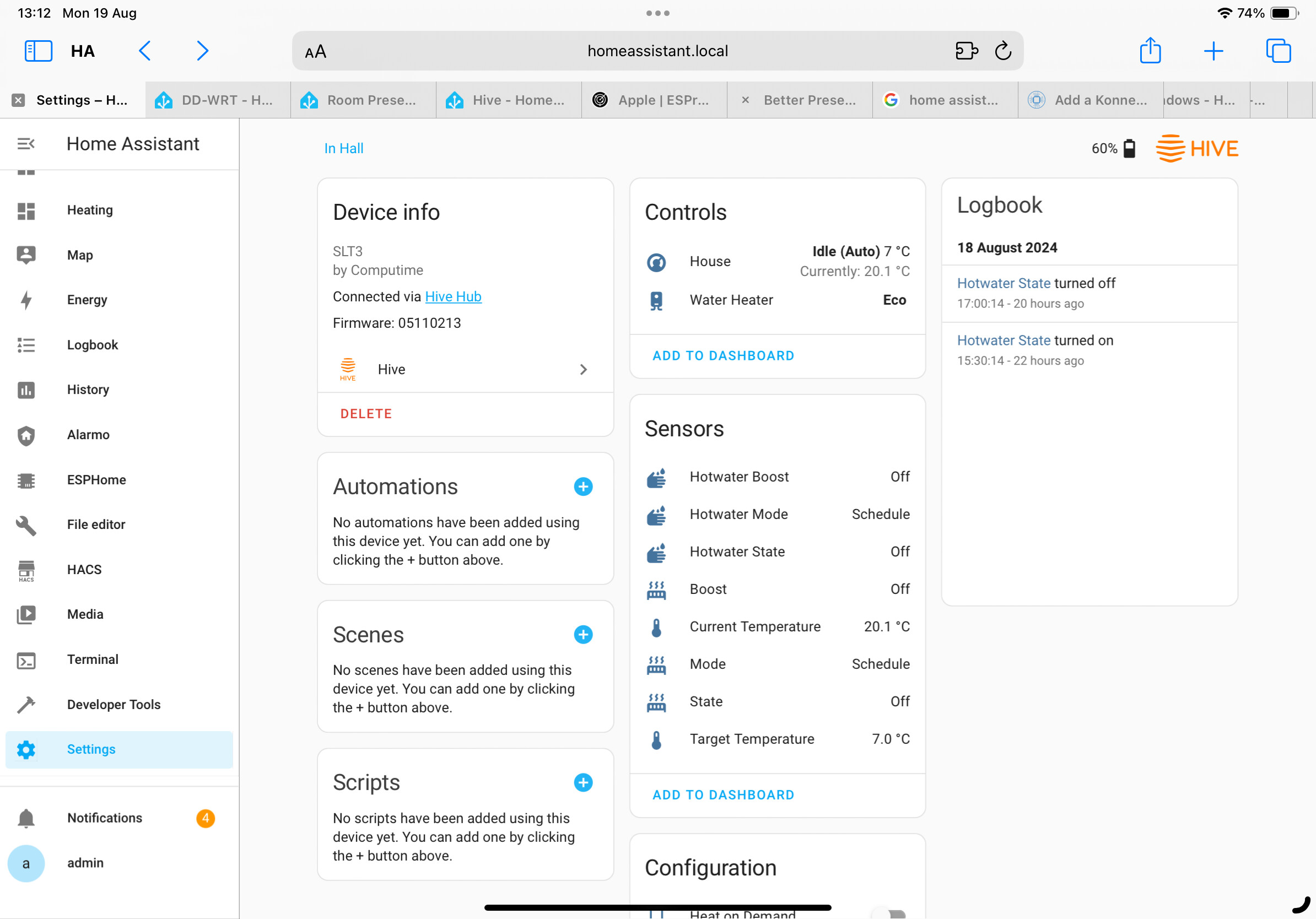

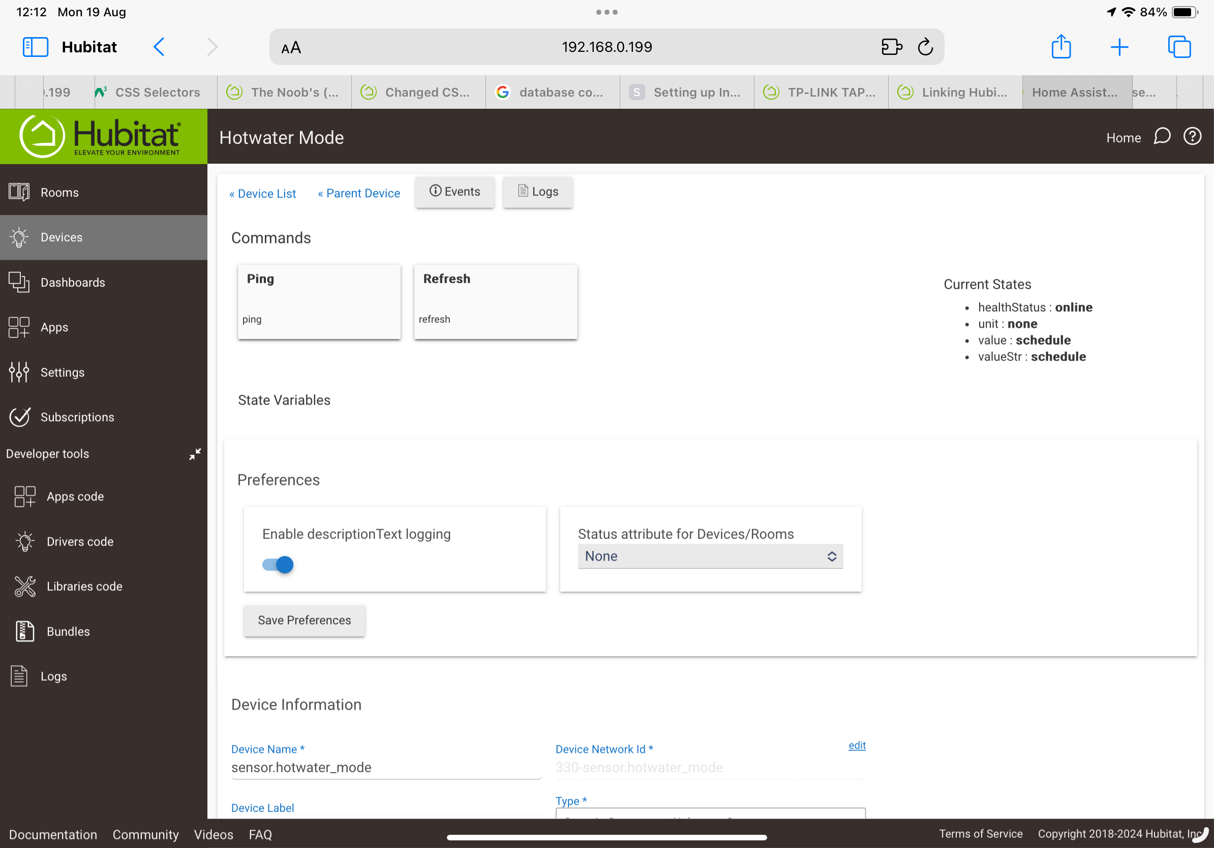

This is how the device looks in HE. I can add the device into WC, but don’t see any way to send a command to it. You can read the attributes e.g value str, this is the value I would like to change.

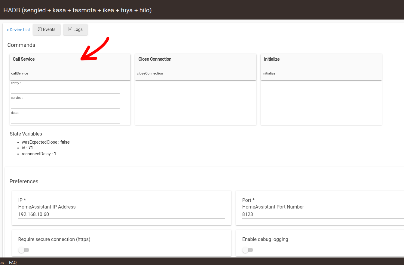

Wrong device. You will find the command on the parent device, not the component one.
Thanks, I think we’re getting there now.

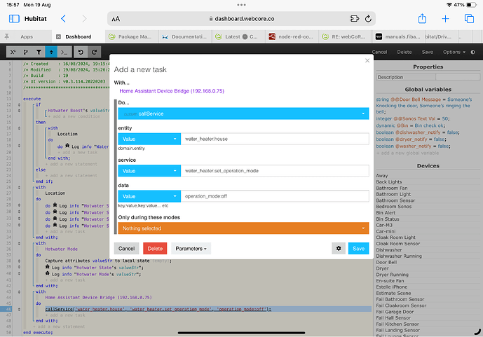

Using the parent (and adding the device to WC) I can make the service call. I’m just struggling with the parameters. I’m making the call, but it doesn’t do anything and I cant see any info in the logs.
On the attached screen shot, for device home, under controls, I want to change the “water heater” between echo/off/on. If you click it in HA, it gives the option to set these values
You have to find what exactly is the name of the entity. What I gave you was just a guess based on the picture you posted and the HA Hive documentation.
Go to your device properties in HA to find out.

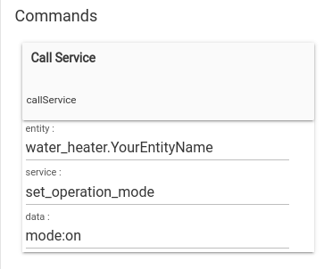

The call might look like that:

The only parameter I can be sure of is the entity name, as I’ve found that in HA (water_heater.house) I’m not sure of the values for service & data. Is there a way to find these? I admit, I’m a novice with HA!

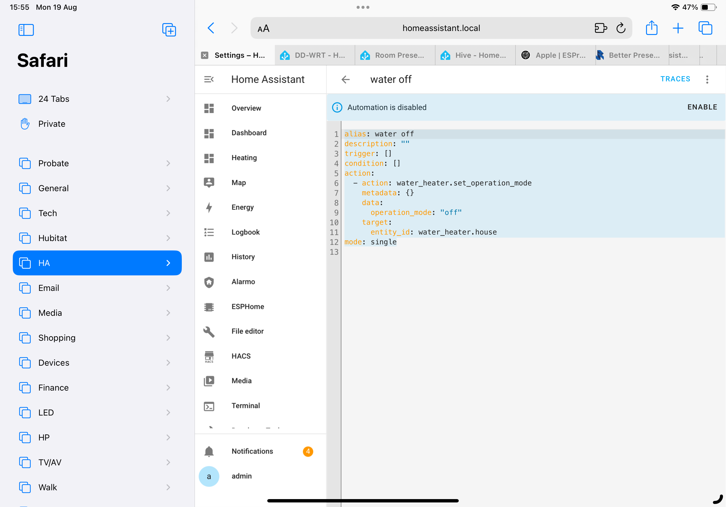

I created an automation in HA. This works when run in HA

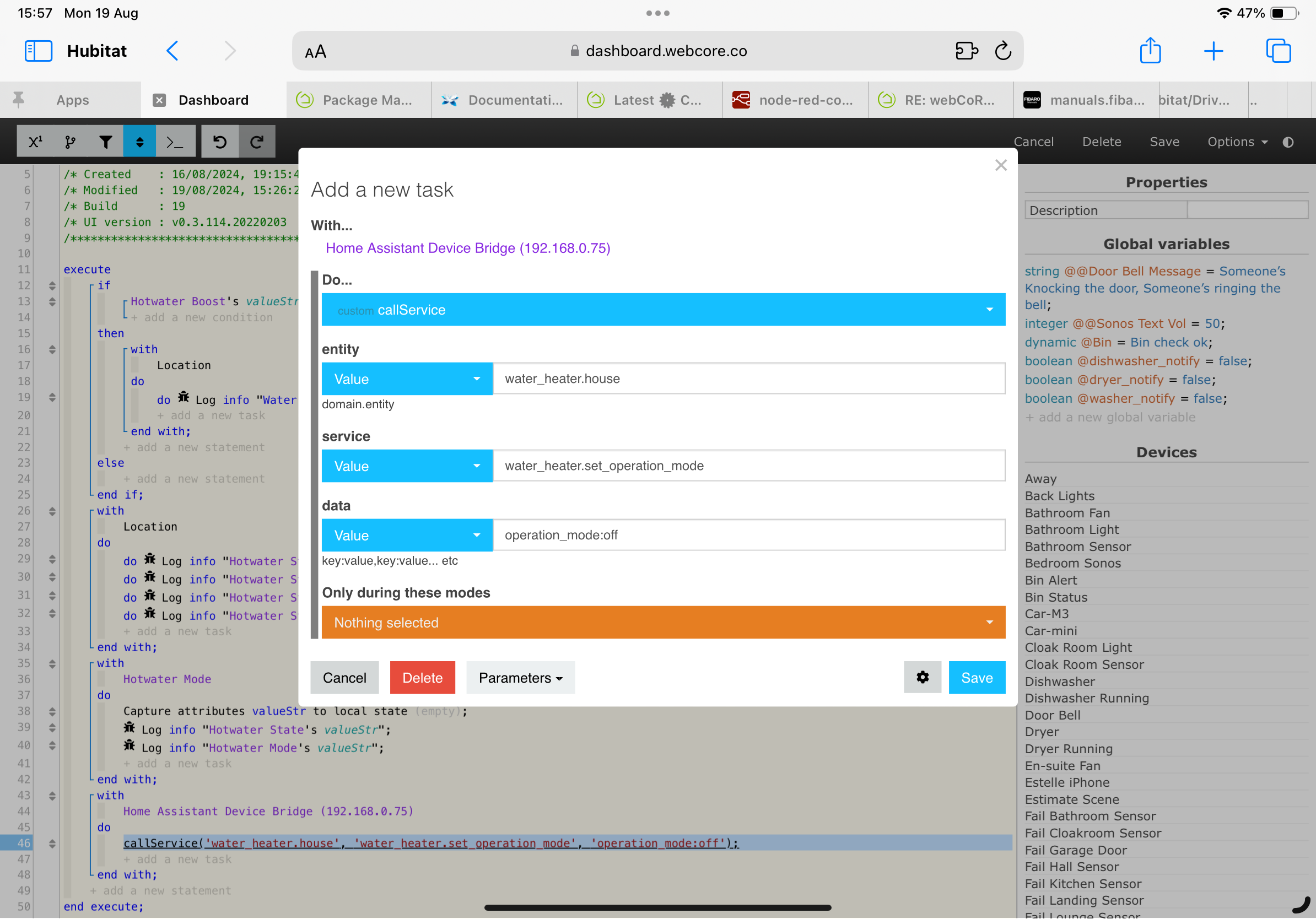

Then used this in WC and it doesn’t do anything?

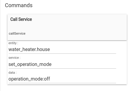

Try this:
Capture d’écran du 2024-08-19 12-28-55
Thats sorted it!
Many thanks for your help, I can now resurrect all my hive automations.

Set up a simple automation in HA for what you want to do. You dont need a trigger as you can run it manually. When it works edit it in the YAML view, you can then see the value for the parameters yiu need to supply in the service call.
