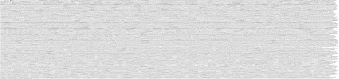

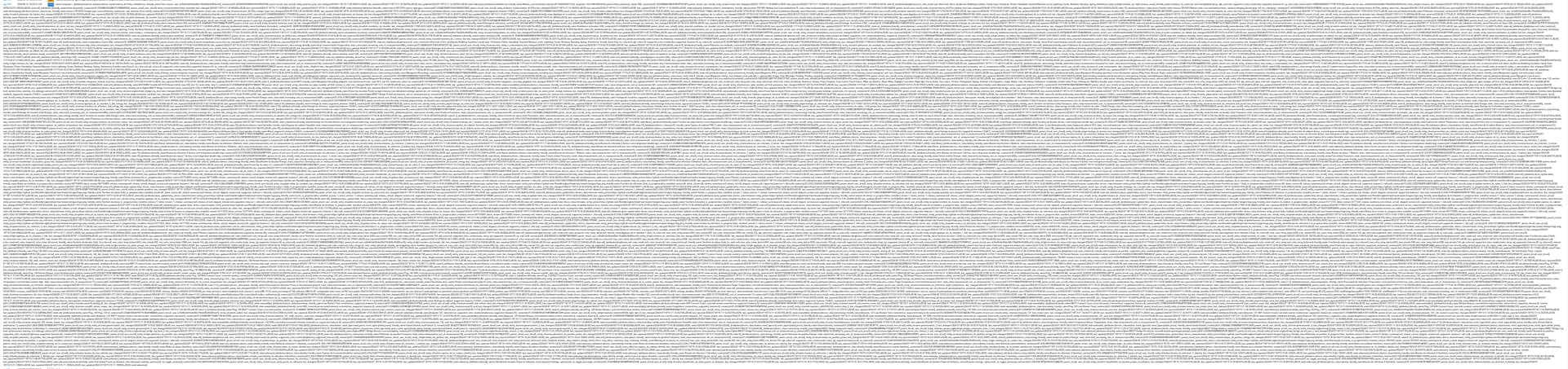

After that I get huge log line:
Websocker error sounds like a connection issue but Unifi doesn't show any problems on there. Is there a way to check the HA side and it's connection errors?
EDIT: and right after this message Hubitat says "Hub load is severe" "2.33". Now I'm going to do reboot and remove HADB. I'm not saying it is HADB which causes this but I definitely see that when I'm trying to do discovery on HADB I'm getting really slow response from Hubitat and things go bad.

OK I can reproduce.
The huge log line is expected since HADB has to query every entity on HA to create the complete list of devices to choose from.
The problem occurs when logging it. Disabling debug logging in the app should fix the endless spinning wheel.

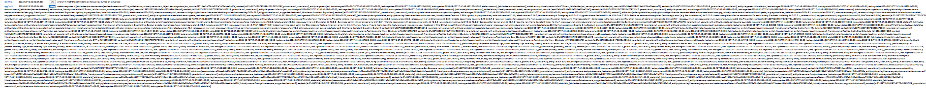

By the way this is what is logged on my system when I enable debug logging in the app ( it take for ever and generate warning from the hub):
When disabling debug, it is instantaneous.
I'm surprised the logging system is taxing the hub that much.
I was just trying to add some new devices yesterday and the let the Discover page spin for 30 minutes before I gave up. I was going to get back to looking at why tomorrow.
Just now I turned off debug logging and, as you noted, it is now instantaneous.
Yep but I turned debug on because I was trying to understand why it is not discovering devices. So I have same issue whether the debug is enabled or not.
That query makes hub go wild and I did not have any other option than reboot the hub.

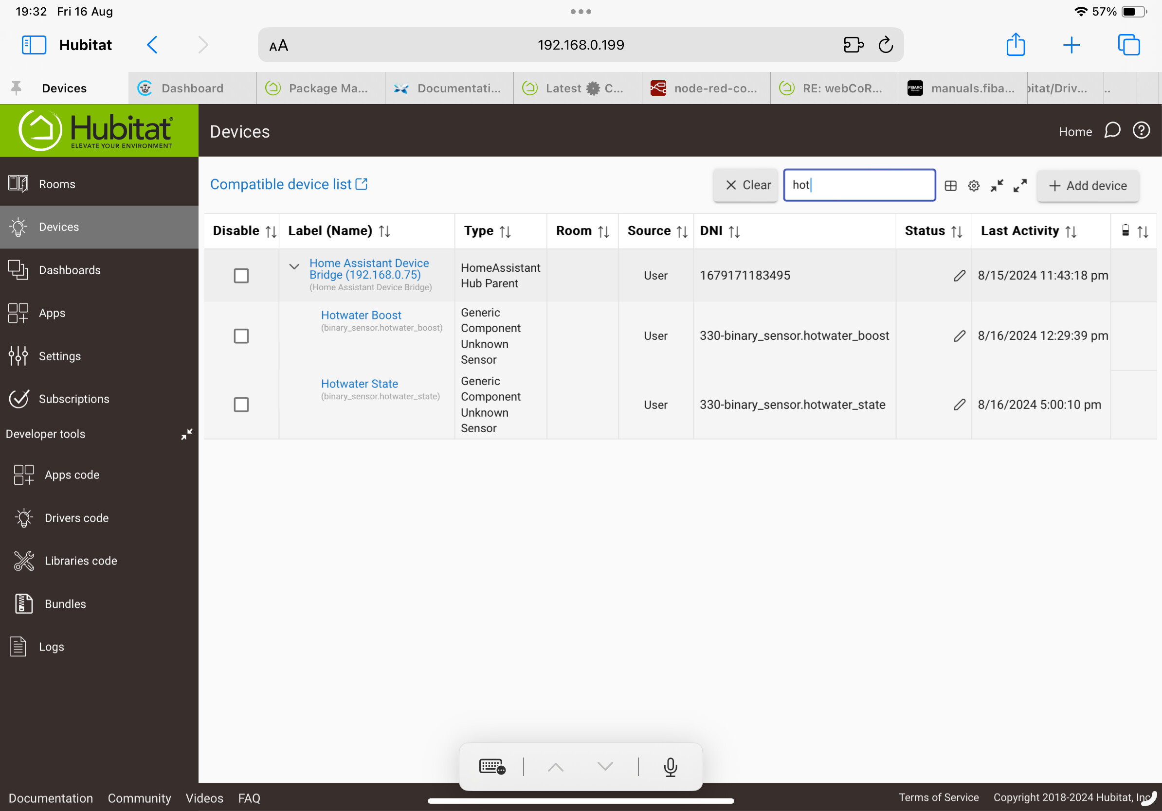

The Hive thermostat also handles hot water using a schedule (on/off/auto) or a manual boost. The following screenshot shows the devices available from HA. These attributes can be queried and used in webCore, but can not be changed or cause the triggering of an event. Would it be possible to make these fully operational?
These 2 entities are binary sensors, therefore they only report values and are not actionnable.
The thermostat itself should be a climate entity, which I don't see in your list. Make sure you select it in the HADB app and have it do something somehow (make it generate an event).

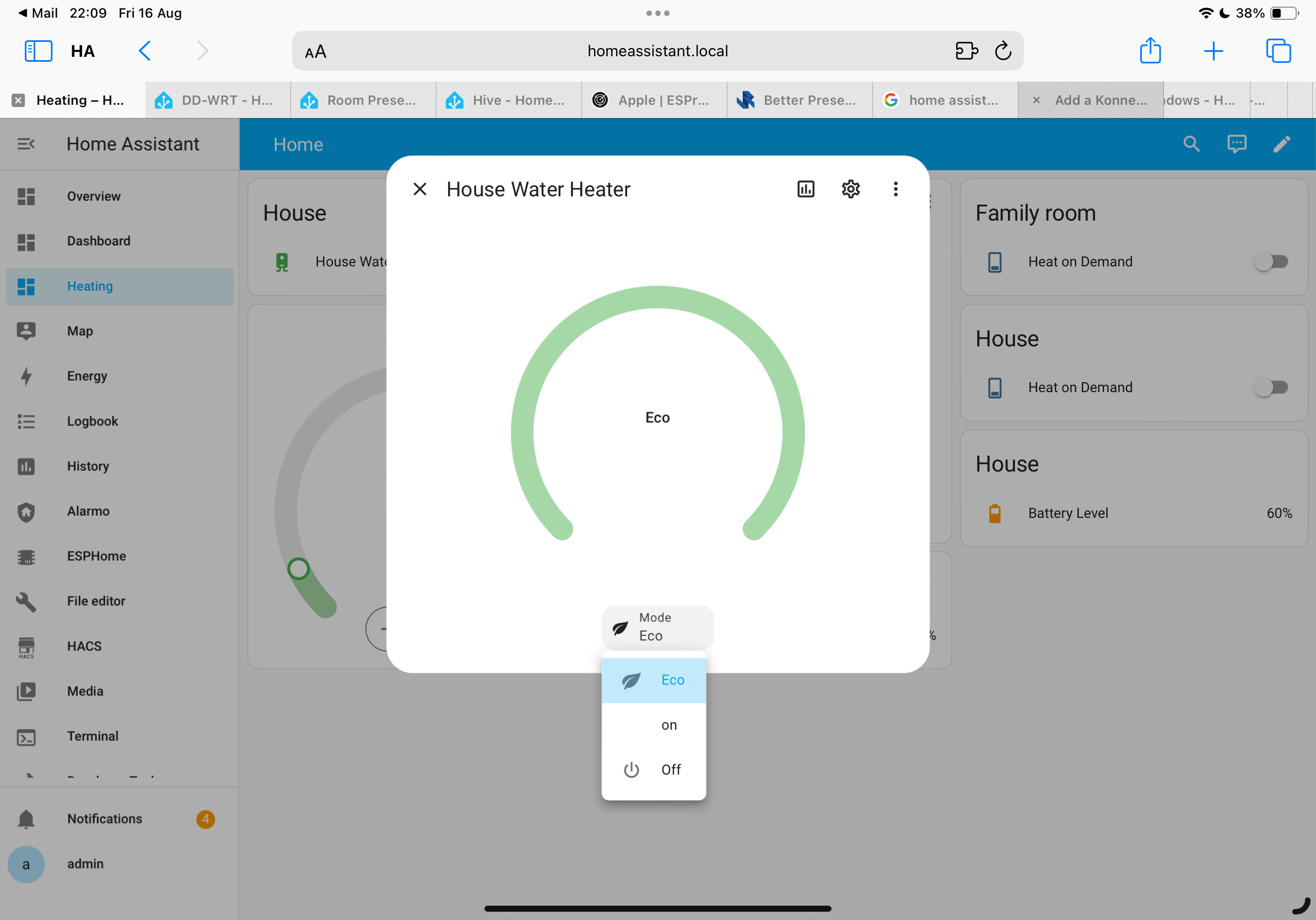

This screen shot shows the water heater in HA, it would be good to get this into HE. I’m not sure if the HA implementation can trigger the boost function, it may just display it, so guess nothing could be done with that?
HADB does not support water_heater entities because there is no such capability in HE.
May I suggest to use HADB custom call service to set your water heater options.

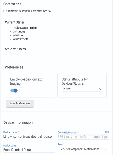

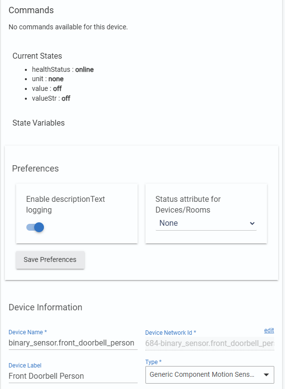

When I first imported the binary_sensor.front_doorbell_person entity, HADB assigned it a Generic Component Unknown Sensor and the value was turning on/off correctly. The device wasn't selectable in automations though, so I changed the driver to Generic Component Motion Sensor, but now the value isn't turning on/off anymore.
EDIT: I don't see the Generic Component Motion Sensor driver in my hub's Drivers Code section. I installed HADB for the first time today through HPM. Did it not import the motion sensor driver correctly perhaps?
It doesn't have any commands available to it either.
If HADB assigned the unknown sensor, it is because your entity did not report a supported device class. As you mention, the unknown device still report a value though (on/off). Changing the component driver to something else will indeed render the device unusable.
With the proper driver (the one assigned by HADB) you can select it for automation by choosing "custom attribute" as a trigger.
