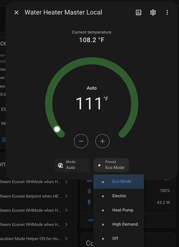

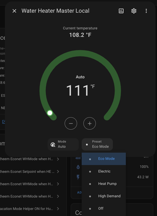

For my use-case, however, it doesn't work pragmatically. It seems that the way a water heater thermostat is implemented in HA is that the thermostat mode is just [Auto, Off] and then there is a different concept of a Preset that is where the real modes are defined. I'm using Maker API and HE-based actuators to do what I want, but it's not bidirectional -- it works, just not as elegant as HADB.
This picture should help:
  • caveat about the thermostat handling: in HA, the supported thermostat modes are Auto and Off; that's it. From Hubitat, I can see and control Auto and Off just fine. But I can also see and select Heat, Emergency Heat, and Cool as modes that don't exist in this entity in HA. FWIW in case it matters to you. No biggie to me.
These are internally added by the Hubitat thermostat capability and cannot be modify. All thermostat in hubitat show these modes regardless of them being present or not.
As for the presets, it might be possible to add them. I would need to see a log output from your device to make sure.

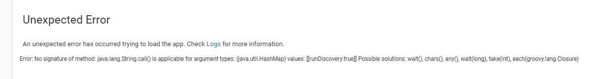

Hi all. I'm not able to "discover and select devices" anymore from HADB app's page. It just spins the green hubitat circle in the hubitat page and nothing ever happens.
Log says:
Then I refresh app's page and it says:
And after that one more error line:
App version is 2.6:
  • Version Control:
  • 2.3 2024-03-26 Yves Mercier Add support for buttons
  • 2.5 2024-05-08 Yves Mercier Add support for valves
    *** 2.6 2024-05-31 Yves Mercier Add support for humidifier**
I'm unable to reproduce.
Perhaps your App code was corrupted somehow. Try to do a repair.
Removed app and installed it again. Now I'm able to discover devices.
My original problem did not yet disappear though.

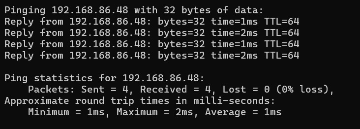

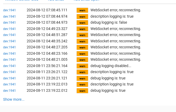

Why do I get these log lines:
"Websocket error, reconnecting". ?
HA is connected to LAN and connection is steady. There is no packet loss and running ping all day long shows:
According to these logs, it looks like after a few failed attempt the driver was able to connect and stay connected for 2+ hours until it was manually updated.
Yeah it did that daily until yesteday when I removed app and installed it again. Something was bad and now it seems to be working normally.
