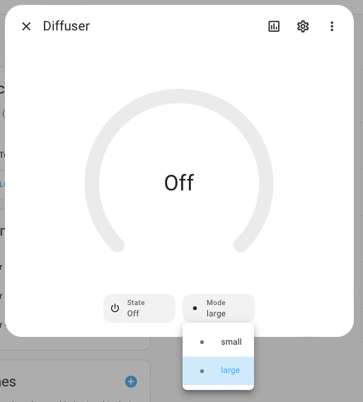

I have a Tuya diffuser. I selected it from the available devices in HADB but it is not showing up as a device in Hubitat.
The device has a light switch, which does work, and a diffuser main control switch, which doesn't show. Thanks for any help on this.
Device are only created when a change in status occurs: Toggle the relevant device.
You would need to provide more info on the device. Especially the entity ID.
Thanks, I actually remembered to toggle the device several times.
The entity id is humidifier.diffuser
It has an on/off and a mode with small/large. That is essentially low/high setting. Thanks.
HADB does not currently support humidifier entities and there is no equivalent capability in HE.
I see a problem with setting a dynamic constrain on a hypothetical "setHumidifierMode" command in a generic component. Perhaps a workaround could be implemented but it would require some test runs on your parts.
Let me know if it is worth your while.
Happy to test it. Really only need to turn the diffuser on and off. Setting level between low and high is icing on the cake.

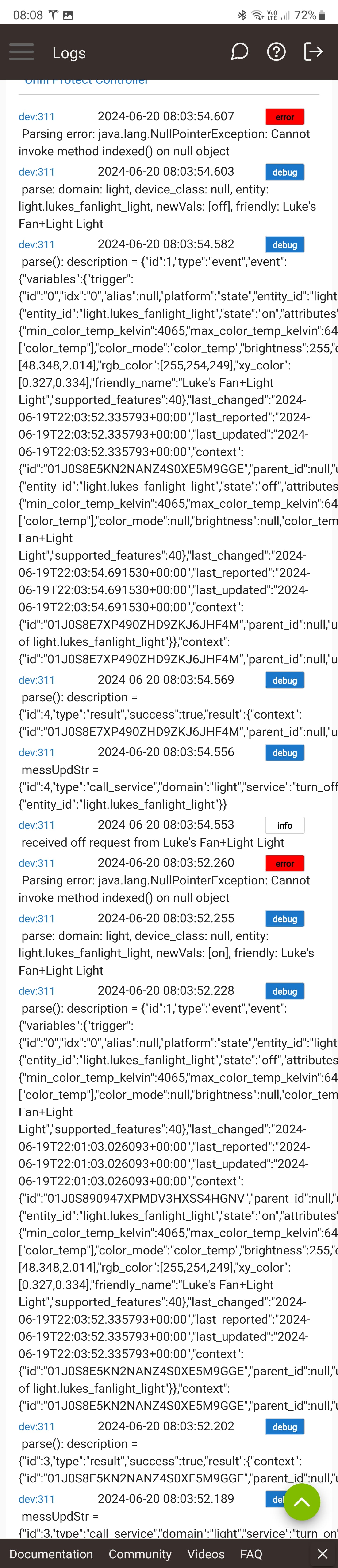

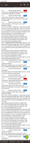

On the latest HA , HE ( 2.3.9.153) and HADB I have an issue where a light that is part of a ESPHome fan/light combo no longer shows any state but 'on'.
The device will turn on and off from anywhere, ha, he or physical, but the state in HE is always on, which breaks automations as it's often skipped as it's 'already on'.
It's only started happening in the last week or so.
I am getting these java errors in the logs for the HADB parent device.
There was an oversight in the last update that cause this error. It was corrected on github.
