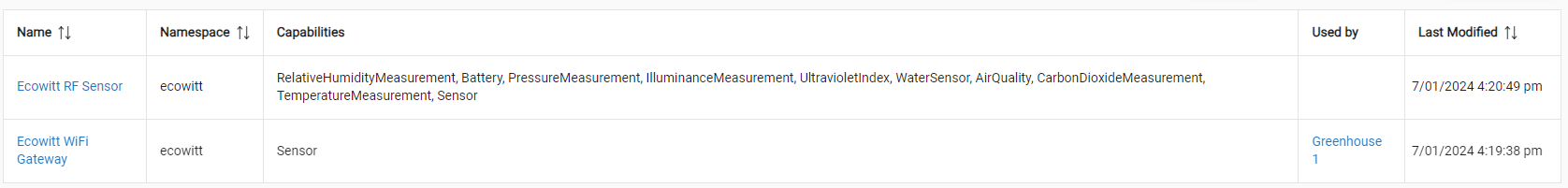

Yes, there are only four attributes that show because they are only ones that report any value, but in the device properties itself for any integration or other app that is reading all of the possible capabilities and attributes of the device, they are seeing all of them, and in some cases where those attributes are null, then it’s reporting them as being a zero value in the case of air quality zero means excellent.
My gut-feel would be it would be possible, but could be a bit of a task to accomplish, without having really dug into the code to find out.
I certainly get the desire to do it, I can understand how presenting devices more accurately across the system and externally would be a better setup.

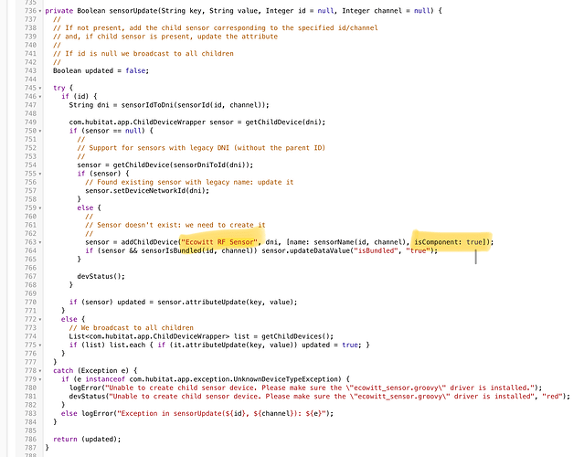

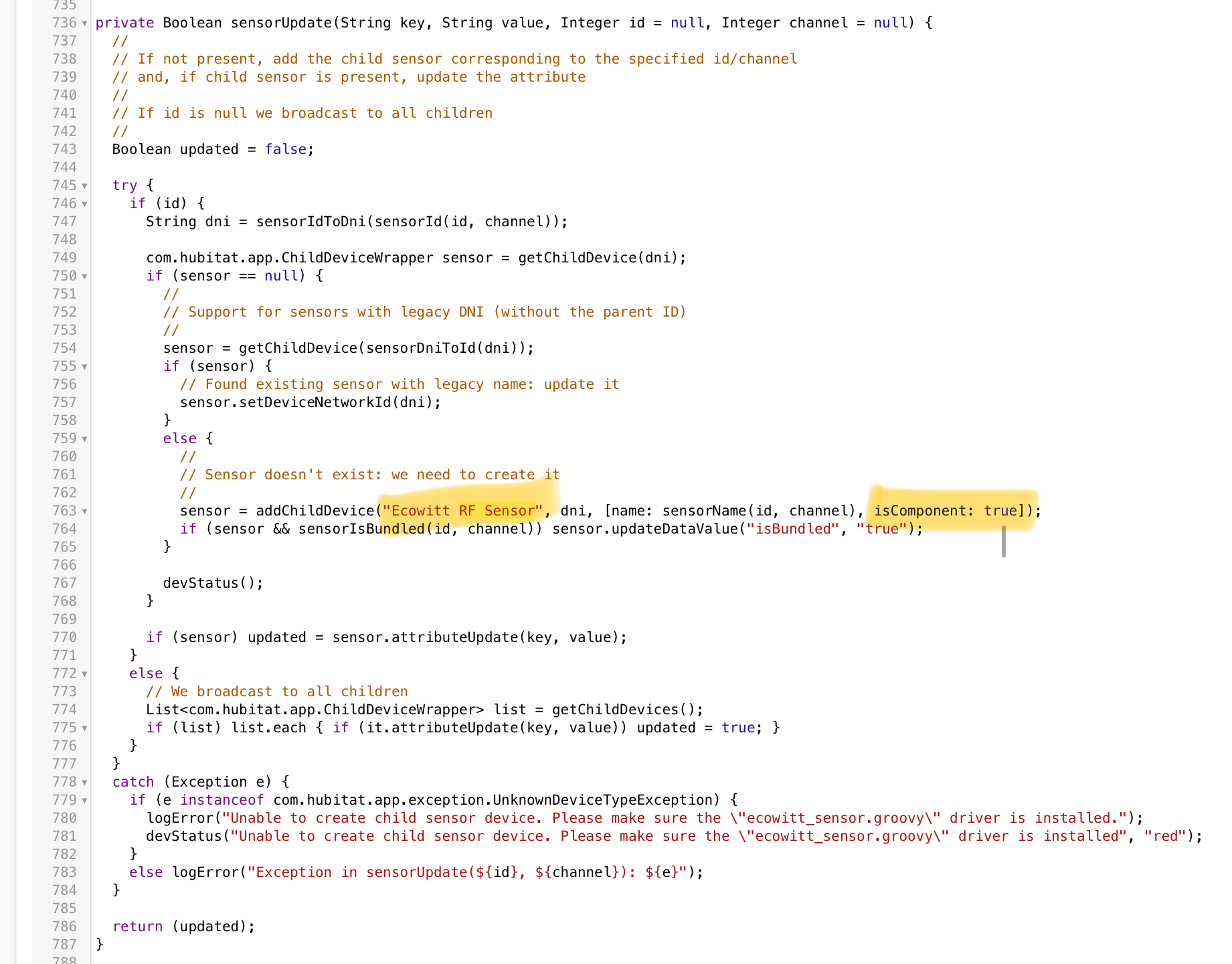

I believe the driver will be locked because it is a child / component device (can't remember which it is or which would cause it). So effectively it is set by the parent device that creates it, rather than the user having the option to change it.
There is a mixture of issues (I think) that can come about from the current setup. The device/driver having the capabilities at all can mean devices appear for selection in HE regardless of the attributes that are populated, so reducing the attributes listed / populated is not the only issue or solution.
I was thinking this too, but I have other components/child devices that I can change the drivers, such as my Tessie for Tesla app. I did actually switch the isComponent value to false on one of the child devices, and that still didn’t allow me to swap it out, so there must be something else on the back end that is making it read only
Yeah, I'm pretty sure there is something in the way the device is created / setup that stops it, just can't remember what.
In general, in terms of what you requested, I'd be happy to consider it, just not sure when I would get a chance to look at it. Happy for you or anyone else to play around with it.

It’s here on row 763 in the parent driver where the child device driver is specified upon creation. It also specifies “isComponent” here, so that’s why I was thinking changing that value would make it editable. My thought is that this section would need to be modified with the ability to assign different child drivers based on type of component being added, but that would take some work. I would be happy to be able to just swap out the standard child device driver for my own, so I’ll keep fiddling around to see if I can make it editable. (I’m hip but not groovy, so my chances of figuring out are fairly slim.) If you get time to look at it further, great, thanks, but it’s really not a critical issue.
Summary
Yeah, that's all that looks different compared to the Logitech Harmony driver I use, which produces child devices where the driver can be adjusted. Hmmm....
Cheers, I’ll take a look.

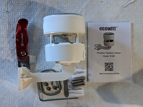

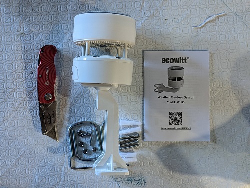

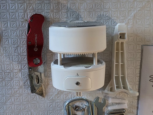

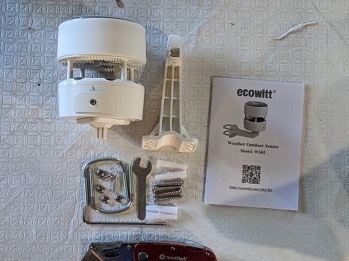

Smaller than I thought it would be.
Now for the fun part, mounting it somewhere. :roll_eyes:
WS85 pics
1
2
3
4

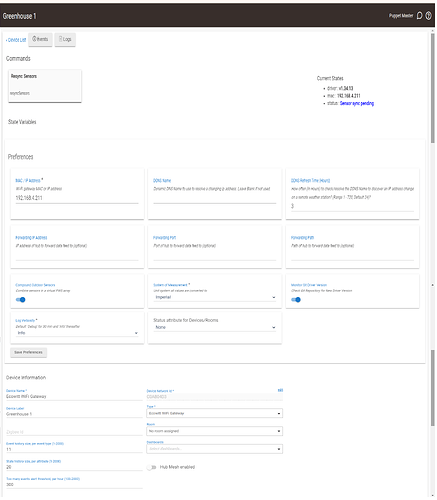

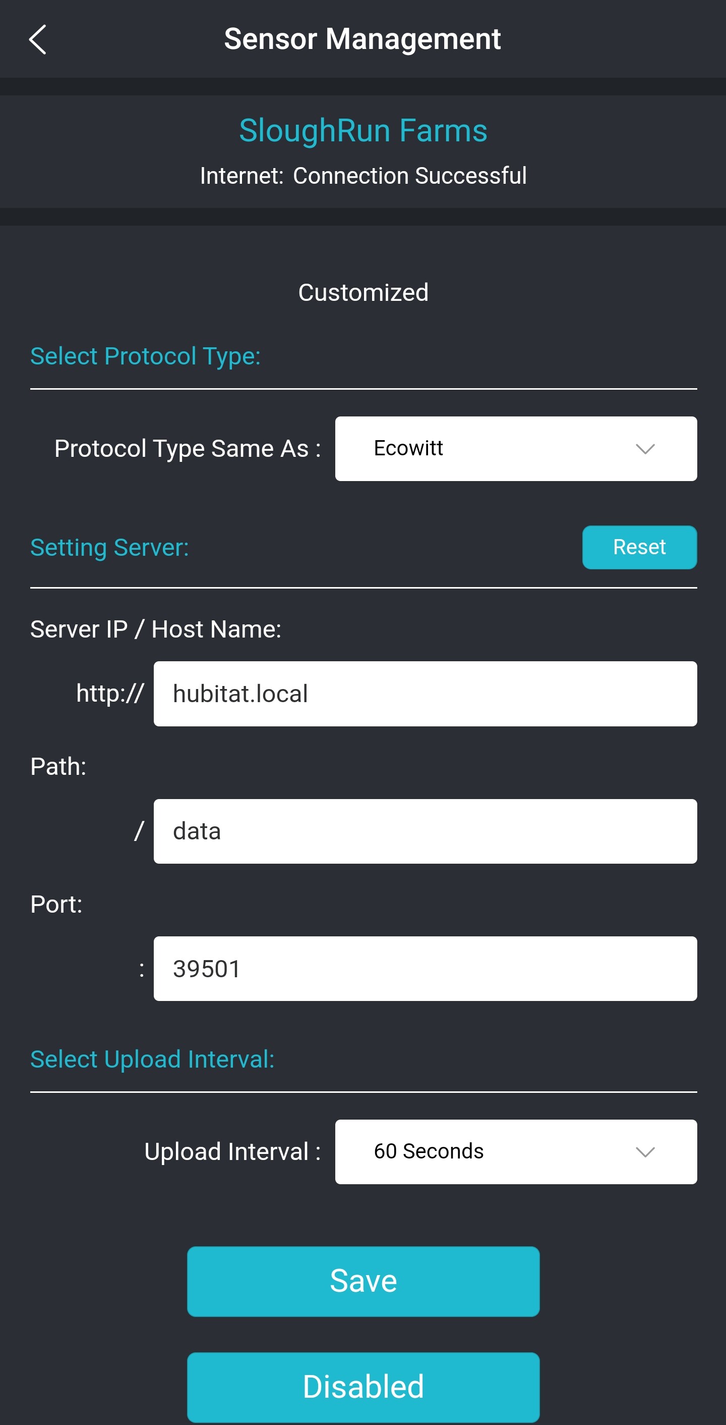

A little stuck here - Following sburke871 instructions found here GitHub - sburke781/ecowitt: Hubitat Ecowitt Gateway Integration
Installed the app. It found the gateway with no issue. Added 4 soil sensors. (didn't need to hit the add device button; it automatically added them.
Updated app to version V1.3.1
Found the page to register devices under Device ID. All 4 sensors show battery and signal levels.
I set up the custom data feed to HE but none of the devices are showing up in HE after the gateway updates.
The device status shows sensor sync pending.
Tried using the MAC and IP address.
What did I miss?
need to put in server ip and make sure to assign a fixed ip to your hub via dhcp so it doesnt change.
it should be a local ip normally 192.x.x.x.
also did you install the drivers in hubitat.. you first install them in driver code either manually or through package manager.. then you still must add the base hubitat device through add device.. and configure it.. before it will pull in the children.. show us the base device configuration page in hubitat.
looks to me like you are missing these steps as you dont mention them.
I suspect you may have got the drivers installed fine if you are seeing the sensors sync pending, but doesn't hurt to confirm a few details like @kahn-hubitat suggested. Some screenshots of the device details page would help.
In addition to using the IP instead of hubitat.local, if only temporarily, I would also suggest keeping an eye on the Live Logs page in HE to see if you see any logs / errors appearing, including hub-level logs (not just those linked to the gateway device). This may reveal if the data feed is getting through to the HE hub but not finding it's way to the gateway device.
Hopefully it is a simple as an IP / config issue.

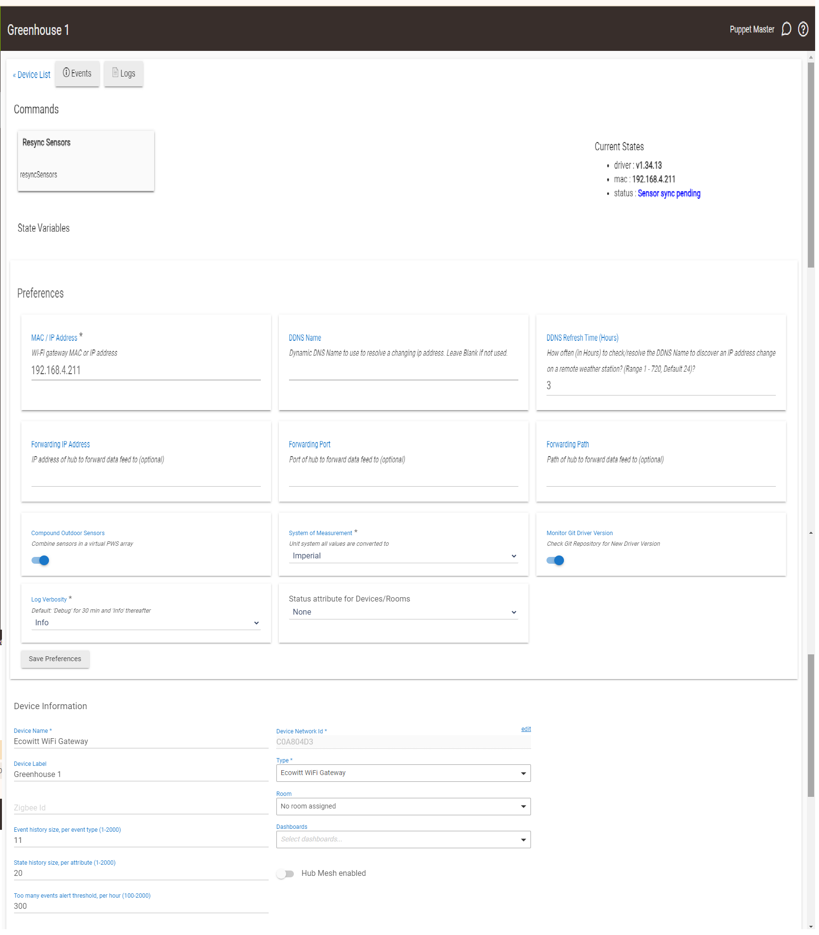

Added the drivers
Tried both MAC and IP on the device page
Changed hostname to IP
Not see anything in any of the logs
