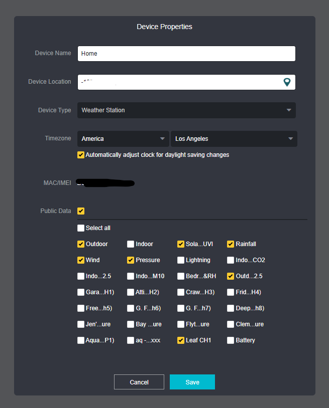

It's actually worth mentioning that people should check their Ecowitt dashboards because as I recall, it defaults to sharing all your sensors. At least it used to, I found my account and a friend's that way when I first started using Ecowitt stuff. So if you do not want your "Crawlspace Playroom," "Justice Shed," and "Private Time Area" temperatures shared with the world, check your gateway settings under Menu/Devices/Pencil icon. There, you can select which sensors are public.
I am OK sharing the outside sensors, YMMV.
I think it still does by default. Every time I add a new device, I have to go in and block it. No one outside this house needs to know what the temperature in my attic or bedroom is or that I haven't watered the flower pots on the porch in a few days (I use 20% is the threshold to water). I share the rest of the outdoor stuff so mine (and a fee neighbors) Rachio irrigation controllers can get a local reading to decide to skip watering or not.

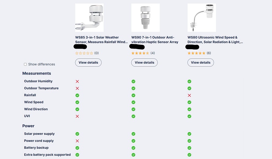

Anyone have any feedback on the WS85 sensor assembly?
I don't really care about the missing temp/humidity since I have that already, plus the temp would be influenced by the exposed mounting position.
But it would be nice to have a local UVI. :thinking:
The Ecowitt system knows if you have a dedicated movable outdoor temp/RH sensor and it will prioritize that as the authoritative reading -- so you can find better placement.
The haptic rainfall sensors are mediocre from what I have read.

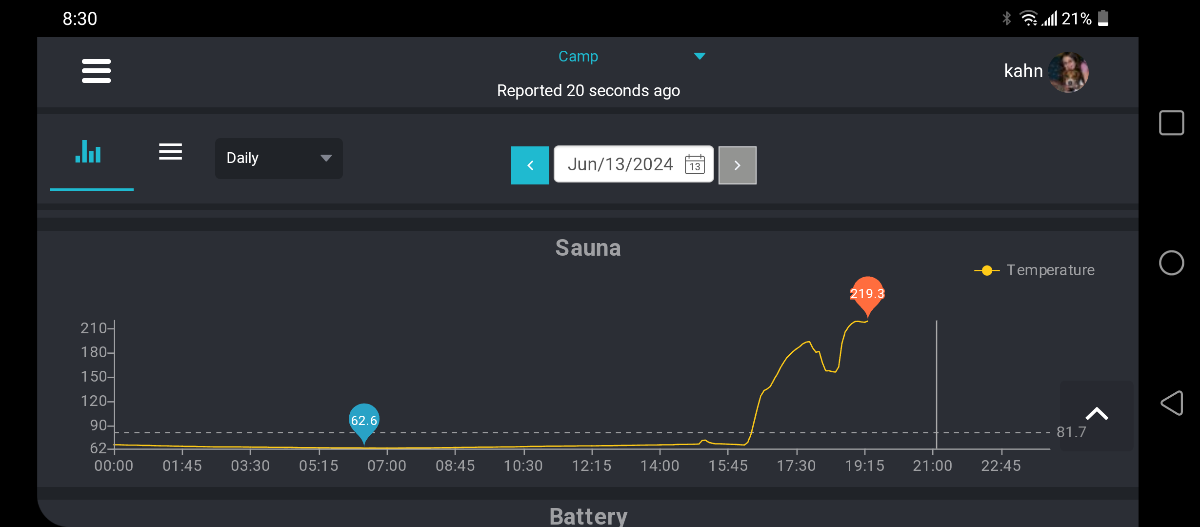

First test of new sensor... working well
Happy F'Day to me. :grinning:

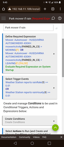

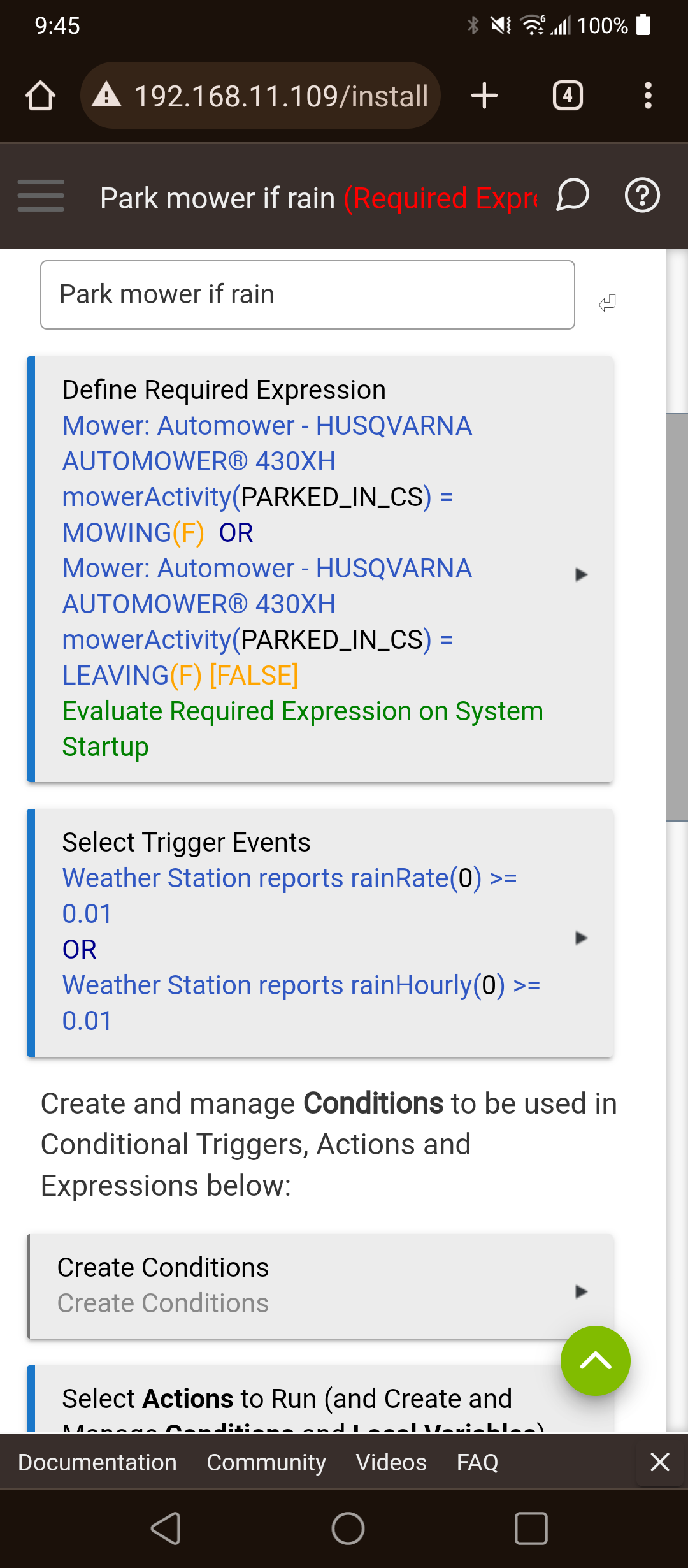

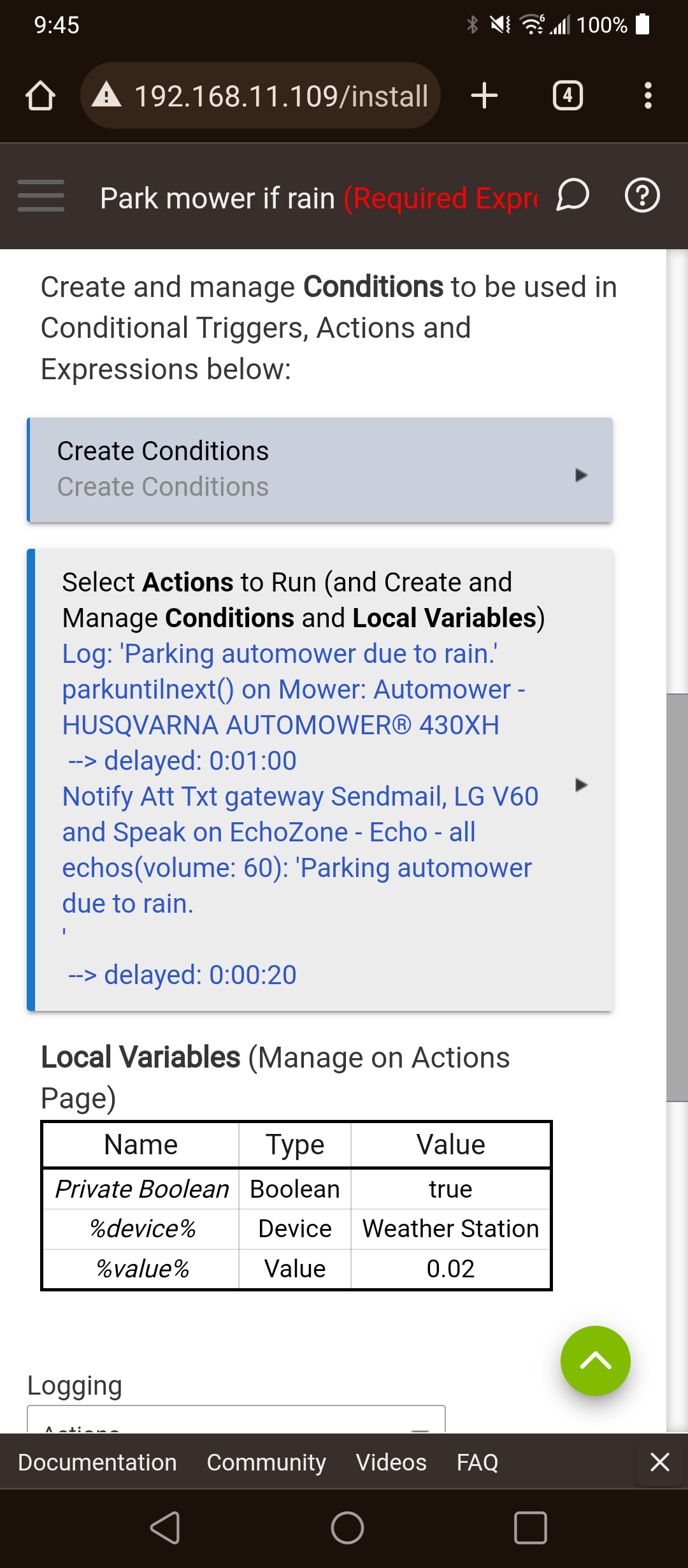

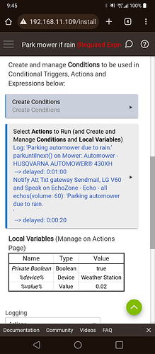

We are back in the u.p. of mich and my rain rule actually kicked in and sent the automower home. Gotta love automation.
So it's not raining? Or you would prefer it to be mowing?
I know I would like an automated mower on the front of my property, but know it is a steep bog of a thing.... So am envious of those who can utilise automated setups...

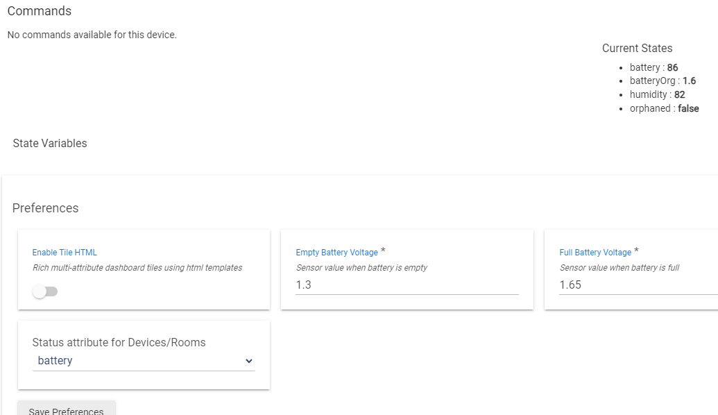

@sburke781 - For consideration - Would it be possible to modify this setup to have different child device drivers? Right now, it looks like all of the children use the same device driver, which adds many more capabilities and attributes than each may actually have.
For instance, I have a bunch of garden soil moisture sensors, and they show up with illuminance, air quality, water, etc., but they actually only have humidity and battery. This was creating problems for me in Homebridge, because I couldn’t filter out AirQuality (custom capability for Homebridge), and it was being sent to Homekit. (Homebridge Hubitat v2 has some issues with custom attribute filtering, so if it were working, this wouldn’t be an issue, but still there are other use cases where having all of these extra capabilities and attributes could cause an issue or result in unwanted “junk.”
To fix this for my own use case:
EDIT: I jumped the gun on my below statement. After I created a new version of the driver, I was unable to swap it out in the child/component devices, because the field is locked. I’ll need to figure out how to unlock that. In the meantime, I commented out Air Quality Index components in the default “Ecowitt RF Sensor” device driver since they were the only components that I couldn’t filter out of Homebridge, and none of my devices use it, so it’s not needed globally.
created a copy of the child device driver for my soil moisture sensors and commented out the capabilities and attributes that aren’t needed, but that means I’m not on the production version of the driver, which I can deal with, but would be nice not to have to use this custom workaround.
Thanks for the consideration!
That's odd. I have 5 soil sensors each with 4 states.
Yeah, this throws a lot of un-needed attributes for device.
Alternatively to separate drivers, a multi-selection drop down to pick the attributes you want. Maybe make all checked by default to make backwards compatible.
