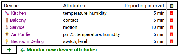

What I would love to see (here come requirements, we're all experts at this :slight_smile:):
  1. One app instance for all devices/attributes. Something along these lines:
    I would also remove the reporting interval (besides the number of datapoints), and use some predefined values. As a user, I only care about what attributes I want to have graphs for.
  2. Automatic CSV file naming, based on device id and probably accuracy (day, month, year).
  3. I see that the app stores the attribute values in the app state. Can't we just collect the attributes' currentValue when updating the file?
  4. Automatic crunch / roll-up aggregations with lesser and lesser accuracy. Don't really know how we aggregate attribute values like motion:active, switch:off, etc. This is fun!
Again, great work... as always!
  1. I suck at UI :man_shrugging: but could build a parent app over this to provide a unified experience.
  2. I could generate it easy enough, but by allowing you to name it you could restart the data collection without over writing the previous data.
  3. Design decision that allows me to poll the values at file creation and then use subscriptions to keep the current value updated - should keep the impact to the hub to a minimum.
  4. Max/Min/Avg for numeric values are actually on my drawing board just didn't have the time to implement in my self imposed deadline yesterday.
Check out my SmartStart Manager app I think that design might work here also. I have a list view page similar to the mock up from @dandanache and when you click the name on the left side it goes to the edit page for that one entry. Edit page could be the UI that @thebearmay already built.
