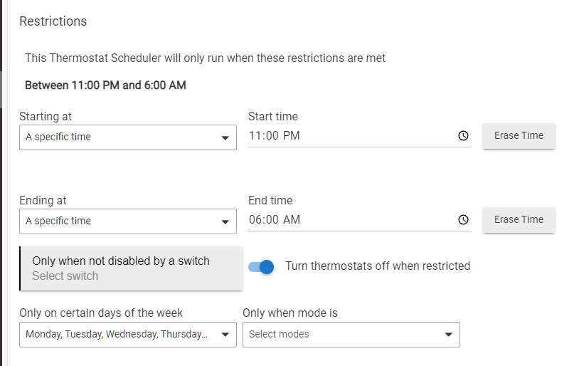

In this old thread asking for the same thing, it is mentioned that this can be accomplished with restriction settings in the controller:
Looking at the restriction settings, the wording is a bit confusing (seems like it's saying the controller is restricted to only running at these times (is the mentions of the scheduler instead of controller a typo?) but then there is an option to turn off the thermostat when it's restricted, which is the opposite of running.
If I enable "Turn thermostats off when restricted", then is the controller only ON during the specified starting/ending times and OFF all other times? That would do what I want. But if it's the opposite, then it wouldn't work for me since I have separate schedules for weekend and weekday.
Yes.

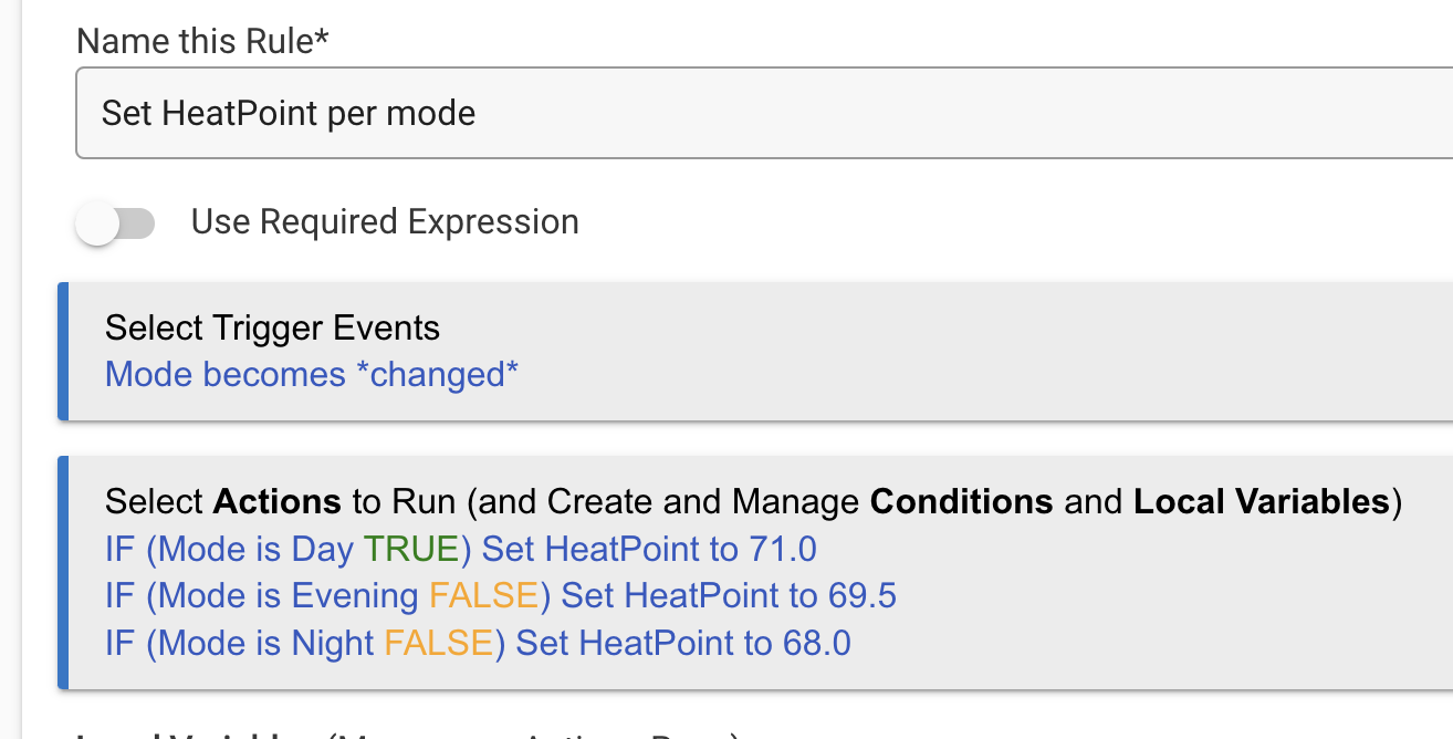

Back to what @csteele had to say above. You could do this much easier than using Thermostat Scheduler, using two rules and a Hub Variable. The Hub Variable would be used to hold the desired setpoint, and one rule would set that on a per mode basis, like this:
This rule uses Simple Conditional Actions to set the variable to the desired setpoint for that mode.
Then the second rule would be the one I showed earlier, but using that variable for the setpoint:
