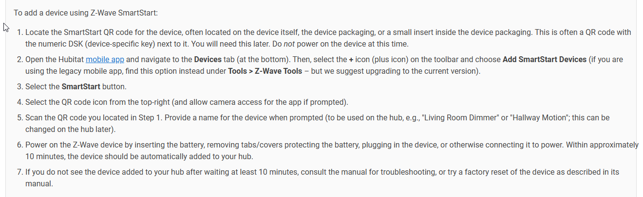

Also to make pairing easier in the future just use SmartStart
Add Device | Hubitat Documentation
AND [APP] SmartStart Manager for Z-Wave (Long Range support) - #2 by jtp10181
Under the Z-wave LR instructions (works for any modern ZW device even if not LR)
