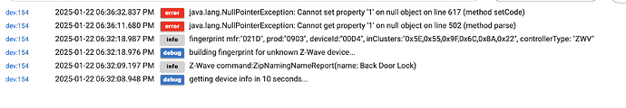

I've tried using it with the Generic driver, and the driver is throwing internal errors:
java.lang.NullPointerException: Cannot set property '1' on null object on line 617 (method setCode)
java.lang.NullPointerException: Cannot get property '1' on null object on line 502 (method parse)
Turn on debug logging and reproduce the errors. Debug logs should show what message it is trying to parse. Post a screenshot of the logs please.
Also what hub model and what platform/firmware version?
Hi, @jtp10181. I'm running a C-8 Pro with the latest firmware (150), which I updated today before adding the lock. I added it as an LR node using SmartStart.

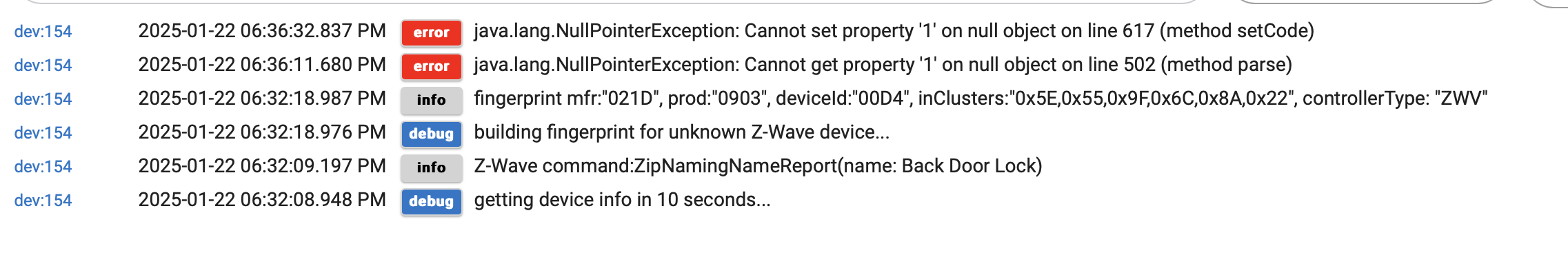

The debug logging was actually on, but the logs are pretty sparse from the built-in Generic Z-Wave Lock driver.
The above are the only long entries from the entire time the lock has been paired to the hub, even though I've been locking/unlocking manually from the inside, with the user codes from the outside, and from Hubitat.
FWIW, the lock responds to lock/unlock commands from the hub, and somehow it successfully handled a single status update from 'unknown' to 'locked', but it no longer updates its status at all, has been unable to fetch any codes above 99 (i.e., last code fetched is stuck at 99 after multiple tries, even though the device details page correctly reflects the lock's tech spec of max codes 250), and is unable to set any codes or actually store in state any codes fetched from the device.

Hi, @jtp10181. Okay, I’ve gone through the above, and some notes:
- I’ve been unable to get any additional logs using either your driver (which is great to know about — thanks!) or the Generic Z-Wave Lock driver. All I have are exactly the logs I excerpted/screenshotted above, even after restarting the hub, power cycling the lock, etc., and then un/locking manually and with code.
- The lock/unlock commands from the hub work fine, and the Generic Z-Wave Lock driver must be following those with a poll to the device to pull its status, as the status updates correctly a couple seconds after sending lock/unlock commands from Hubitat.
- The lock/unlock status never updates after un/locking manually or with the code, however, so assuming the device is trying to push status updates to the hub, the driver must just not be handling the device’s pushed events correctly (?)
- If I Refresh, the status changes from un/locked to unknown, so the hub is getting some events but not handling them correctly? Or is the generic driver setting its internal status to unknown before starting the refresh?
- The code fetch nevertheless completed (250 codes fetched) earlier when I wasn’t paying attention (probably after I restarted the hub).
- I’ve been able to add/remove codes from Hubitat but not reliably. I succeeded in adding two codes initially, wasn’t able to add a third (device page stuck on the “requested change”), was able to delete one of the two codes, but now can’t add the same second code back (stuck on requested change).
